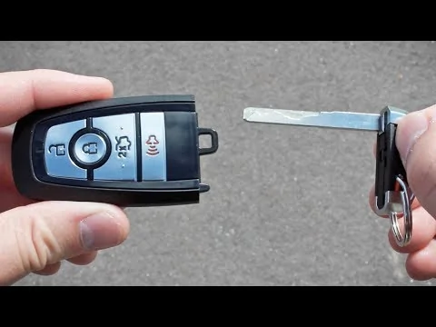

My fob looks a little different. Hers even differenter...
I'll see if I can snag a pic.
Nope my fob has no key in it. Wife's does. But I checked in the Key Vault where we keep out spare keys and it came with a stand alone key that isn't part of a fob.
