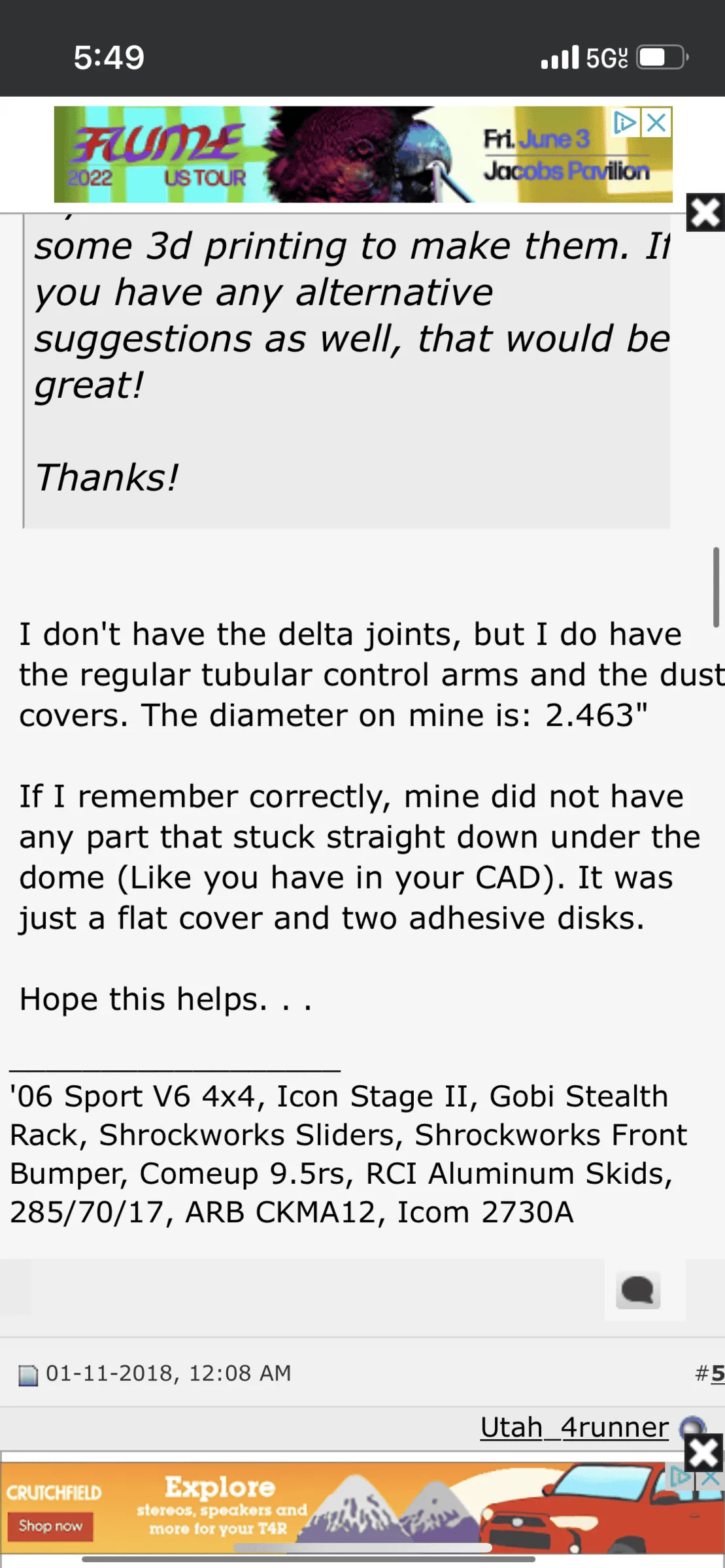

Does anyone know of a 3D printed UCA cap? The ones sold by Icon and other brands are a little ridiculous.
found this on another forum.
