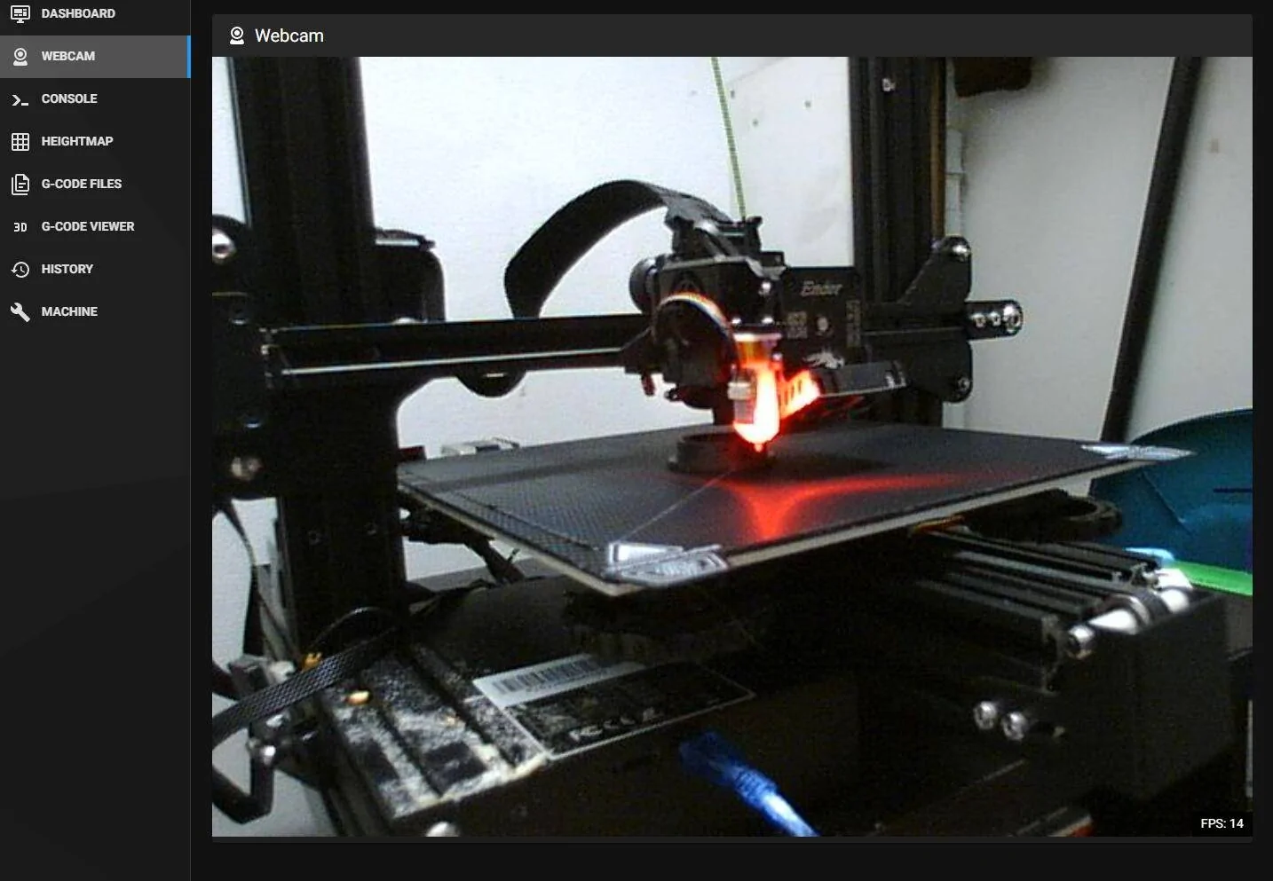

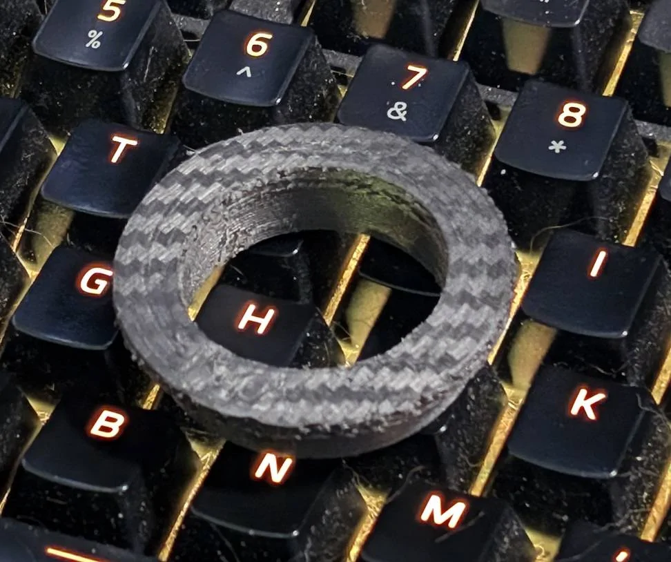

Printing my ignition bezel with nylon carbon (PA-CF).
Printed, not the best first layer, I'm still working on that with this filament, but the CF pattern of the plate did transfer in some.

Is that an Ender 3? Are you using a hardened steel or stainless nozzle? Carbon fiber filament is murder on brass nozzles.

It started as an Ender 3 Pro.... has BTT SKR Mini E3 V3.0 MCU w/klipper FW, RPi 400 CPU running Mainsail/crowsnest/etc, Sprite Extruder Pro with 0.6mm Hardened Steel and the BLTouch.
I will say that Klipper was the best update I've done to this system, using the Wifi in the RPi 400 to connect load files, print and monitor has been so much nicer than running a USB to the printer as I did when I had the old MCU (BTT SKR Mini E3 V2.0) and the BTT TFT35-E3 V3.0 display. Which at the time was a big updated over stock MCU (Creality3D V1.1.4)/display
