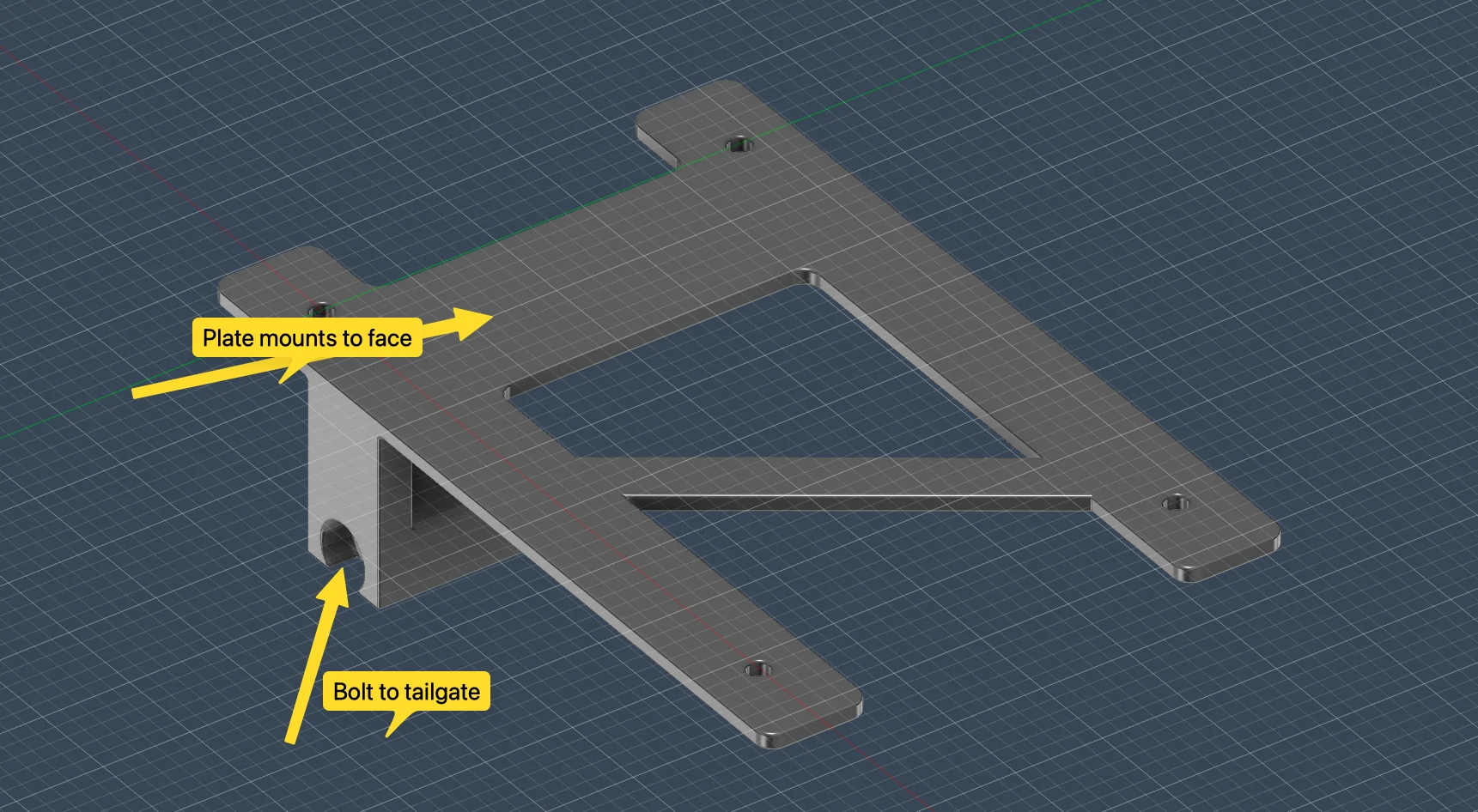

I have really started to learn CAD. Its not intuitive for me, so its taking a lot of work. After I modified my bumper, my license plate no longer fits in the OE location. I have been working on a new design to mount it to the tailgate. There is a bolt on the bottom.
This is what I have so far. I am test printing my 3rd piece to make sure it fits. If this works, I will print the whole thing in PETG before jumping over to ASA. It will be printed at 100% infill, so it will be one solid piece.

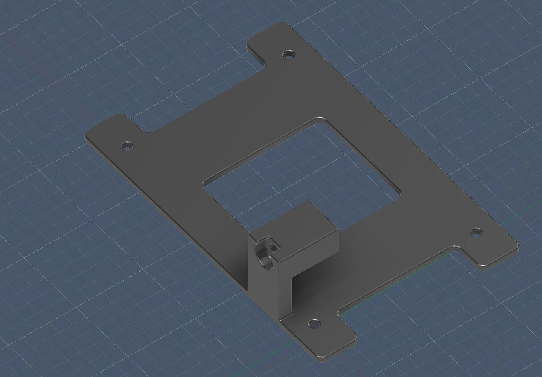

Final design. Currently printing the final test fit piece. As long as everything works, I will switch to ASA and print at 100% infill. I am really happy with how this has turned out.
Will there be lights on the bumper that shine upward enough to illuminate the plate mounted on the tailgate?
I’m going to run a light down. I forgot about that and will need a slight addition to the design.
Basically, I’ll wire a LED light to the OE wiring, run it up the bottom of this so it shines from the top. More to come.

I am a retired engineer and I’ve been working on mechanical designs in CAD for years. I really like a 50% fill versus 100% for the strength it gives. I have not done a lot of ASA, I prefer ABS for my external parts.
The other key thing to do is perimeters. Most perimeters are 2 by default. I find that 4 to 5 makes the parts stronger, especially the holes.
It’s hard to see why this one view but a few corner radius also make a strong
I appreciate the advice. I will print one with 100% and one with 50% and see what I think of them. I need to run to ACE Hardware for a bolt for the final test fit...
I definitely up the perimeters during these kinds of prints, 4-5 is my go to. Every edge on this piece has a fillet of 1mm so there will be no hard corners.
