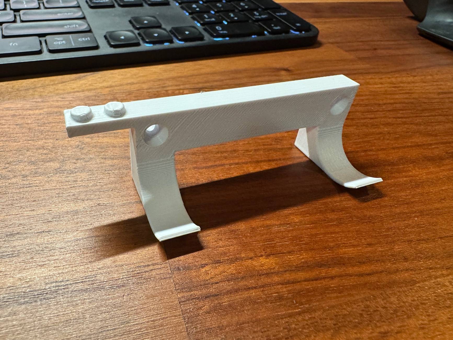

I was never able to get enough successful prints to really run into issues with the bowden tube - I was actually using the Capricorn tubing, now that I look back at my purchase history. I had all metal extruder as well. I did try going to a PEI plate at one point, as most of the issues I was having was with adhesion and warping, even on smaller prints. Ultimately I think it had to do with the printer being in the basement and the ambient temps just cooling the prints too quickly. I did try an enclosure, and moving it next to the auxilliary heater, which didn't really help, and at that point it felt it was going to become a money pit to figure out why it wasn't working and i was tired of it. I had been hearing great things about the Bambu products from friends and online, and well, here we are. I haven't gotten much more print time out of it so far, but I did print up a couple of helmet different helmet hangers to test as a gift for some of my riding buddies.
