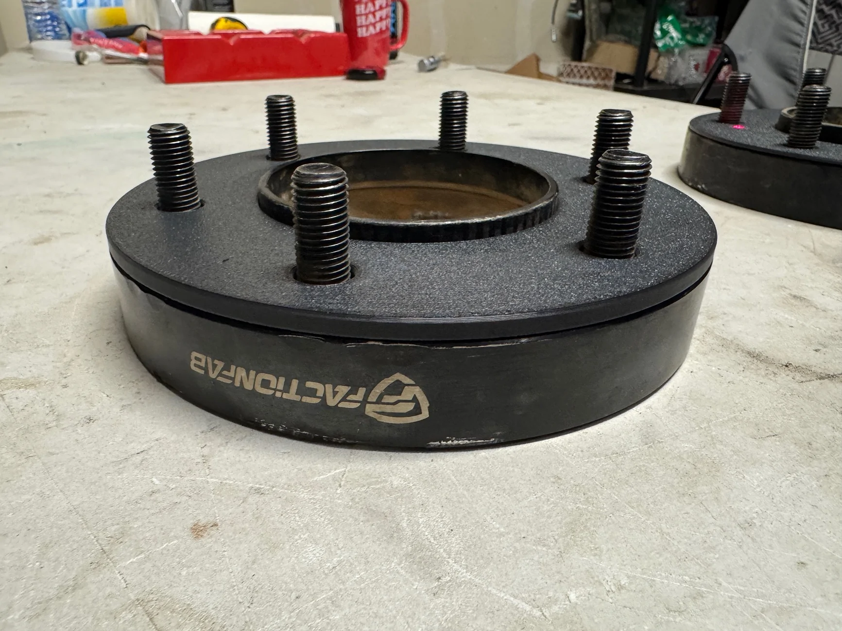

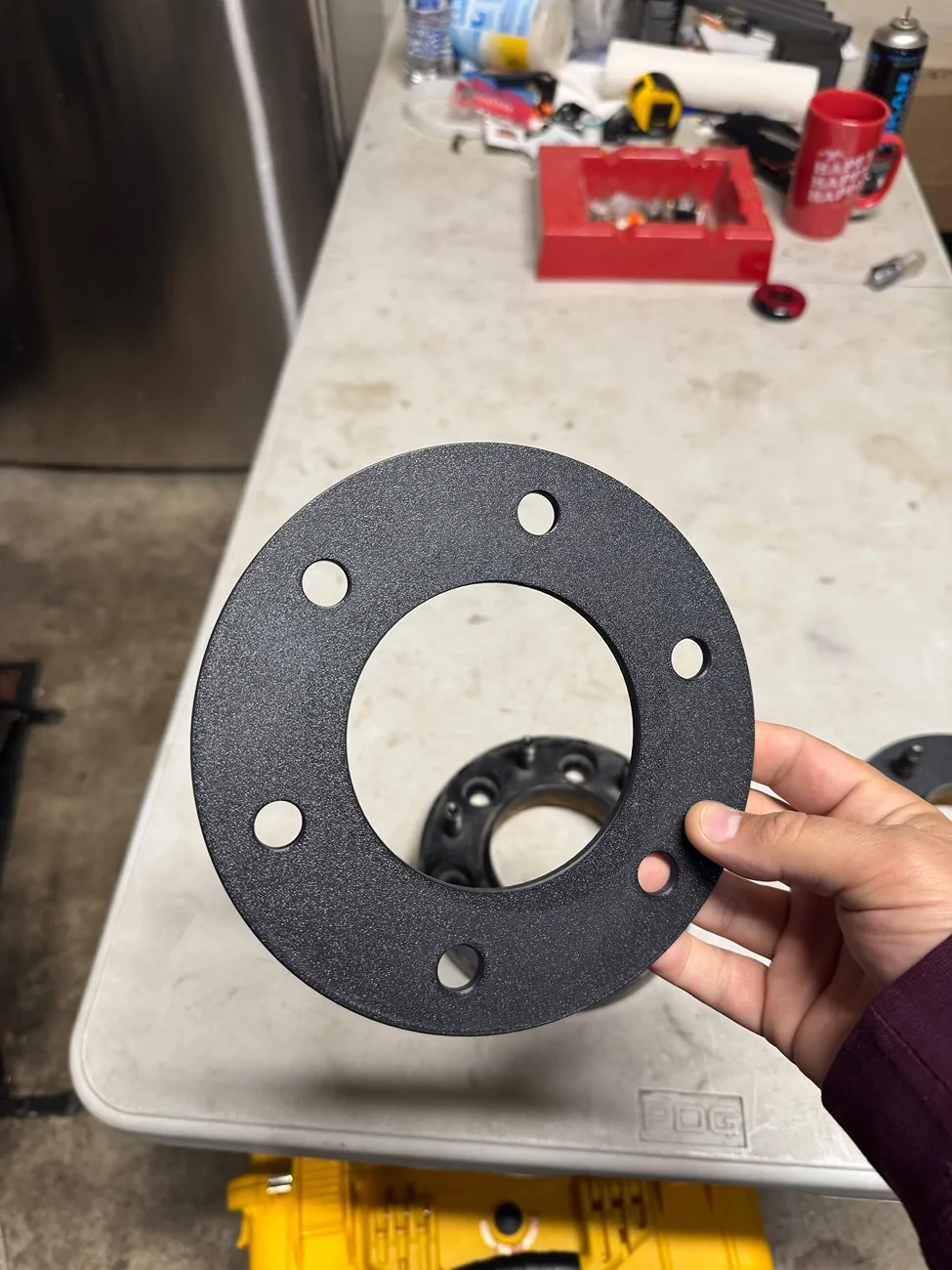

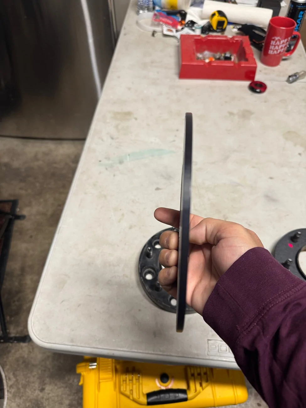

today’s project is designing a 5mm spacer to see what I need to stop the rubbing with the new tires. I’ll use these to test fit, then have them made at SendCutSend. I will also get extended studs and longer lugs so that I’ll have full thread engagement.
I’ve made these lug and hub centric.

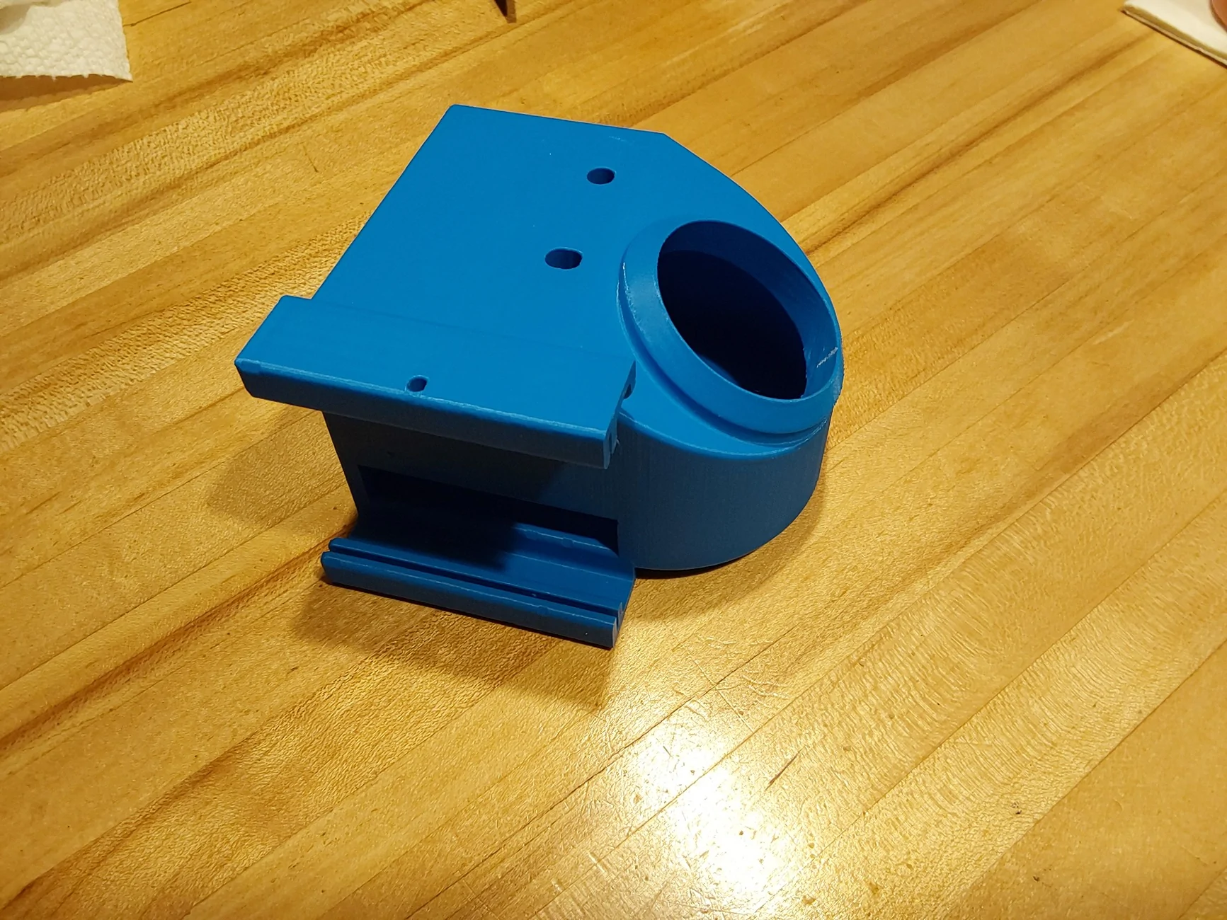

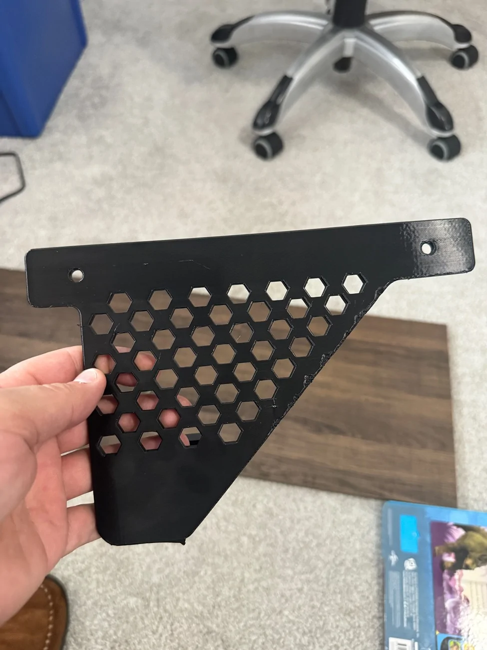

I'm using 3 walls on just about everything now. Learning to make hollow parts that you can get the supports out of. A couple recent prints I designed using Alibre.

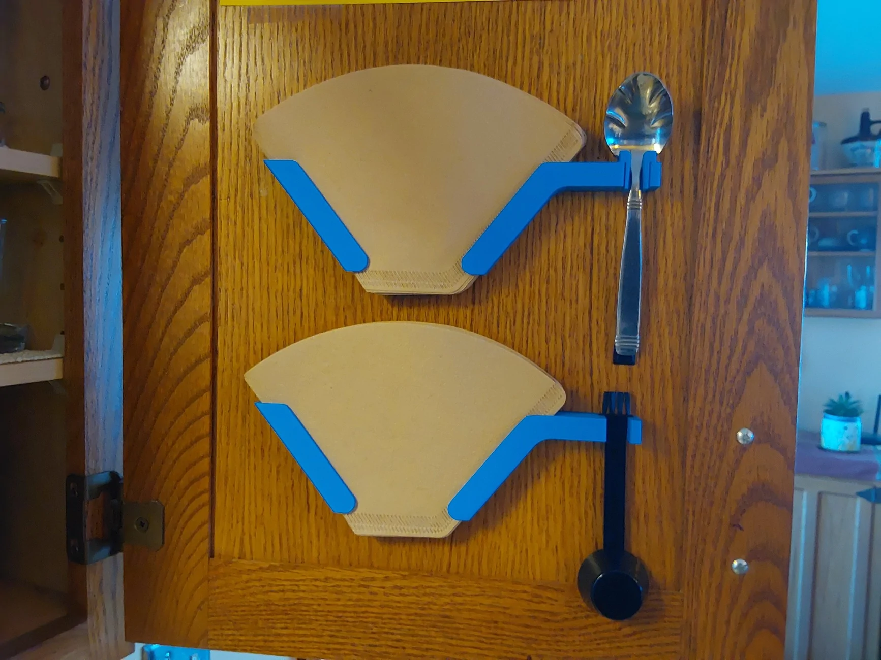

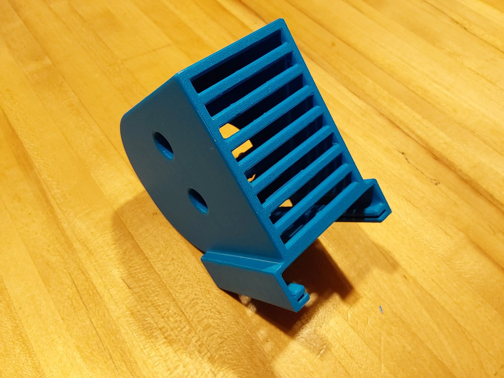

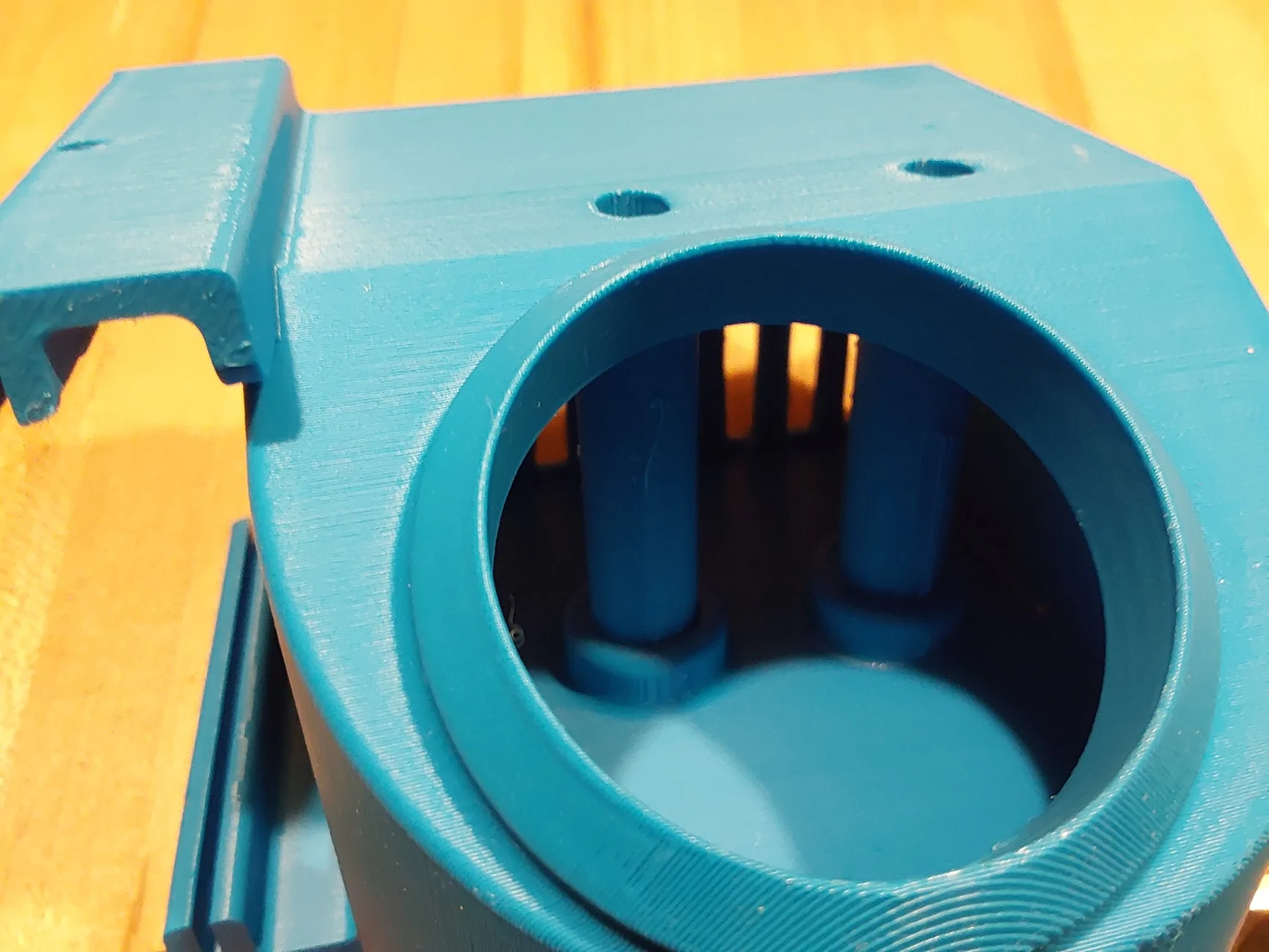

Wife wanted a way to get the big box of filters out of our little coffee area. We'll too cold to do anything else so came up with this.
A little VHB tape and out of the way storage for a month worth of filters, coffee grinder scoop, and sugar spoon. Had to print an adapter for the sugar spoon.

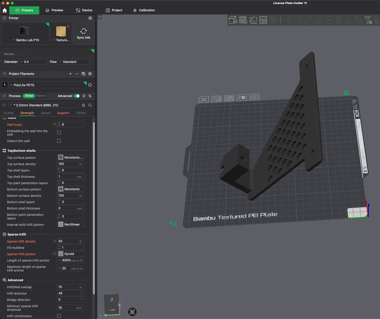

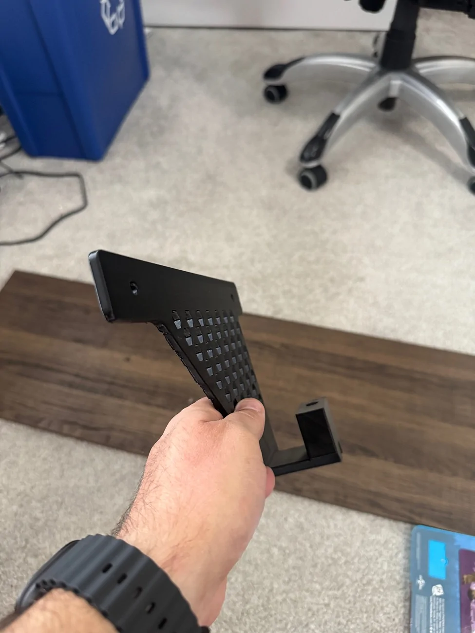

I had a PLA+ mount melt inside my cabin. This one is PETG.
Here are the print settings I used for strength. I printed it at 45 degrees too so that the layer lines wouldn't be in the same direction as the force of the license plate.

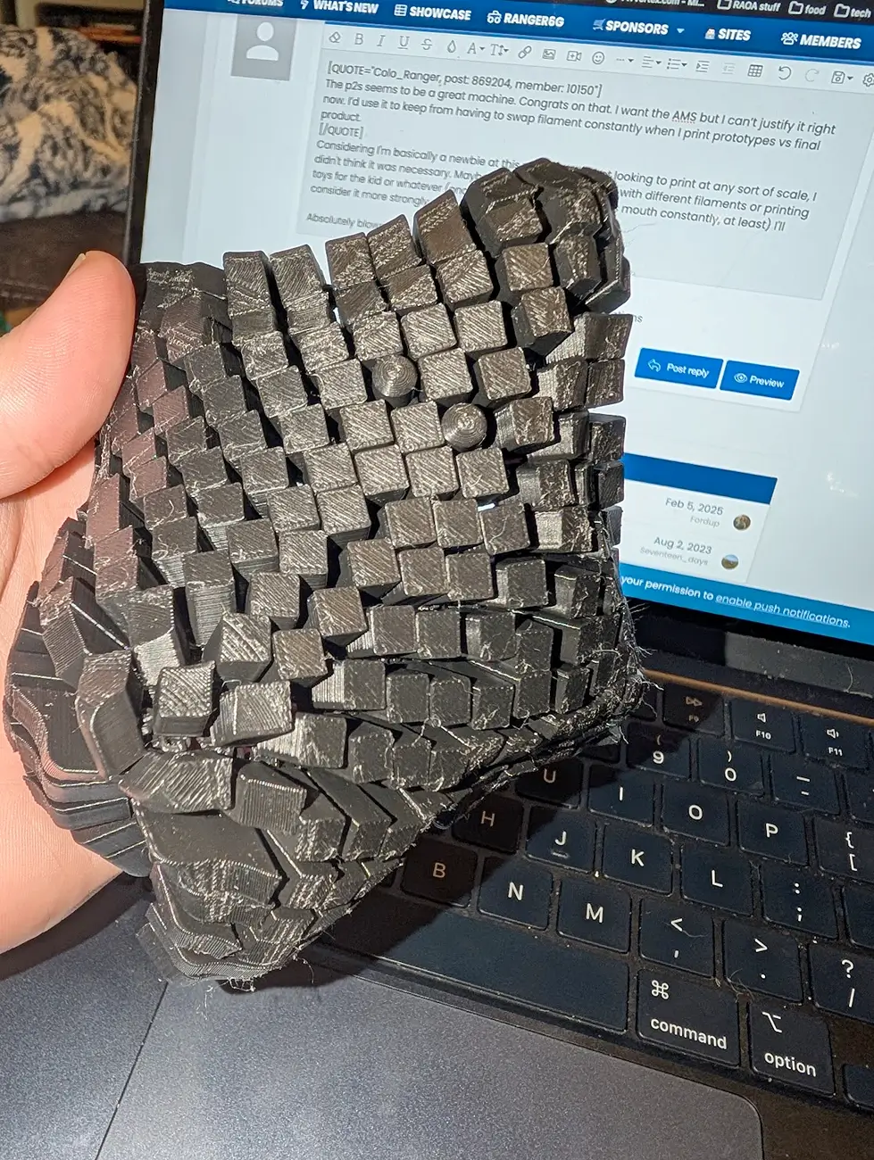

It's downright amazing how different this is from an Ender, and how much the tech has matured in the last couple of years. Ran a benchy off, I've got some stringing happening but I'm chalking that up to the filament, I've already got some new stuff on the way. Printed a couple print in place figurines, those are fun to play with, and I've currently got a flexible starfish printing off as something to maybe occupy the kiddo tomorrow while he's home sick.
PETG - good choice, also canting it over like that, I always try to consider the forces that use will place on an object, when orienting it on the build plate, it can literally make or break your print and project. How much support did it need?
