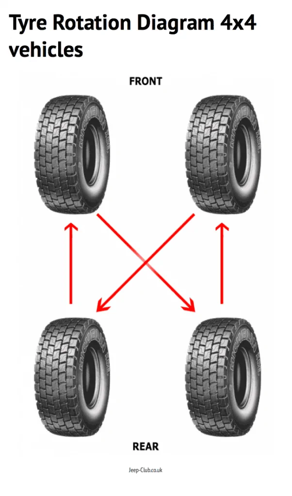

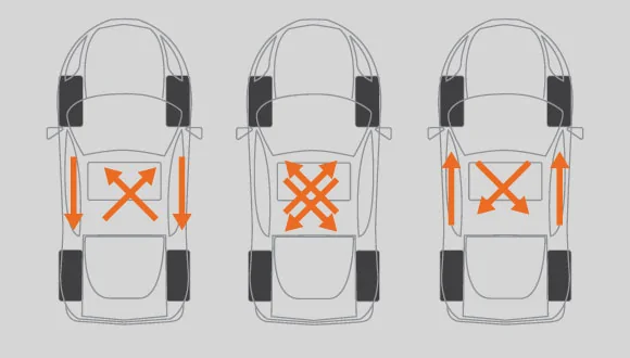

After I made my post I wanted to make sure that’s BFG recommends as I replaced the OEM tires with KO2’s and sure enough for a RWD &. 4 wheel and AWD Vehicles they recommend the Right pattern in your photo with three choices. I’m following BFG’s guidance in the event I have an issue can I reply “ I was following your guidance “

I'VE NEVER HAD AN OUNCE OF PROBLEMS WITH MY HANCOOKS. I SURE HOPE THAT WHEN YOU ARE ROTATING THEM YOU ARE ONLY DOING BACK TO FRONT AND NOT CHRIS CROSS CAUSE THAT WILL CAUSE A CUPPING PROBLEM ON JUST ABOUT ANY RADIAL TIRE.
Why are you yelling :question: Turn your caps lock off.
Here's how I rotate the tires, it's pretty well documented as the correct way...

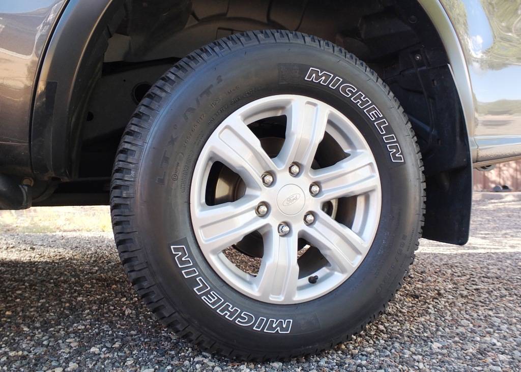

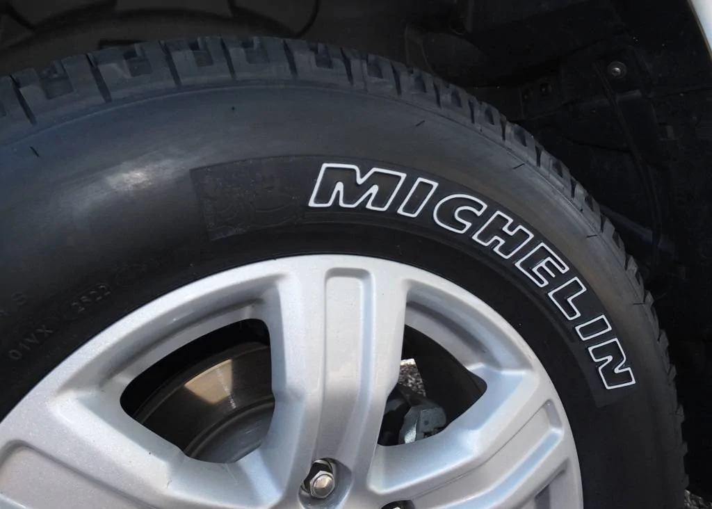

UPDATE 10-06-2022:
Had (4) Michelin LTX A/T2 265/65/R17 tires installed on our 2019 XL FX4. These replaced the Hankook LT's that came on the truck new as a dealer ordered option.
Amazing how much better the truck rides.
We had them perform a wheel alignment, I asked for a printout showing the before and after settings to help determine how bad out of alignment the truck was..... the dealership botched that and didn't give me the before alignment configuration...

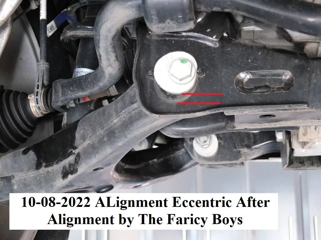

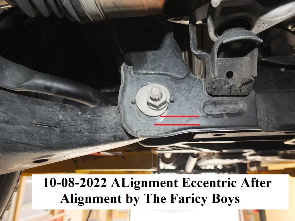

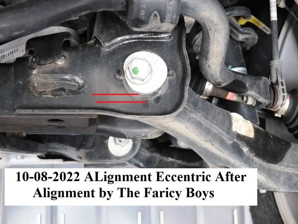

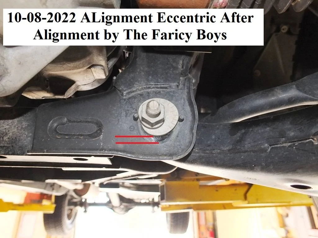

The Hankooks were cupped because the front end alignment from the factory was way off. And by way off I mean way off.
Check out how much they had to crank the eccentrics to get the truck within specifications:

I filed a claim with Ford about how bad out of alignment the truck was from the factory, and how that lead to the premature tire wear. I included the photo's I posted above of the eccentrics.
We found out yesterday Ford is sending us $658.
If I run the numbers in regard to how quick the tires wore out, I'd say Ford Corporate has treated us right. I'm kind of surprised.
And the new Michelin LTX A/T2 tires provide so much of a nicer ride than the Hankook's... so we can chalk this entire experience up has having a good final outcome.
