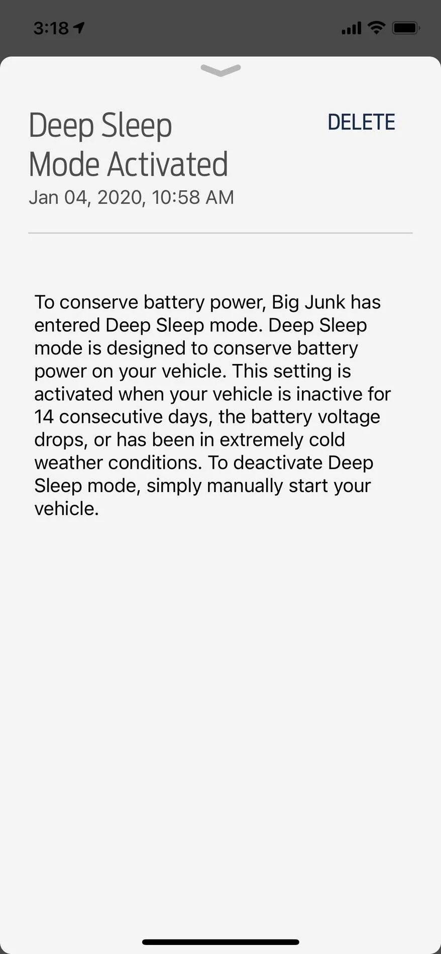

Actually it does go into deep sleep mode after 14 days of sitting. :) I was away for 17 days over Christmas that year and it went into deep sleep mode and I received the notification on my phone.

The Ranger has several 'keep Alive' circuits that draw power at all times, normally 2 weeks or so at the default battery 75% SOC will put the vehicle to sleep, which turns off most of them. The only reason to keep a Gel battery at 75% SOC is to maximize battery life..... read save warranty money.
Well, shame on me! I think I had that mixed up with how the electric shuts off after two hours, like my radar detector plugged into the 12 V outlet. The funny thing is sometimes it shuts off sooner.
