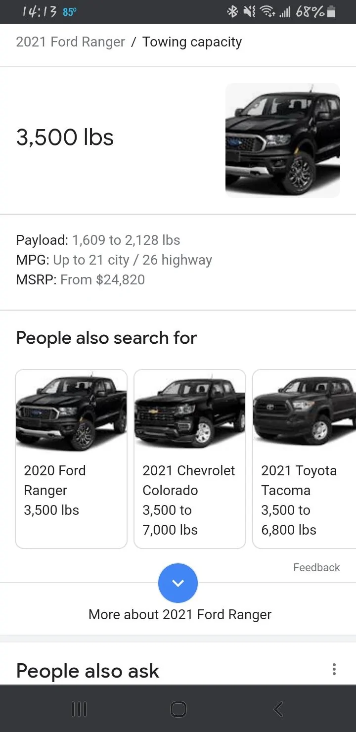

The rear is stock with lug adapters. I know it’s a beast for weight but if Ford wants to claim up to 7500lbs towing capacity I didn’t think this would be an issue. I’ll need to chew on this a while.

They base it off of this. I had the same conversation with ron hoover, a travel trailer dealer, when looking at travel trailers. When properly equipped, the ranger can do 7500.
