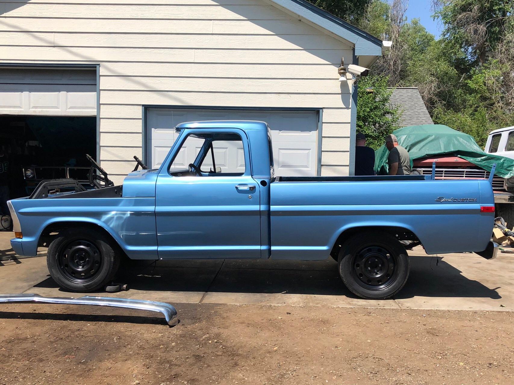

I was trying to reserve U-Haul’s auto transport to tow my ‘72 F-100 which should have a GVWR between 4500 and 5500 lbs. (it’s a bit modified so I’m not really sure what it weighs currently.) The trailer empty is 2210 lbs. Their system wouldn’t let me. I’m assuming they’re cautioning on the high side of the towed vehicle of potentially 7700 lbs. What says the hive? Would this be a horrible idea for 600 miles? 2021 SCrew 4x4 with factory tow package.

The GVWR of your F100 is irrelevant. What is it's curb weight? Have you scaled it?

Not yet, it’s not quite under its own power yet. For reference:

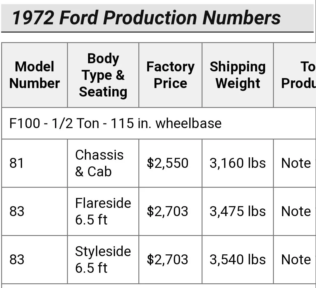

Here you go:
My concern there is what specs are used for that weight? 6-cyl, bumpers, etc. It seems to me the weight could vary greatly, like you said the only way to know for sure is to weigh it. I just wanted to see what real world experience is out there.
If you're on the fence get the trailer by any means necessary, and hit some scales on the way out of town. If it's a no-go plan another way to do it.
