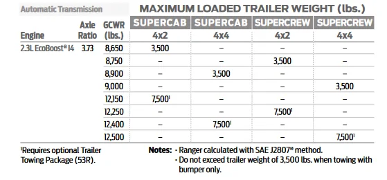

They base it off of this. I had the same conversation with ron hoover, a travel trailer dealer, when looking at travel trailers. When properly equipped, the ranger can do 7500.

That is only if you are using the bumper to tow. If you use the receiver, the limit is 7500.
From here: https://www.ford.com/cmslibs/conten...ral/pdf/guides/20Towing_Ford_Ranger_Oct15.pdf
I tried to tell em. Even showed them the owners manual. 4 cyl can not tow that much is what i was told. V6 maybe. Well i guess i wont buy a tt from ron hoover. And they showed me the sheet you had there as well. Properly equipped the ranger is a beast. But......i guess they are not familiar with the new Ranger
