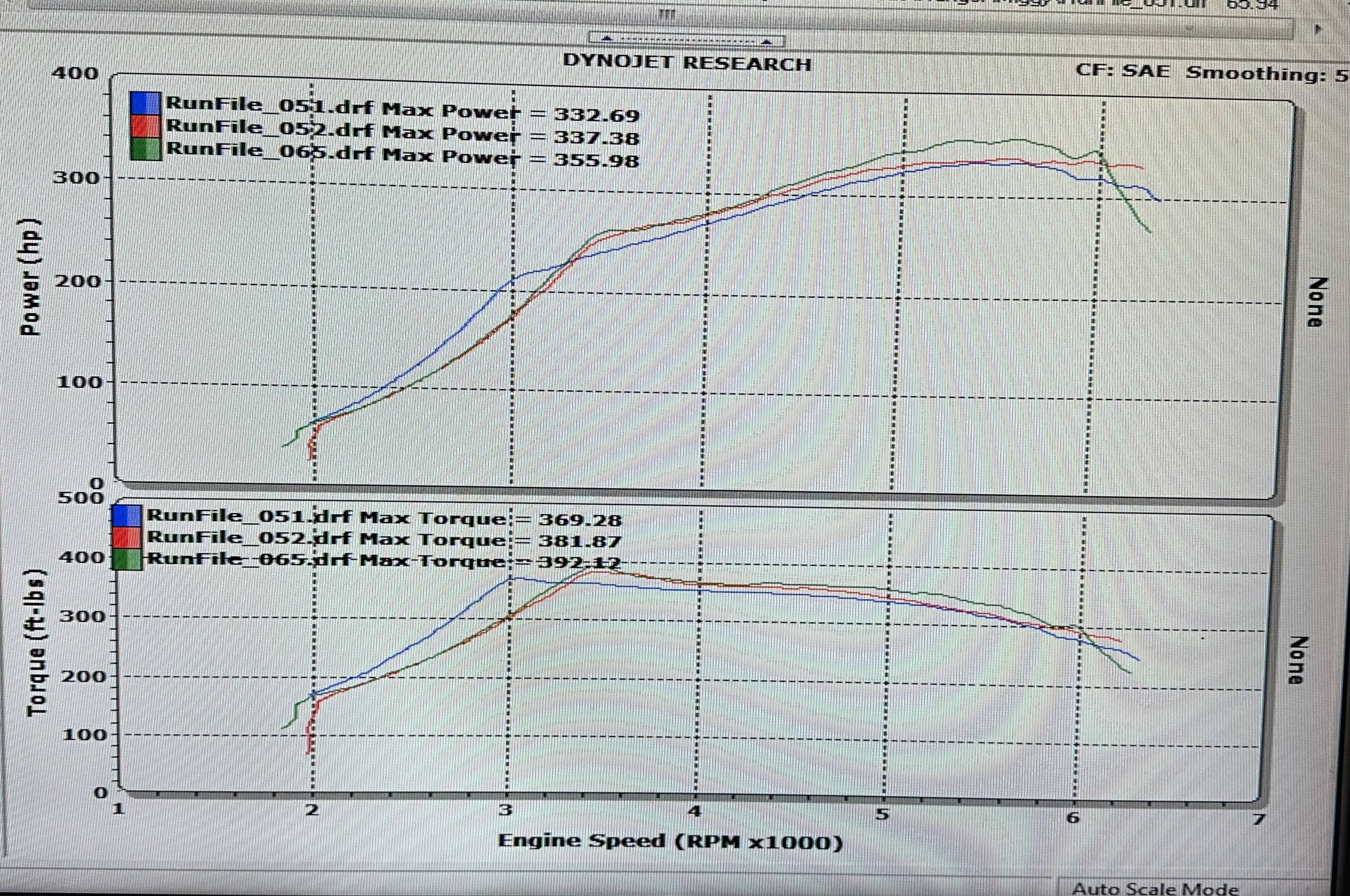

Update, we went back on the dyno and promptly maxed out the fuel injectors!
we had to back it down for safety but ended up making good power. The graph shows stock turbo on e30 then upgraded turboe30 on the same tune and finally upgraded turbo e30 and retuned but running out of injector. I’m super happy with it and am currently working on a solution to my fuel delivery situation.
That looks like some impressive numbers and considering it's just bolt ons I can't imagine someone being unhappy with it. Those power curves are pretty linear.
It's always fun to watch someone else try to max out stuff though.
Those are pretty crappy numbers considering it a “Better Turbo” ..

Here’s a stock ranger with an unleashed tune ..Note the torque ..
the torque is purposely reduced down low to keep the rods inside the block. The horsepower as noted is dramatically reduced due to injector limitations. I have no intentions of allowing more than 400lbs/ft. More torque is way harder on the engine than more horsepower. In the end it should wind having gained about 30-50hp depending how brave we get with it but I need more fuel first before going further. For now it has 400rpm and well over 20hp detuned from it until we get injectors.
also note that your dyno graph is in std correction factor while mine is in sae…. If I switched my graph to std correction it would show around 10+ more horsepower.
HP Show Torque go ..
Just a tune will get you there ..
