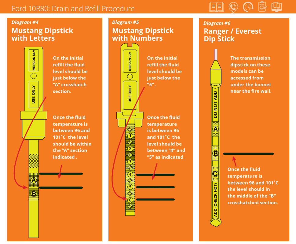

Looking forward to your findings. The Ranger dipstick style shown in that shop manual procedure is different than what is shown in the PDF posted in Mustang forums. Please confirm which style you find.
Finally got a chance to check mine on Sunday. Drove the truck around for about 30-45 min, non-contact temp reading on the pan showed 198f and the dipstick fluid level was at the middle of the diamond, under the 5 mark. Guestimation has that at least 3/4 to 1 qt. low on fluid. There's no sign of leaks anywhere, so it'll be going in to the dealer to have them check it and add fluid so there's a paper trail on it. That way if there are any issues with the transmission later on, I have proof that the transmission was underfilled at the factory.

Once you have to the transmission up to temp, then while parked on a level surface crawl up under it and on the passenger side near the bell housing, there's a 19mm bolt looking object that sticks up about 1.5-2". That's the dipstick. And let me tell you, it's an absolute bugger to break loose. Thankfully there's enough room to maneuver a box end wrench or short ratchet up on it. The secondary cat is close but there's enough room that you should not have any issues.
Once you get it broken lose, go back in the truck and cycle through the gears with a 2-3 second pause between and then back into park. Now go pull the dipstick plug out and see where the level is at. It's supposed to be between the 4 & 5 mark on the stick. If it's good then tighten the plug back down. The torque specs for the plug is 52 lb.ft. If it's low then it's your call if you want to add fluid or take it in so the dealer can do it.
