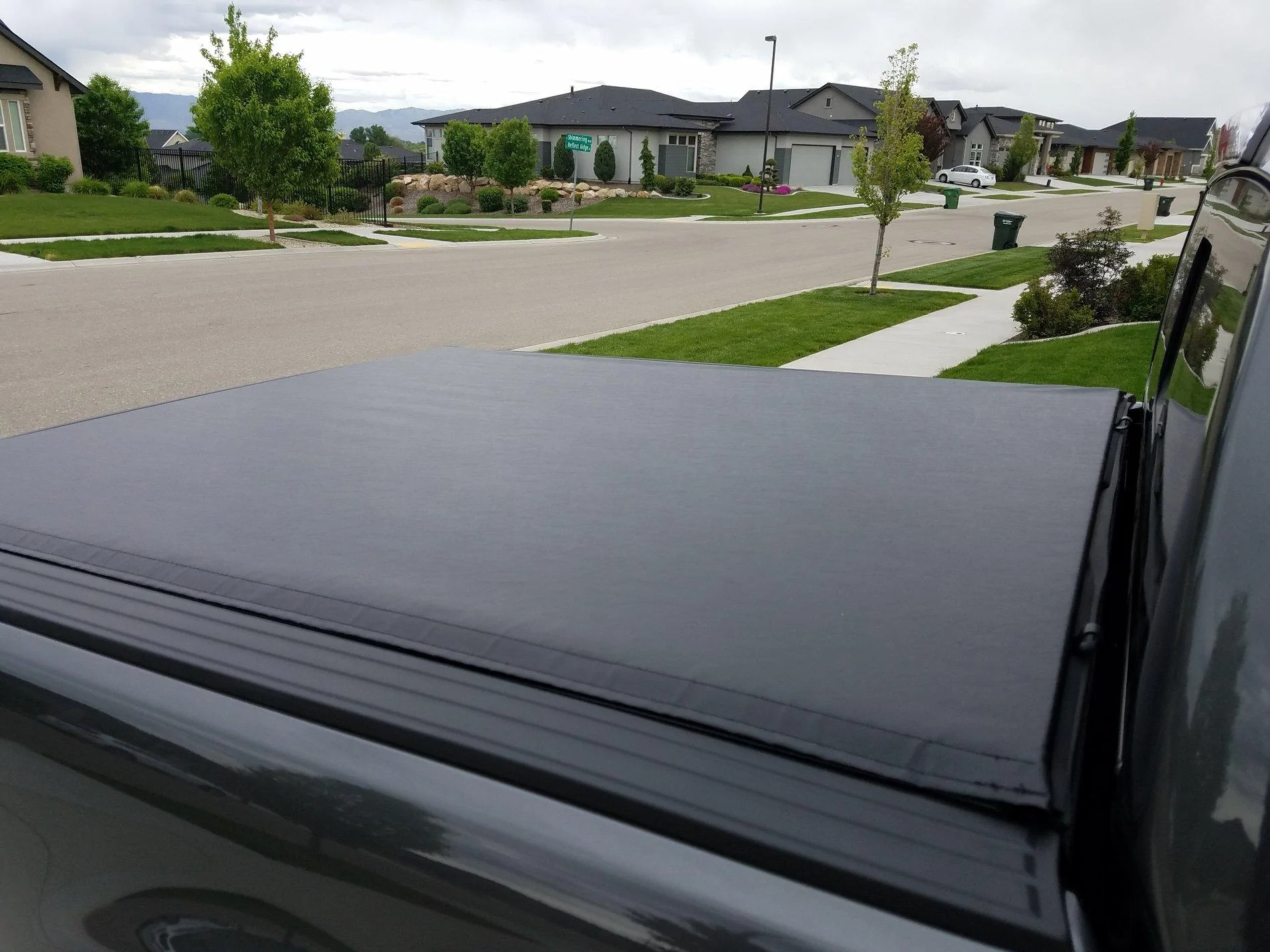

@svache What if you tighten the rear clamp first, then the front, then the center. It seems like either the bed caps have a little bit of an arch to them, or else the Truxedo rails have a bit of an arch the opposite way. My Sentry cover was like that too, but I pushed down on the rear hard enough to make them sit flush when tightening the clamps.

I think I tried that, but will give it another try. I tried several things so maybe I'm thinking I did it and actually didn't lol. Thanks! :)

Well, looks like I didn't do it in this order yet lol :LOL: just did what you said and it worked out like a charm :D Thank you so much for the suggestion!
I have to say I'm still not too happy about the little space between the seam (or whatever it's called) and the tailgate, it still seems like there's plenty of chance water is going to leak through, but at least it looks better!

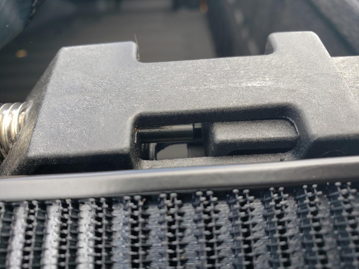

One other thing I have been wondering about, is that bit where the cover latches onto the rail (tailgate end). They say it's a spring plunger, and I have to be honest that I may not be understanding correctly (maybe due to a language barrier, English isn't my first language), but shouldn't that mean that it could be pushed in with enough force? For some reason it seems like it's all just solid on that end. Is that normal?
We're dealing with pretty warm weather right now but I'm a bit afraid that when it turns cooler in a few months, that the cover will lose it's tension (I know I can readjust it but still) if it's not in fact working as a spring...
Just in case, this is the part I'm talking about:

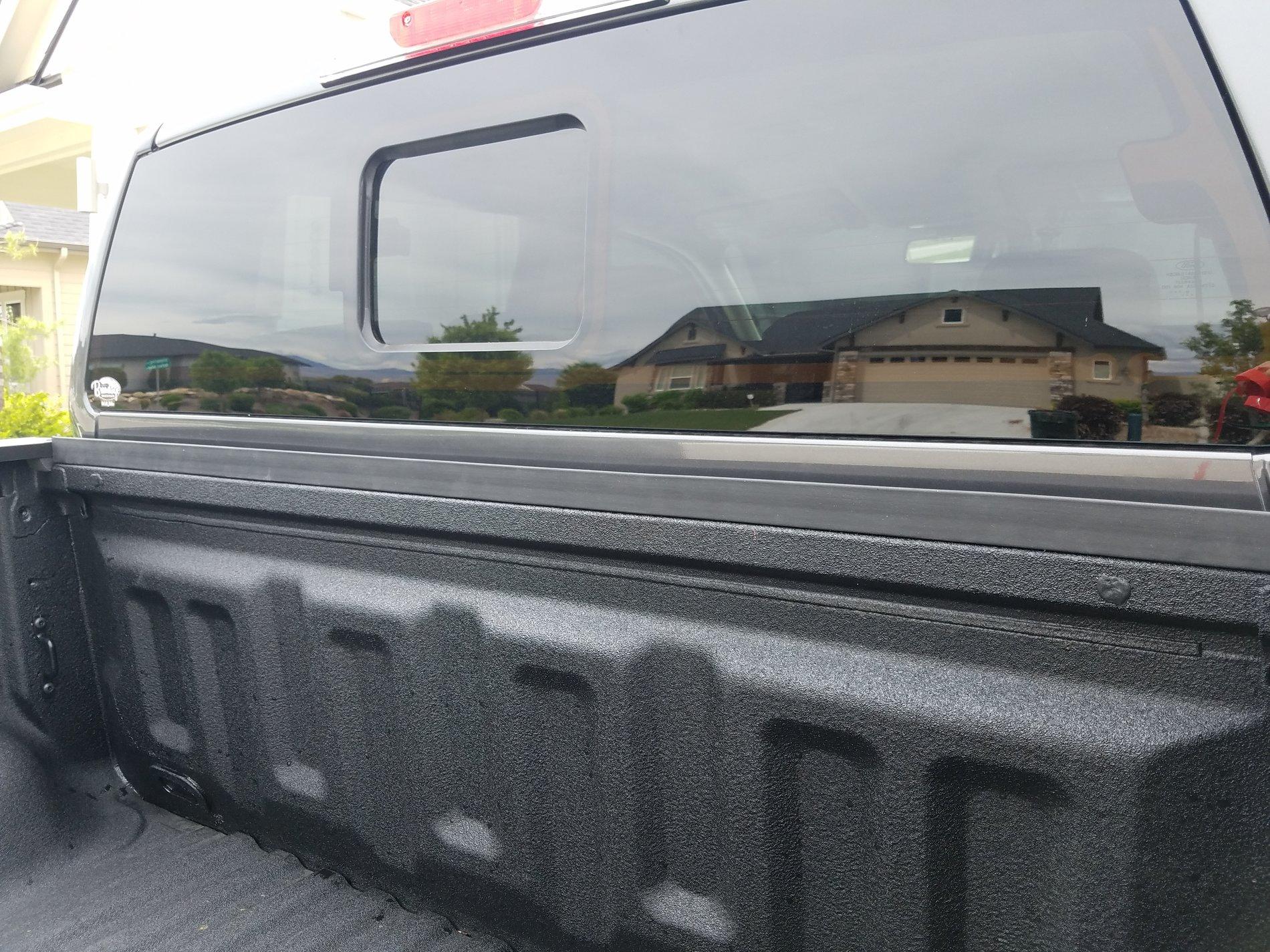

Can anyone post pics of their brackets installed with sprayed on bedliner? Or how you modified it to work, just recieved my cover today didnt get the accessory bar or bulkhead weather strip or the 6 clamps to hold the rails i was also having trouble trying to install those brackets. Any help is appreciated

@Oradank - at the tailgate side I used a sharp (new) utility knife, and scratched in lines roughly around the area the brackets had to sit. Then I used a flat screw driver to scrape the liner off. On the cab side I screwed the brackets in and gave it a bit of a kick with my feet to get the bracket "re-adjusted" (if you do this, don't kick too hard lol). It worked for me like that to get it adjusted enough.

Just installed mine with the spray in bedliner. Didn't make any adjustments and it worked out fine. Only thing is they are now shipping with cheaper parts. They no longer have the bulkhead accessory rail. It's just a thick piece of foam.
