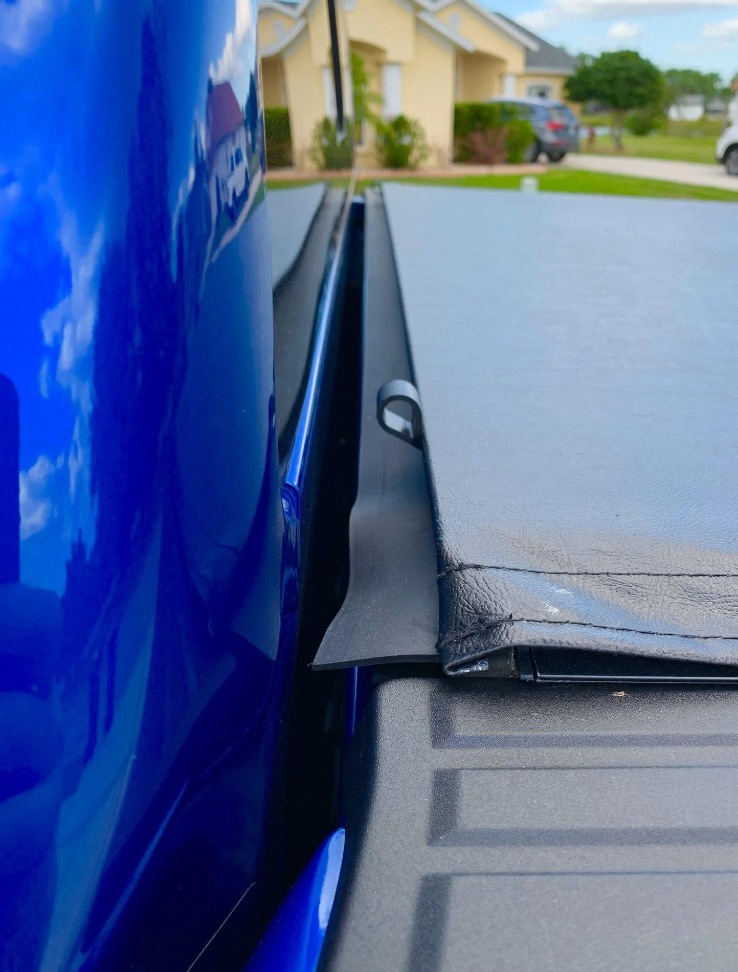

Here’s the Bulkhead seal on the Ford Soft Rollup Tonneau. Good extension over the bulkhead rail that comes with the cover kit.
I also have the Ford Rollup on cover kit installed on my Lariat SuperCrew bed. Mike leaks at the bulkhead seal. It doesn't have the flap shown in your photo. I called TruXedo support and they were not very helpful; saying they don't warranty it to be waterproof. The SN of my cover is 102593217 purchased in April. I'm thinking they made an improvement but are not admitting it. Do you know the SN of your cover? It's on a paper label stuck on the bulkhead crossbar that contacts the bulkhead seal, driver's side. You have to roll it all the way up and look under the roll to see it. They have asked me to send a bunch of pictures so I plan to show them your photo along with my photos of the leak areas. Any info you can give me would be helpful. Thanks
Well, Mine is the Ford OEM Rollup Cover that I ordered through Ford Accessories. I can't confirm that it is made by Truxedo, I did say I assume it is because it looks so much like the Truxedo LoPro I've had in the past. If you've confirmed it is a Truxedo product I'll see if I have a SN label on it.
Thanks, mine came with printed installation instructions from Truxedo and the vinyl roll has the Ford logo embossed in it. The instructions call it a Truxport and the phone number got me to Truxedo. The support person agreed it is their product for Ford. I guess a dealer installed yours.
