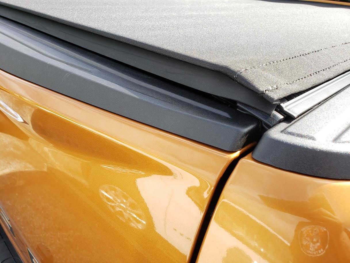

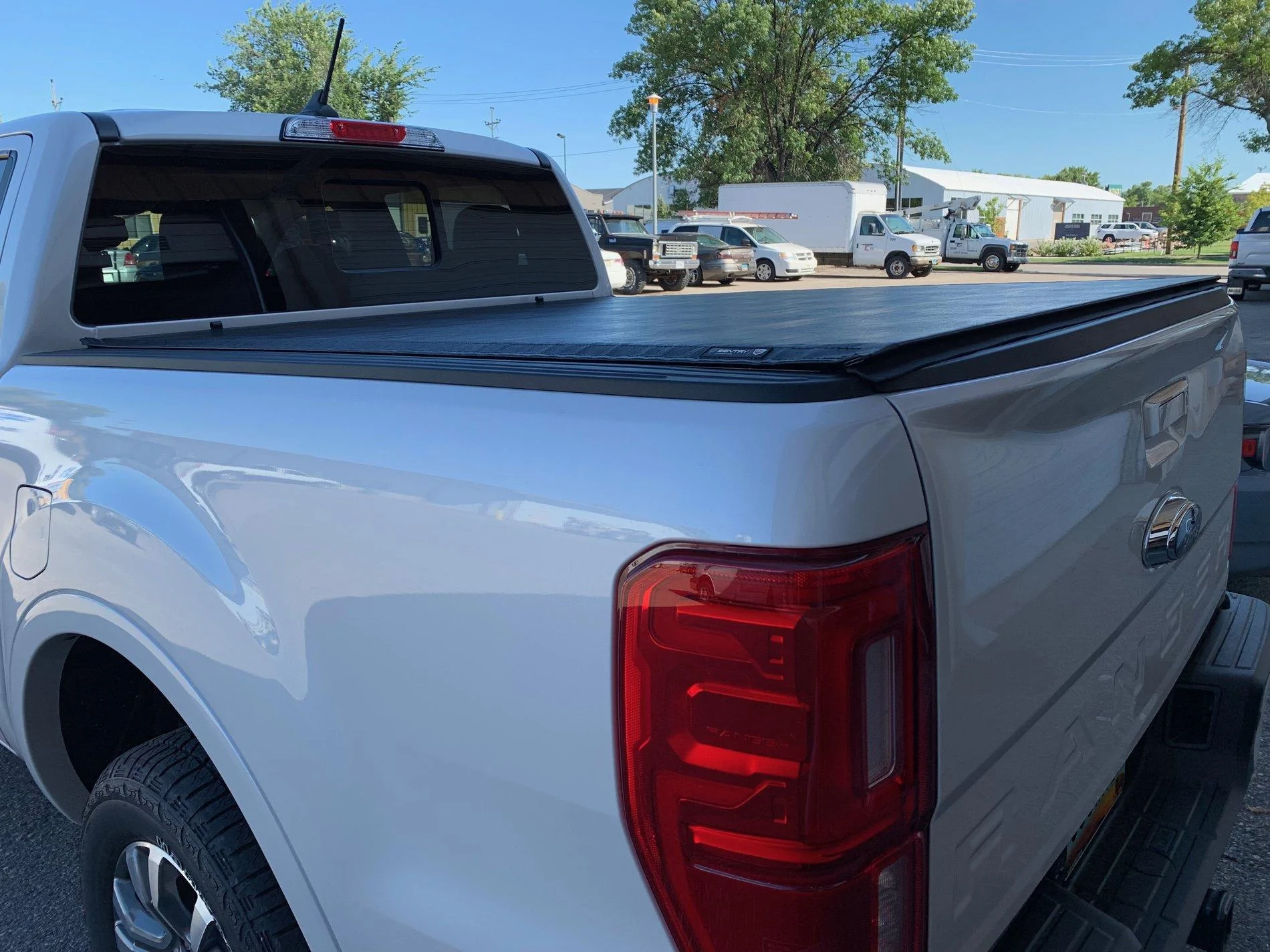

Here's my s/n: 101790326
The rubber seal shown is actually attached to the Roll up Cover mount, not the Bulkhead seal rail. I've yet to get any water inside the bed from this area. Rarely any water gets in, even when I take it through a car wash!

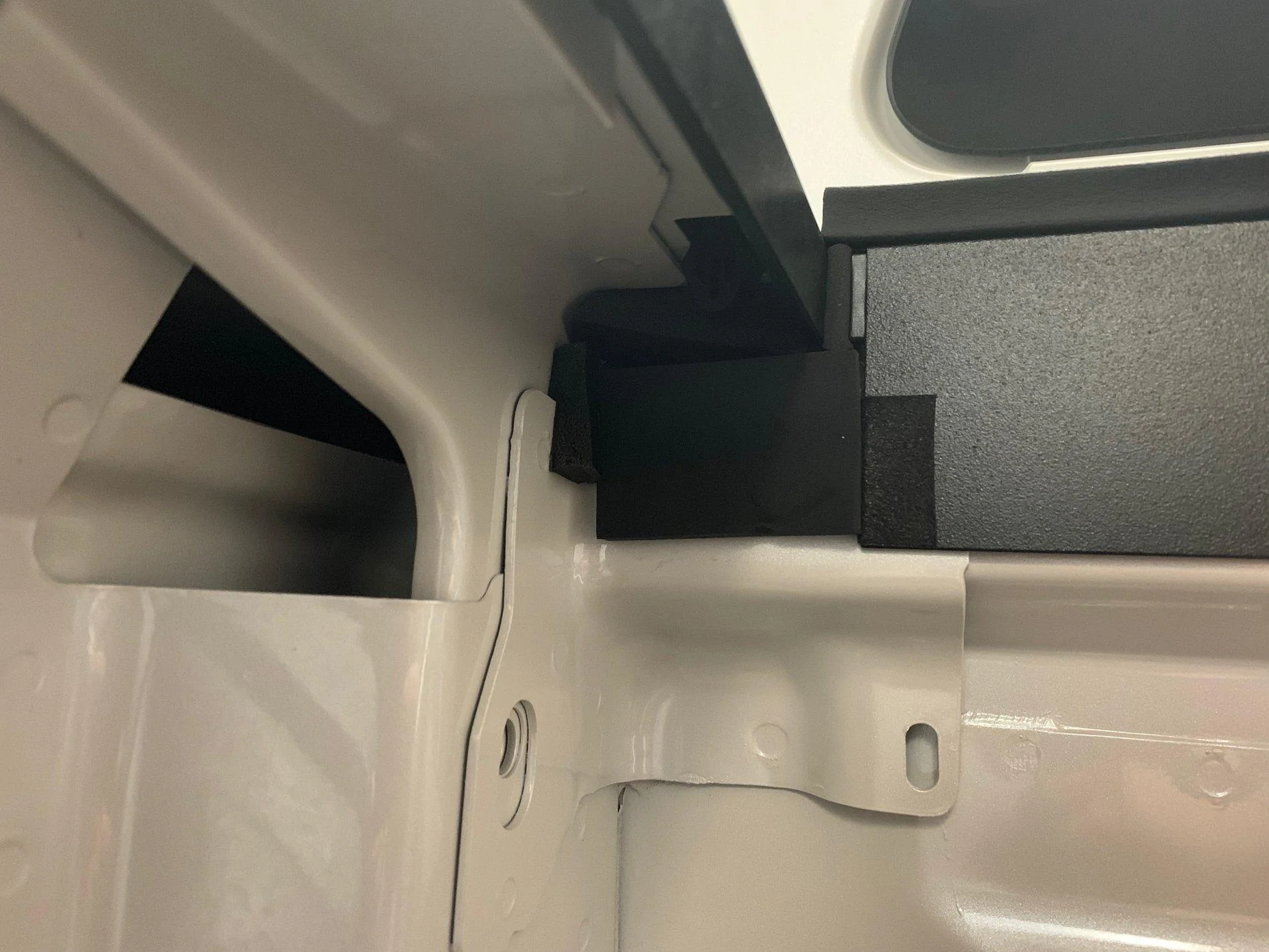

There is an accessory rail but on my truck it doesn't slide up high enough to touch the main cover crossrail. I could modify it or add a strip of weather seal to the top but that doesn't fix the openings at the corners. I would have designed the bulkhead seal differently by extending it to reach the corner of the bed. I aimed a flashlight between the cab and bed and took this photo from inside the bed. You can see light in the corner and along the length of the seal. Water entered along the seal and in the two corners at the sides of the bulkhead seal.

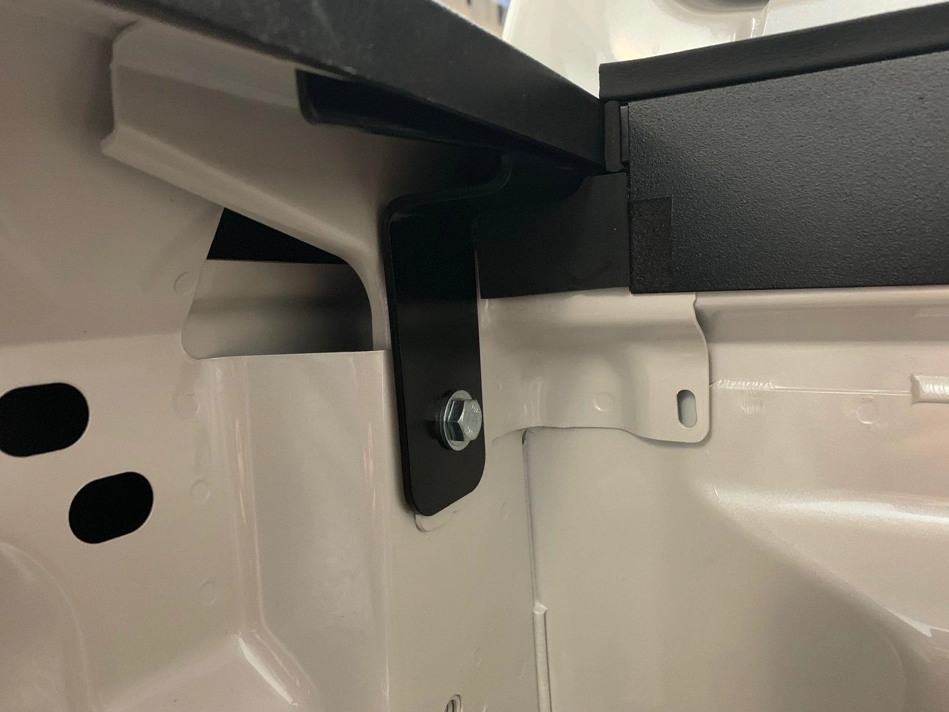

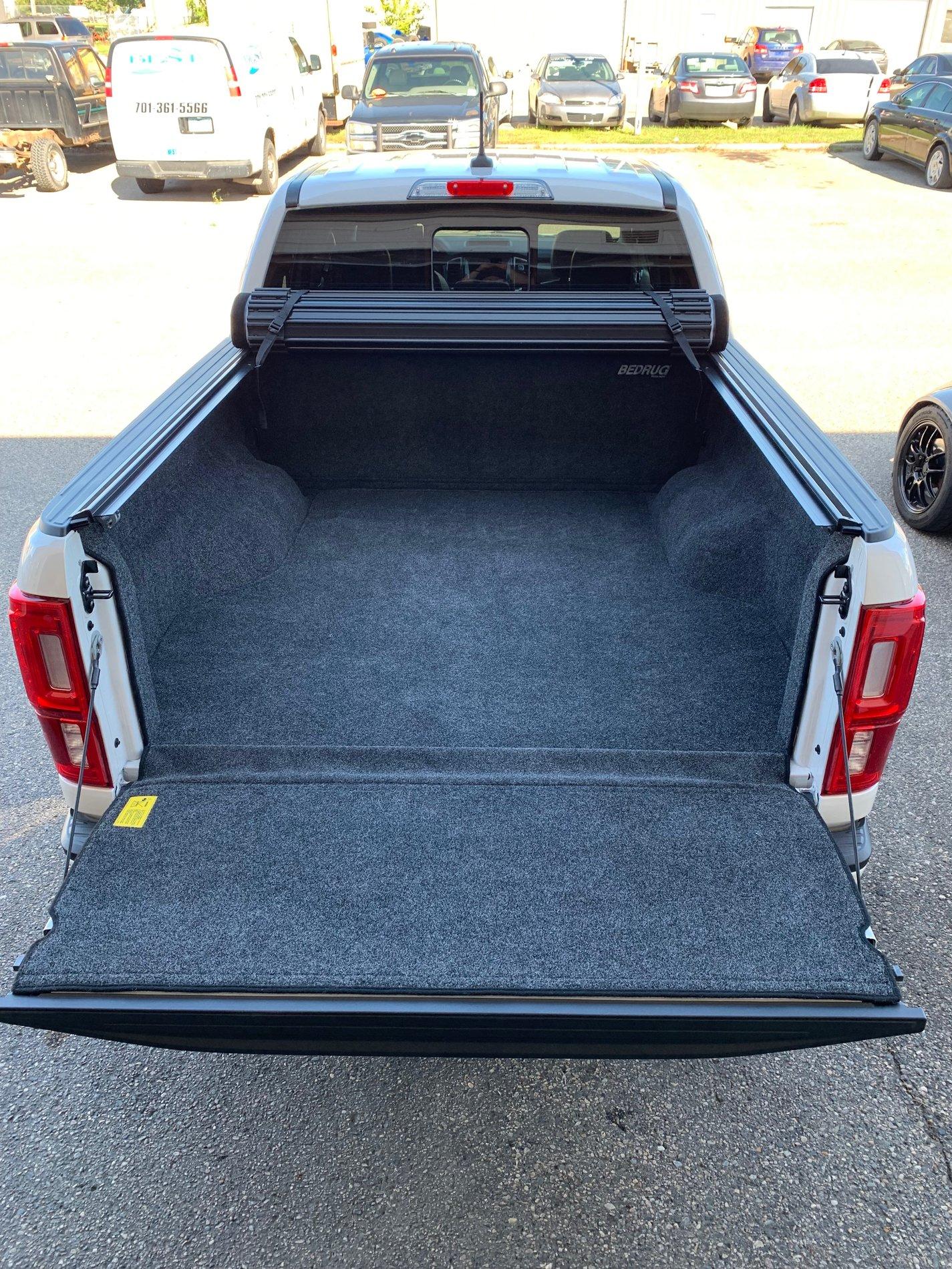

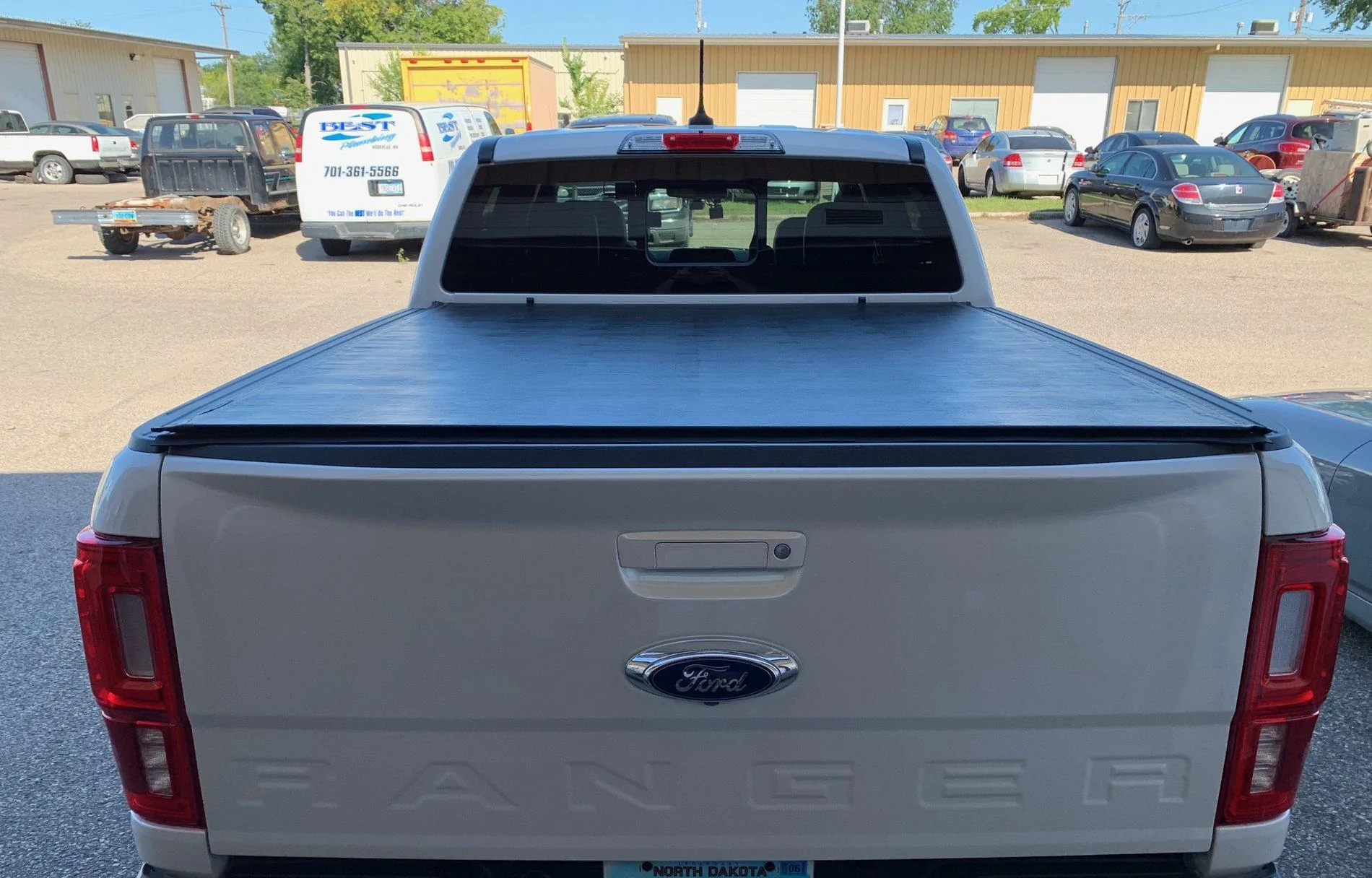

Just installed a new Truxedo Sentry hard rolling tonneau cover on my Ranger today. I also installed a Bed Rug at the same time today. After washing or rain, I'll check to see if/how much water leaks into the bed. I did add some extra pieces of foam sealing tape in the front corners of the box to hopefully help keep the box dry.
The last pic shows the Truxedo front bracket installed on the driver's side of the box, but I had it incorrectly oriented. It has to go between the plastic bed cap and the aluminum rail of the box. Their instructions kind of suck and don't tell you this at all.

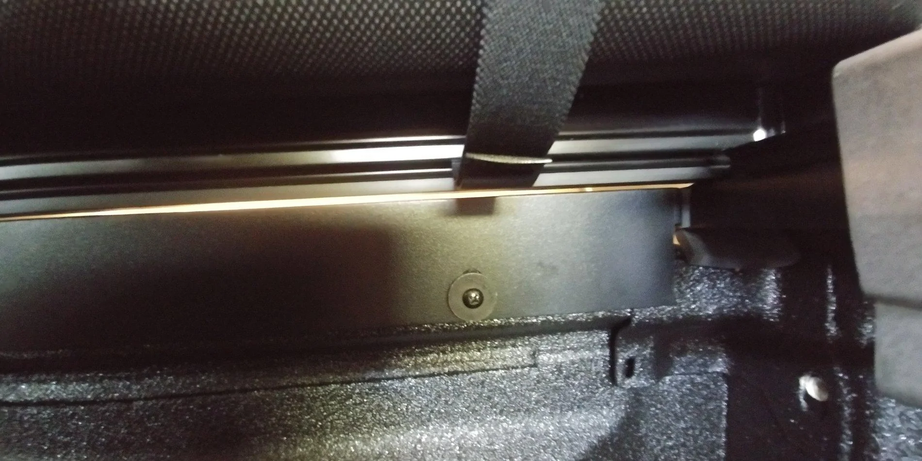

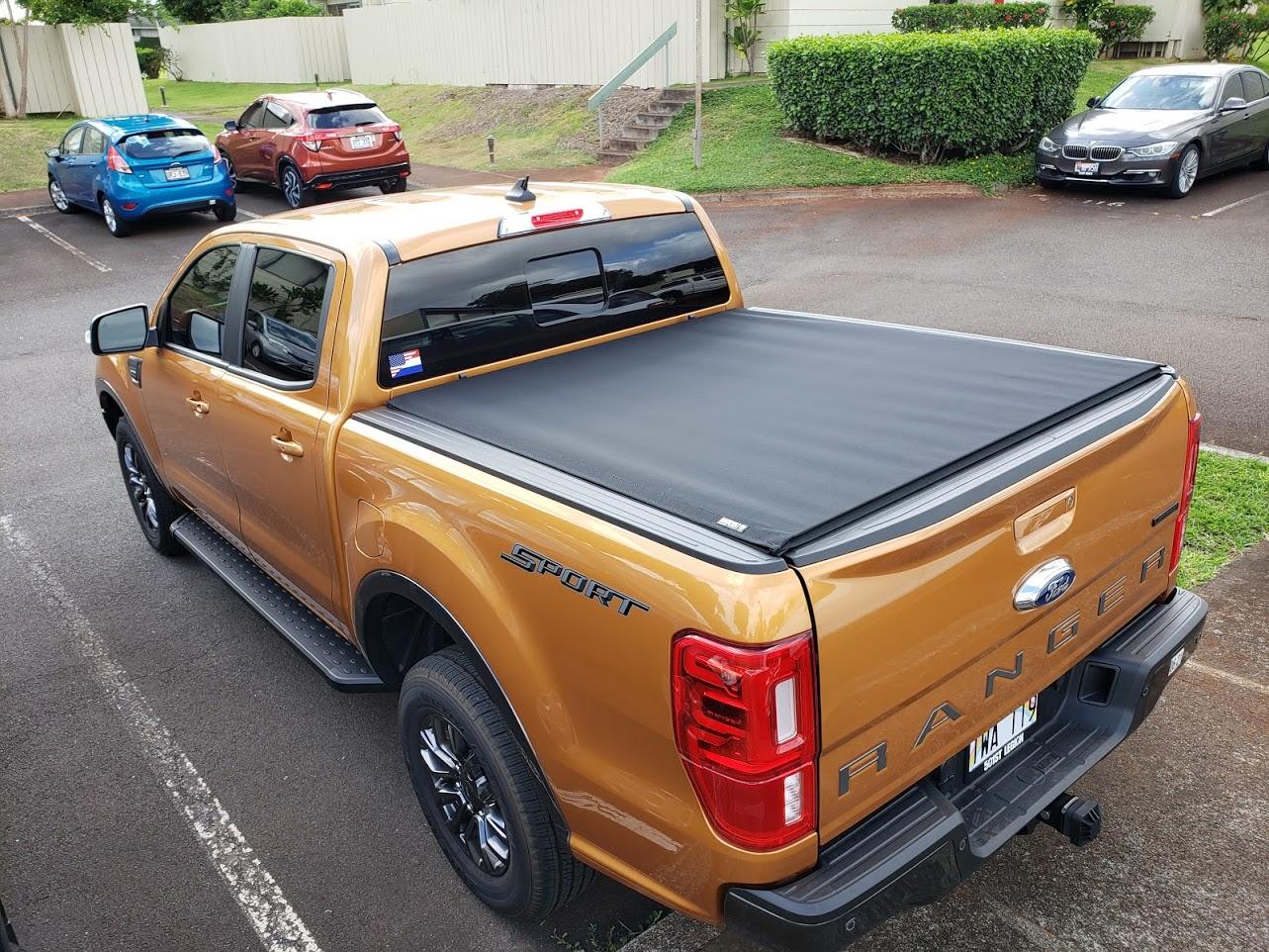

Installed the Pro X15 today... they're not lying when they say the instructions are a mess lol
I like the overall looks, but I ended up having several of the same issues the OP had, due to my spray-in liner. I took some of the liner out (which was easier than I thought it would be) and figured it would fit nicely... Well, no lol
I am not sure what is happening, but for some reason it looks like the cover is like half an inch too short... I had the hardest time getting it closed, had to loosen the tension bolts a lot to be even able to close the cover. I have a feeling it may still be way too tight (it needs a lot of force in order to get it closed). And once closed, you can clearly see it's not going to be waterproof.

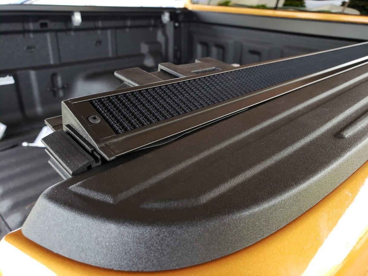

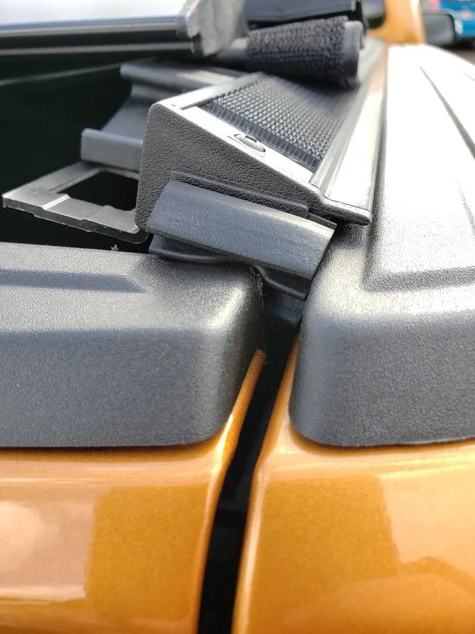

Another issue I had (and have) and I wonder if someone here maybe knows the answer/solution to, is that the rail on the passenger side refused to go flush at the end of my bed. It sticks out just a little bit, maybe 1-2mm, but enough for me to be annoying. Also, I think it may be part of the reason why it looks like I have a gap in between the seal and my tailgate. I tried my hardest to get it down, been toying with it for several hours, using a lot of downward pressure when tightening the bolts, but never been able to get it nicely flush. Weirdest part is, it seems like both my truck and the rails are straight, so I'm not sure why it is doing this.
I'll post some photos below, if anyone has any idea how I can solve that little gap issue or what is happening with it, it would be most appreciated :)
