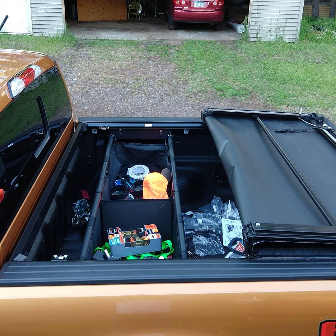

Installed the Truxedo Deuce on my SuperCrew last night. Took a bit longer than a usual tonneau install, with the additional bulkhead seal and functionality of the cover. About an hour total, still not bad though. Wasn't too bad once I got into it and started to understand how it was going together.
A good combination of roll-up and soft-folding!
Will need some practice on my part to get the front fold to open and close properly. The latch to open the front fold is still a little stiff, so hopefully that breaks in a bit more otherwise I'll just lube it up a bit. Allows great access to the accompanying Truxedo Expedition bag I also installed near the front bulkhead!

Very nice cover, I've never seen one fold back like that, wish I did more research before I purchased mine. I just went with Ford’s OEM roll up.
The Truxedo expedition bag- Can it be mounted towards the rear of the truck also or just the front. I might like that option more than the swing out cases and looks like you can store a heck of a lot more. But it would have to mounted towards the rear for it to be practical for me. Thanks

The bag can be mounted anywhere in the bed. It just clamps to the bedrails like the cover does, so it can be slid further FWD or all the way back or wherever. It definitely has more room than the swing out cases. But that means it takes up more room. I wanted it up against the FWD bulkhead to keep most of the rest of the bed still usable. Though the bag just slides into slots on the rail mounts, so it can be removed quite easily if you need that extra bed space.
The write-up for it says it's only for full size trucks and only fits beds of certain widths, but reading the reviews there were plenty of people using it in their Tacoma's and other mid-sizes, and it fits perfectly in the Ranger. The cross bars are adjustable so not sure why the manufacturer is so adamant it won't fit. Definitely a good way to carry all my small and loose junk.

Super slick! I saw it in the Ford Accessories but didn’t know it could be mounted in the front or back. Although it does look like it would be quite a reach to put something in it from the back with the tailgate down, but closed it looks like it might be doable. Very nice setup you have.
EDIT: Just watched a Video, I’m really liking this option. Install may vary on the Ranger but I now get the idea.

Yeah, it might be a bit of a reach with the tailgate down, but with it up you shouldn't have much of a problem at all. One of the pluses of getting a mid size for me was I'm able to reach over the bedrail and grab something from inside the bed without needing a step ladder or anything. Granted, I'm 6' 1" with pretty long arms, so I don't have much of a problem.
The install in that video pretty much matches for what I did in the Ranger. Not too complicated of a setup.

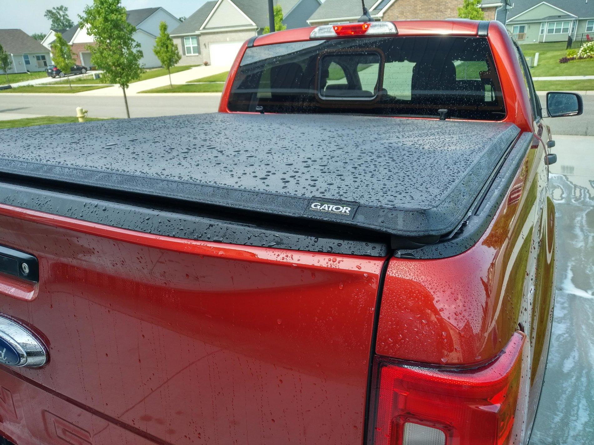

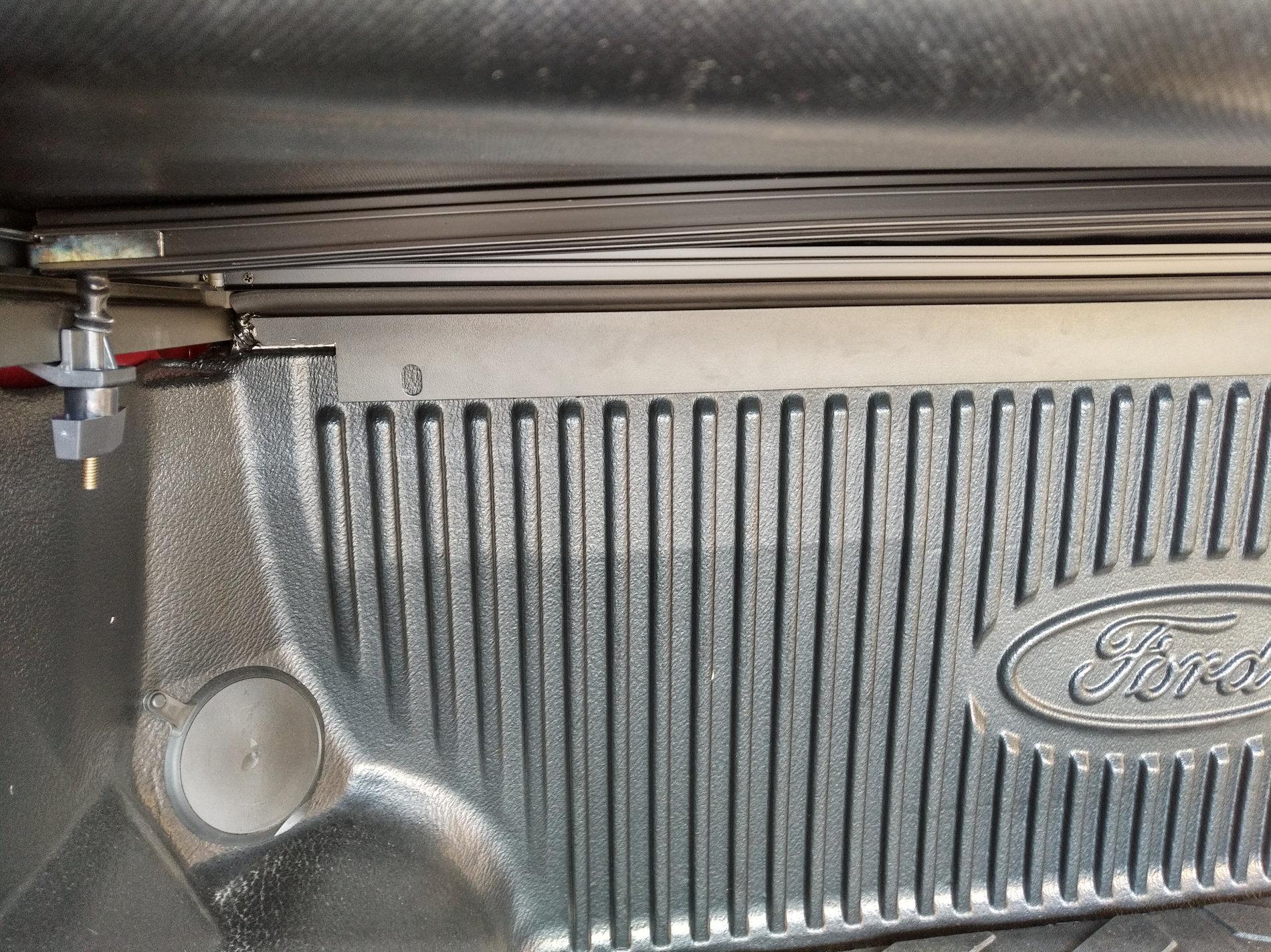

I installed the Gator SFX Tri-Fold a couple nights ago. I have the Ford factory drop-in bedliner, so had to get a little creative with the bulkhead bar. I ended up having to notch the corners (see picture) so it would sit flush with the front and top of the liner. I used Gorilla brand mounting tape (strong double sided tape) to mount the bar. I figured I'd see how that works before I get crazy drilling holes in my new truck lol so far so good!
The cover seems well made and was otherwise very easy to install. I drove home through a hard down pour the second day I had it, and the bed was dry when I got home aside from a few drops from the front corners (not the cover's fault). I'd recommend this as an inexpensive alternative to some of the name brand covers out there.

NICE, I also have ford factory drop-in bedliner, I was planning to install the Gator Soft roll up, but it requires to drill some hole for mounting the bulkhead bar and also side brackets for the roll up rails, I end up returned. Probably gonna get the tri-fold one you got, I will use your idea of double stick tape and notch the bulkhead bar

This looks great! I’m planning on installing one of these, but I am looking to install my bed lights before then. Could you maybe take a few shots on the inside of the bed where the rails are, so I can install the lights without having to redo them? Or should I just wait until the Deuce is on before installing the lights?
