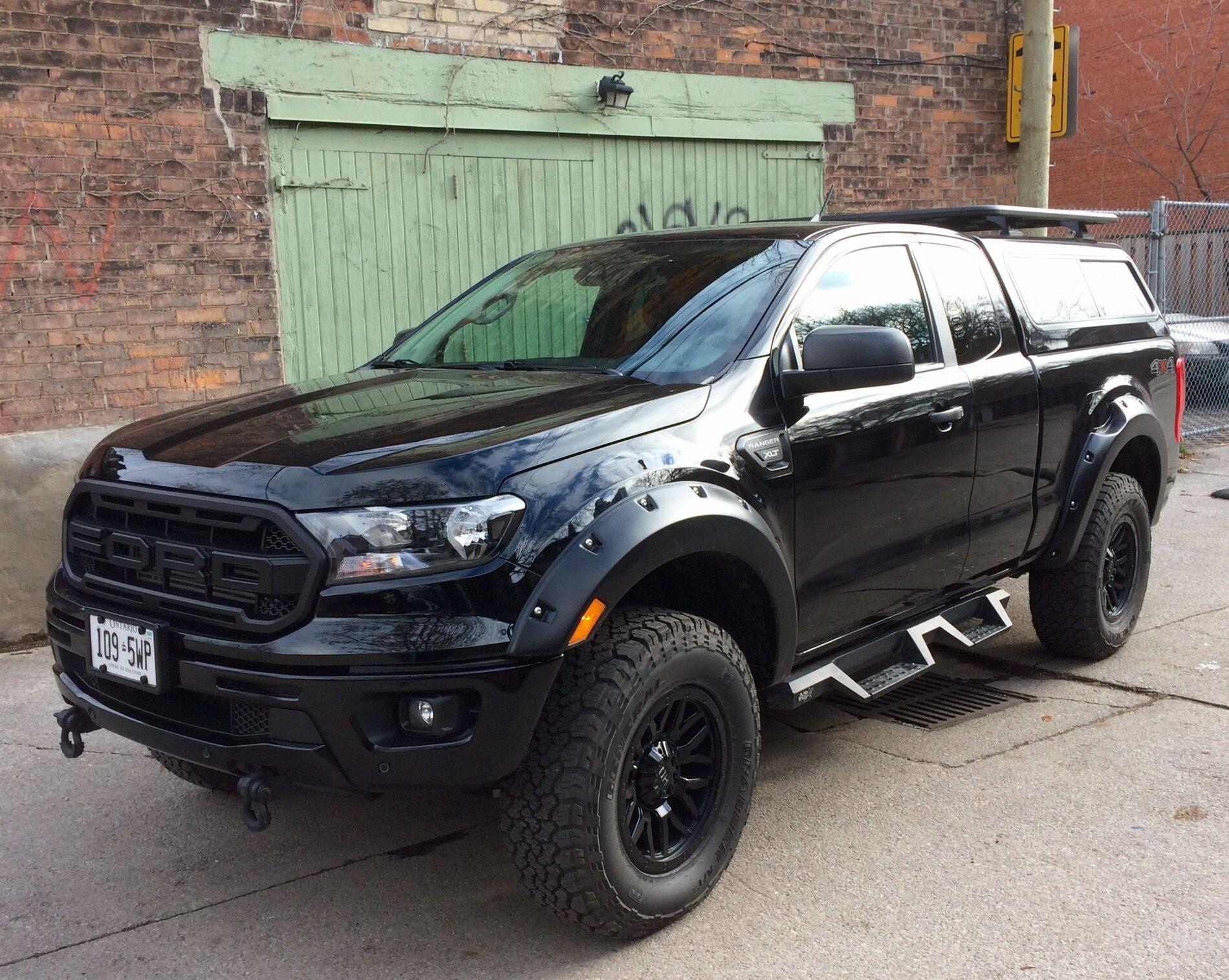

Please forgive the completely naive question...how Is it your new wheel/tire combo is further back than stock? I’m still learning about offset etc so I’m most likely missing something. Seems the stock wheels and the new wheels are both 17X8 with the only difference being 40 mm less offset in the new wheels. The new tires are 0.8 inches wider (0.4 inches (10.4 mm) either side of center). So if the center line of the wheel is moved out by 40 mm and the back edge of the tire is 10.4 mm further inboard than stock it seems you should have more room than the stock set up?
Also - 2” leveling kit and crash bars in tact?
Looks amazing - wish I had your mechanical skills, I’d likely kill myself trying to install a leveling kit!
Menace HD 17x8 +15mm Offset
These wheels have enough offset to allow 275s to more than clear the knuckle (actually further than the stock wheels) and push those tires out to just inside the fender Flares. Gloss Black for a Shadow Black Ranger.
Note...
No rubbing at full lock, no cutting, no trimming. I loosened and angled the intrusion bars and removed the plastic covers while the wheels were off.
FYI - Because people on these forums ask...
Before I installed the level kit, I put the wheels on the front just to see if they would clear the crash bars without the lift - they DO NOT and if you try it, they still won't. If you want 32s, level your Ranger.

General Grabber A/T X (275/70R17)
This is the main reason I levelled True North - the agessive stance of wider, taller tires. Wow, these Grabbers are a lot of tire - a full 32". My dealer couldn't get Falken Wildpeaks or BFG KO2s (back order) but I am more than impressed with the look of these big tires.

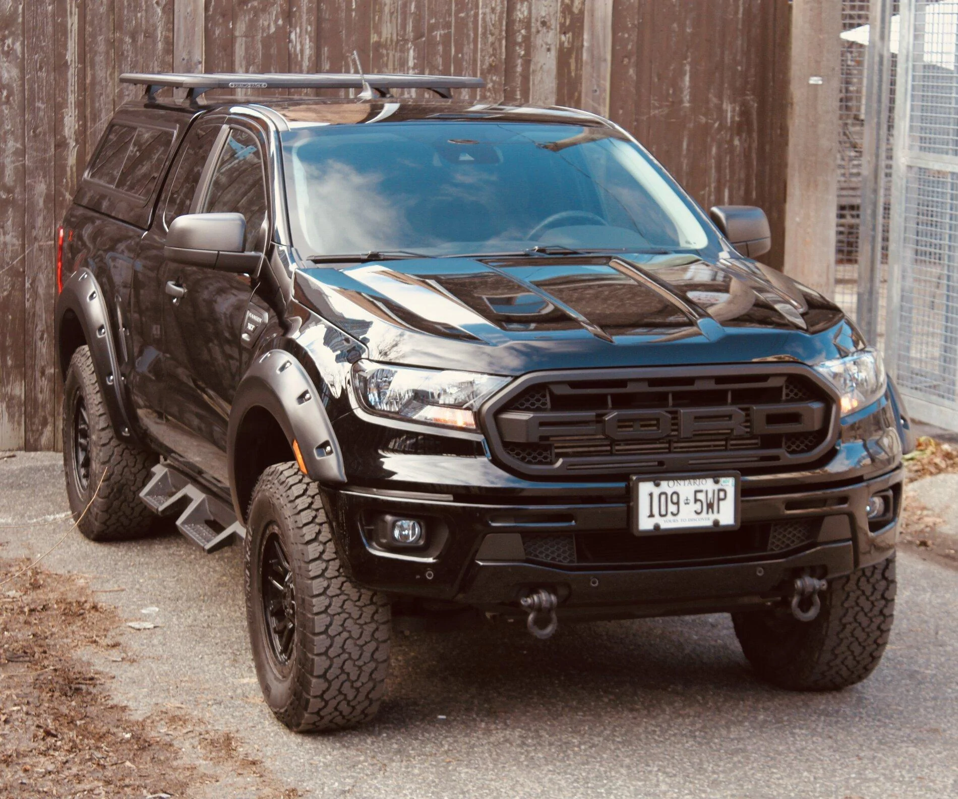

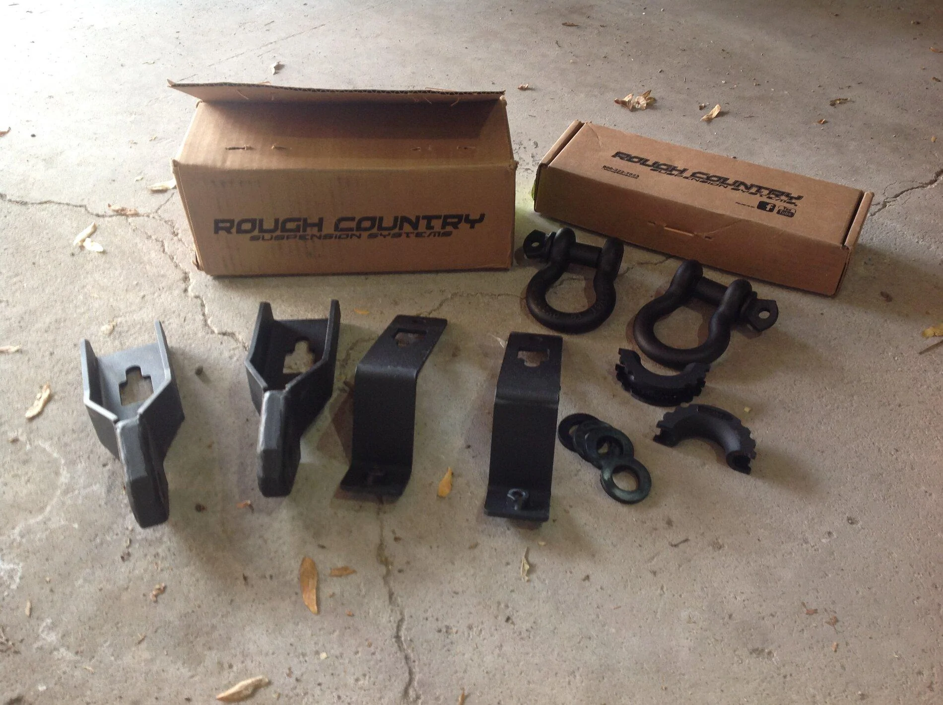

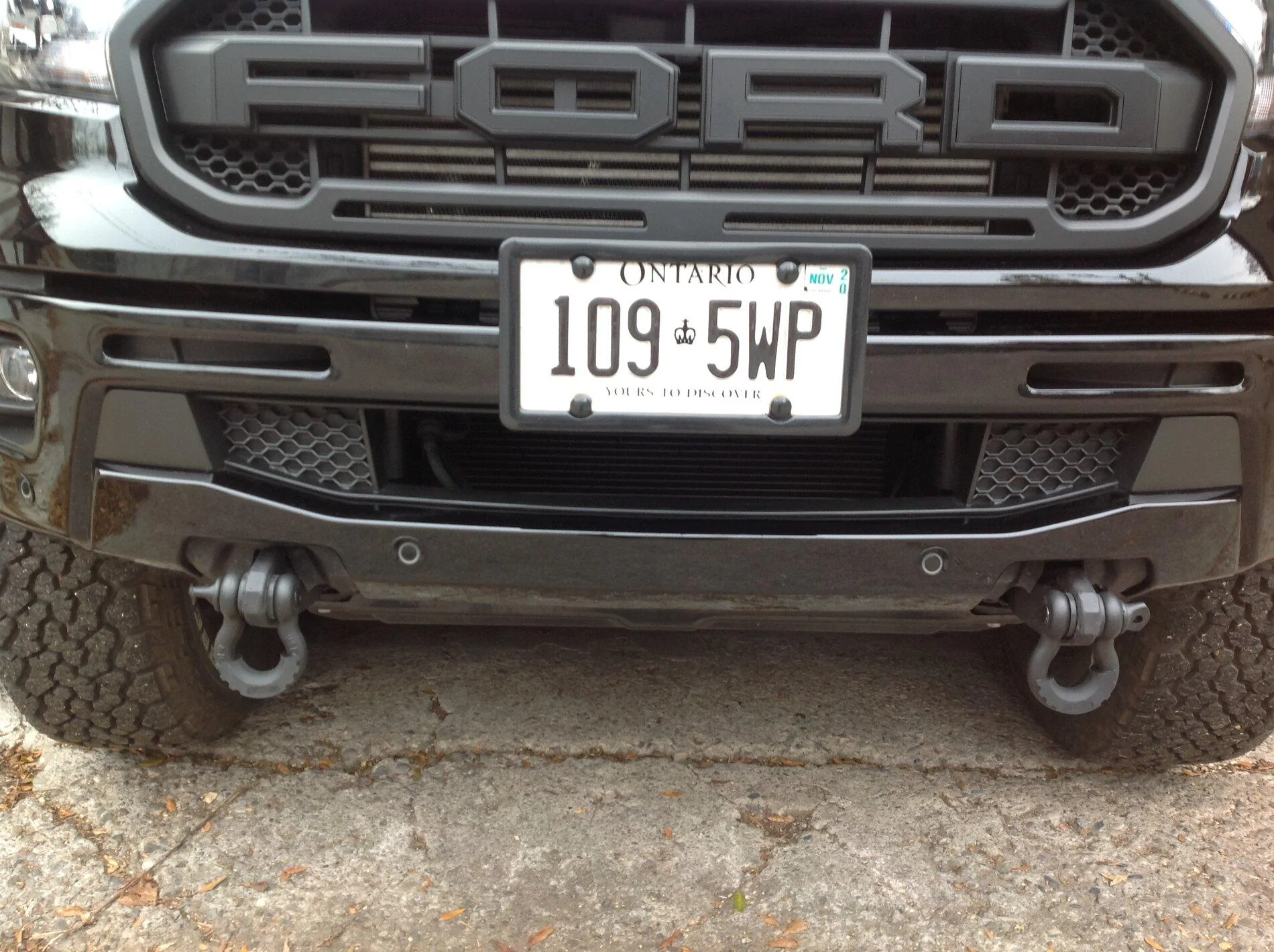

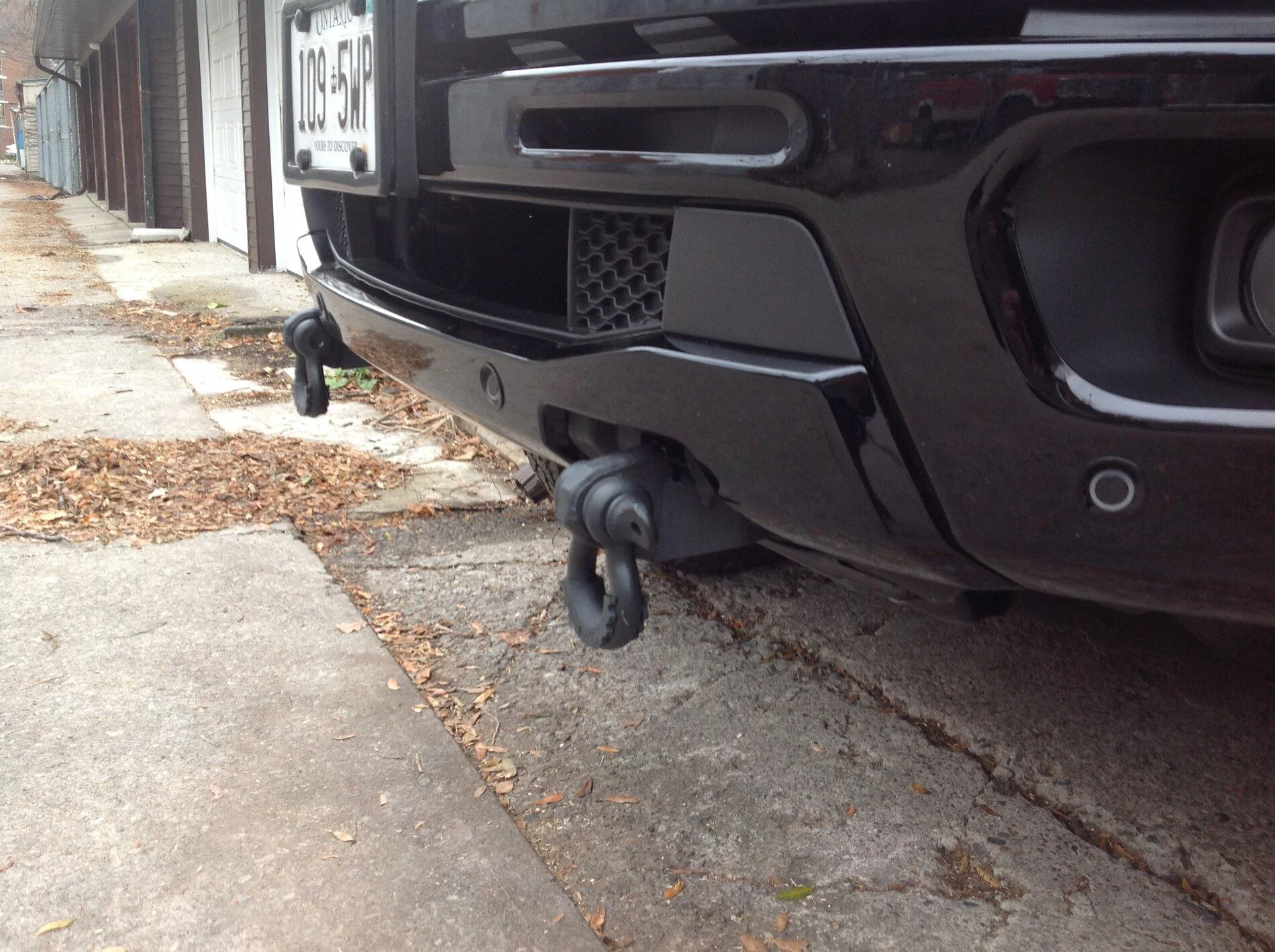

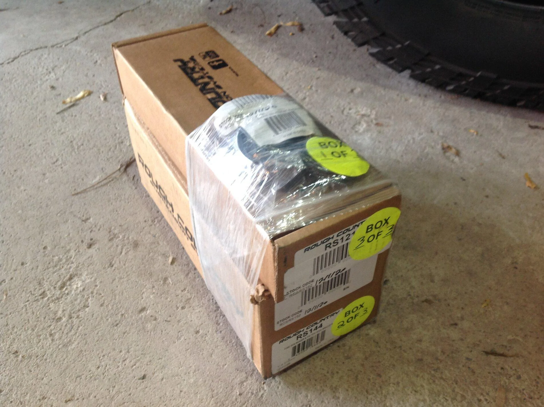

Rough Country Tow Hook/Shackle Conversion
Stepped outside to take out the trash and almost tripped over this delivery from TDOT Performance. I love it when the courier driver doesn't ring the bell or knock on the door. I mean, who doesn't love surprises?
Let's see how this goes...
It's a pretty straightforward removal and install. I don't like that you have to cut the old mud guards and I guess you could leave them off but the look suits the level and the bigger tires, so they're here to stay.
I think that completes the look I was after. Now, if we get some decent snow soon, I can take it out and play. Maybe I should just take a trip to the cottage where it's been piling up for a couple of weeks.

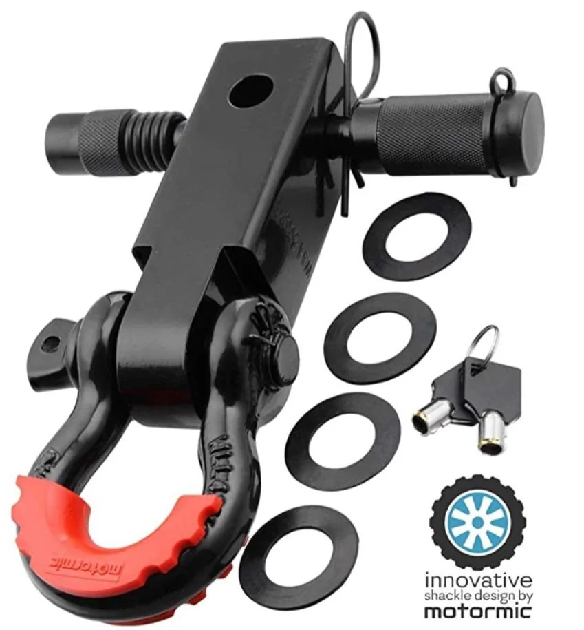

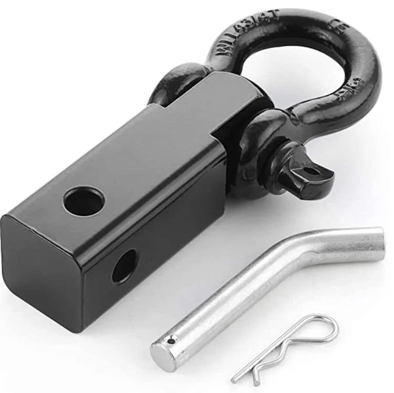

Amazon: OPENROAD 3/4 D Ring Shackle Receiver
Because I live in TO, I also bought a lock - it would be stolen on the first outing.
I also saw one on Amazon that includes a lock (Motormic UNIQUE Shackle Hitch Receiver) - I swear these all come from the same factory!
Happy shopping
