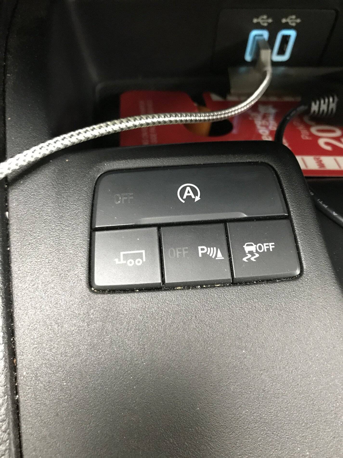

Might or might not be relevant......
My Ranger with the tow package has the tow/haul switch located on the console, which when engaged, changes the shift parameters of the tranny when towing.
I'm very familiar as my E-450 based motor home has this feature, and it works beautifully.
But, does the Ranger without the tow package also come with this as standard, or is it part of the tow package ? You owners without the tow package....does your Ranger have that switch ? Switch on the lower left side that looks like a trailer.
If not, this might be relevant to those just adding a hitch and plug.
