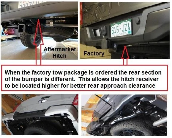

Thanks.. I've seen all those.
I was wondering if they updated the design to tuck it up tighter. It looks like an entry level kid designed it, the way it hangs down so low.
There is not a lot of room from where after market hitches bolt to and the bottom of the bumper. There is a completely different bumper for the factory towing option that moves it higher from the ground. Plus, factory is way more expensive than after market.

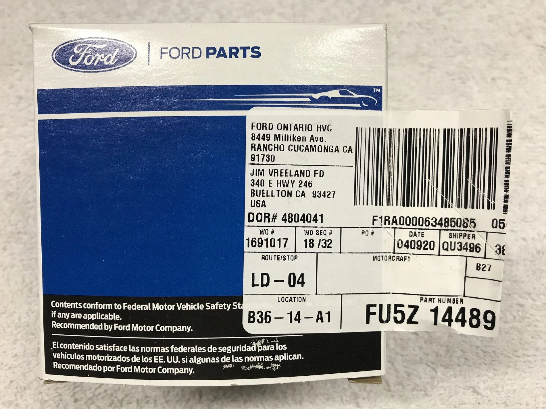

I have a new in the box factory trailer plug part number: Ford FU5Z-14489-A Sleeve-Wiring — SKU: fu5z14489a. Price: 40 bucks shipped to your door. If interested contact via e-mail: [email protected].
I already placed another order that hasn't shipped yet but the retailer hasn't cancelled yet either. If I get another cancellation I may take you up on that offer.

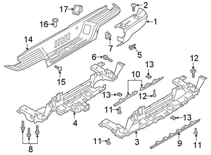

You can see the differences between the Tow Package (#4) and non tow package (#3)...I believe the Step Pad (#14) and the lower bumper cover spacer panel (tow package is #10, non is #9) are the differences I can find...excluding wiring harness, and 7 pin connector.

Yeah, buying factory parts after the vehicle is purchased is always pricey.
The tow package was $750 ordered with the truck. But you get the contoured bumper and the tight tuck hitch.
