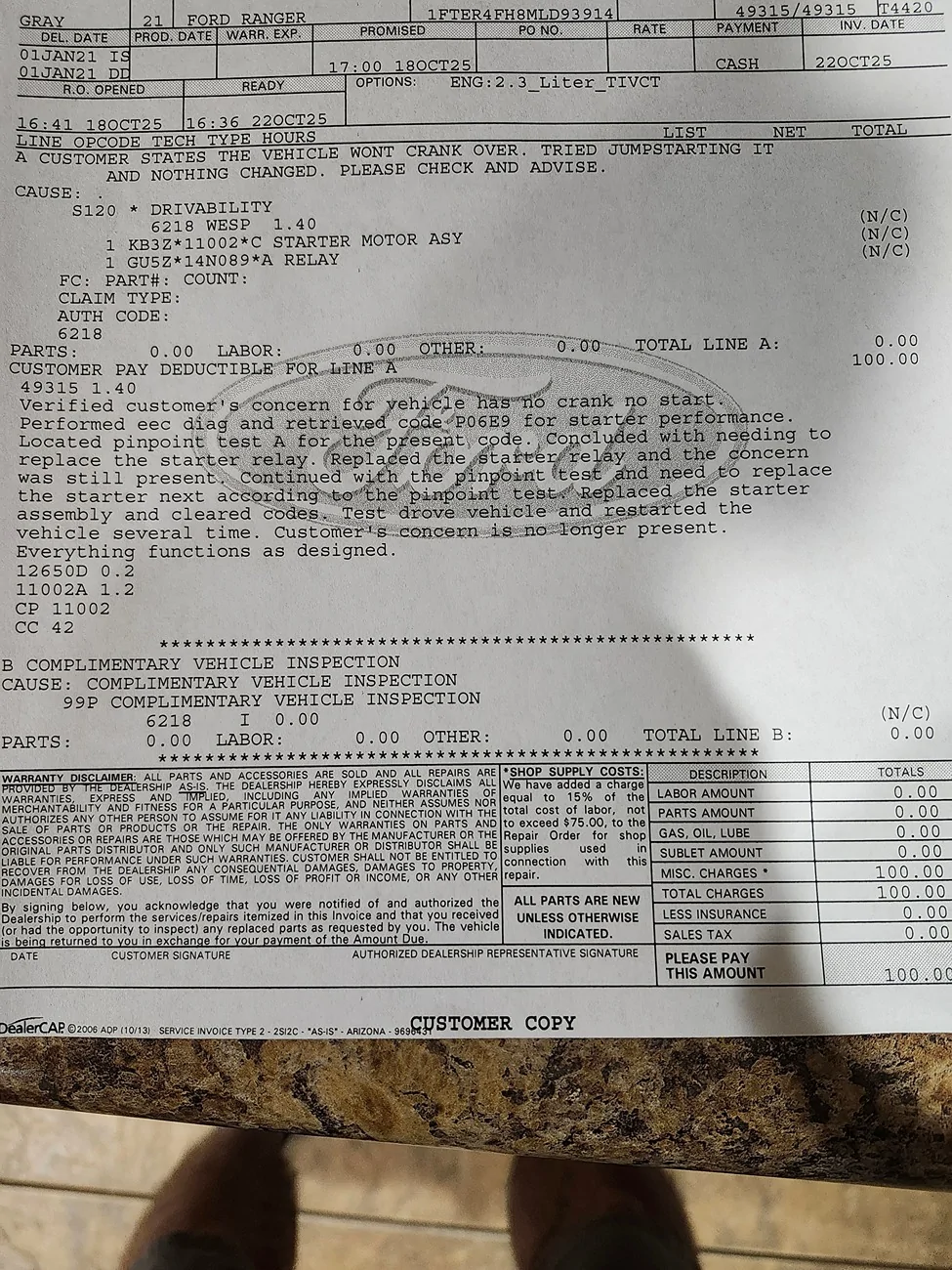

TRUCK just quit.

Ford Service says repair will be likely completed tomorrow. Ford Customer Service says I'm to submit rental paperwork when I pick it up so they can submit a claim for the rental I paid out of pocket for. So things are winding down. I'll post paperwork so we can all know what broke specifically.

Update:
We are home.
All is now right with the world!
Work order below for your reading pleasure..short and sweet.

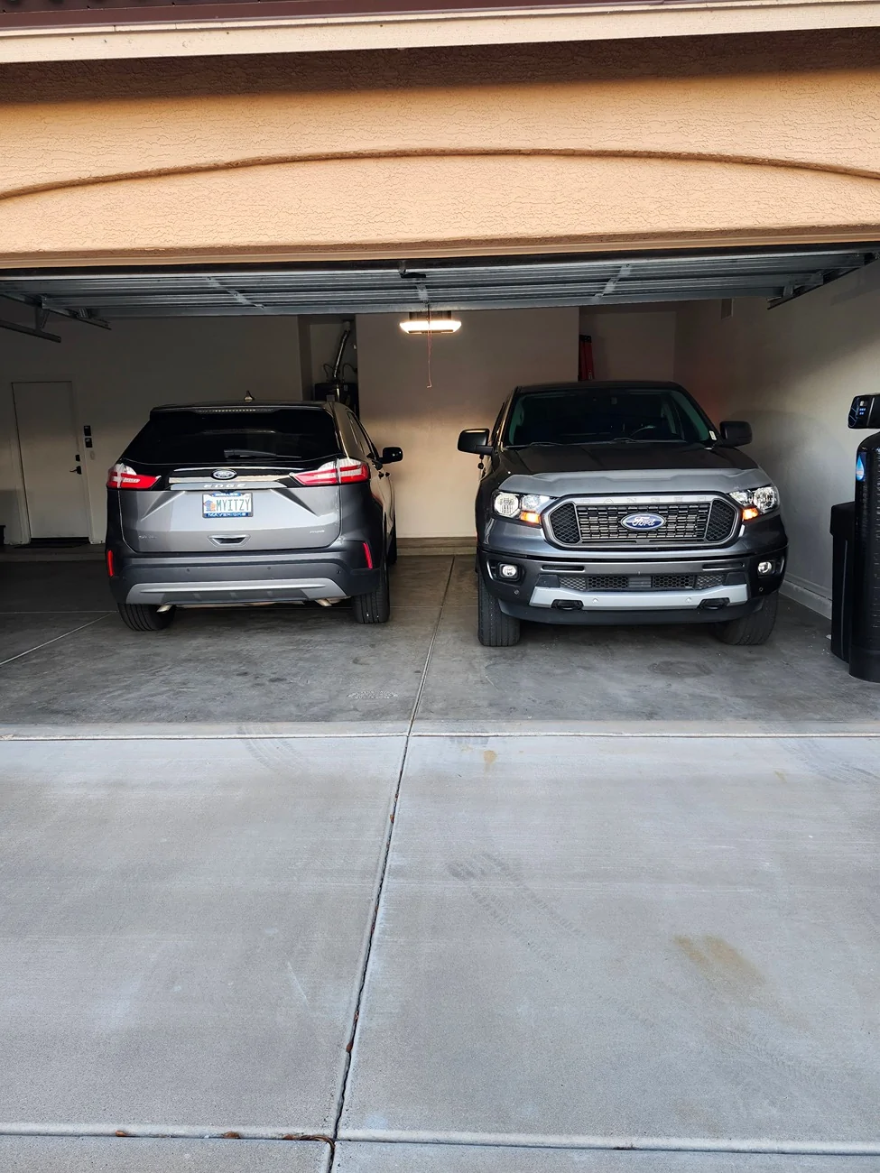

Great news! But I gotta ask, Does everyone crawl out the passenger door of the Ranger? Looks real close to the garage wall... :)
It is close, but not so close I can't get out. Door opens to the first notch and doesn't touch the wall. This is not my first choice of parking arrangements, but Jeanie doesn't like it when I park on the small side because the truck is right close to the laundry room door. She doesn't like parking the car on the small side because she stresses too much about hitting the doorframe wit the mirrors either backing in or out, and with good reason. Backing up with mirrors is NOT her strong suit. So we do it this way 😕

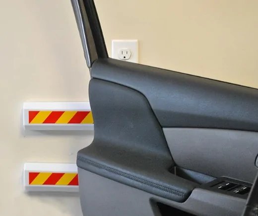

I get it! My wife did just what your bride was worried about while parking my 2005 Ranger, skinned the front bumper against the garage door frame. I do the same and installed these door jam guards to protect the garage walls and car doors.
I only put one 6' row up. Keeps the door off the brick foundation.
They do work!
