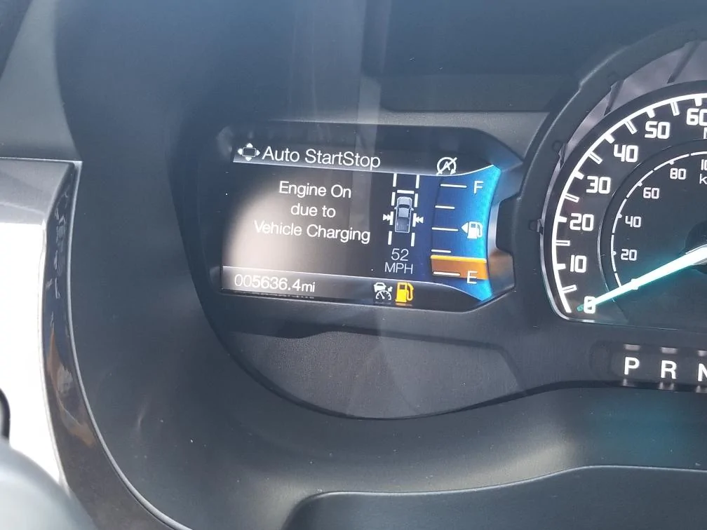

When you set info center to Auto Start/ Stop, the screen will tell you why the engine didn't stop.. I use it, and, I've seen Low Temp, HVAC, Engine Warming, Battery Charging, Steering .. (Something), Steering turned, and Wait for next Stop on my display.

Yes Thank you it is very touchy it started working again, but I feel like I'm in a time out, LOL don't move or else! excuse me but the whole concept is stupid, just my opinion.

Mine had not worked all week doing short 10 mile round trips...today after a 50 mile run, it started working again. So the battery must not have had the correct charge as indicated in the info screen.

I have found that if I come to a really smooth stop the system will not kill the engine. If I want it to work all I have to do is brake in a way that causes the truck to rock just a little bit. Works every time.

Hello,
Today on my drive to work I was stopped at a light, I slightly took my foot off the brake and the ASS tried to start the engine but it was a ROUGH start. Engine sounded like it wasn't firing on all cylinders. It eventually got going but there was some warning (Orange ASS symbol) that popped up for a split second with a message I couldn't read fast enough. Now In my fuel economy settings it shows ASS not available.
I do not believe this is battery related as I got the battery changed about 5 weeks ago. Also it does not say "battery charging "
Kept driving all seemed normal. Parked the car and turned it off and on and that was fine, but still not ASS.
Thoughts?
No CEL or error in Ford Pass yet

Thanks. Not entirely sure those answers apply in this situation. I'm pretty sure I met all conditions, plus the fuel economy gauge will tell you why ASS is not working at the moment but I am not getting any message there. Just says unavailable. Also ASS was working fine earlier on my drive.
