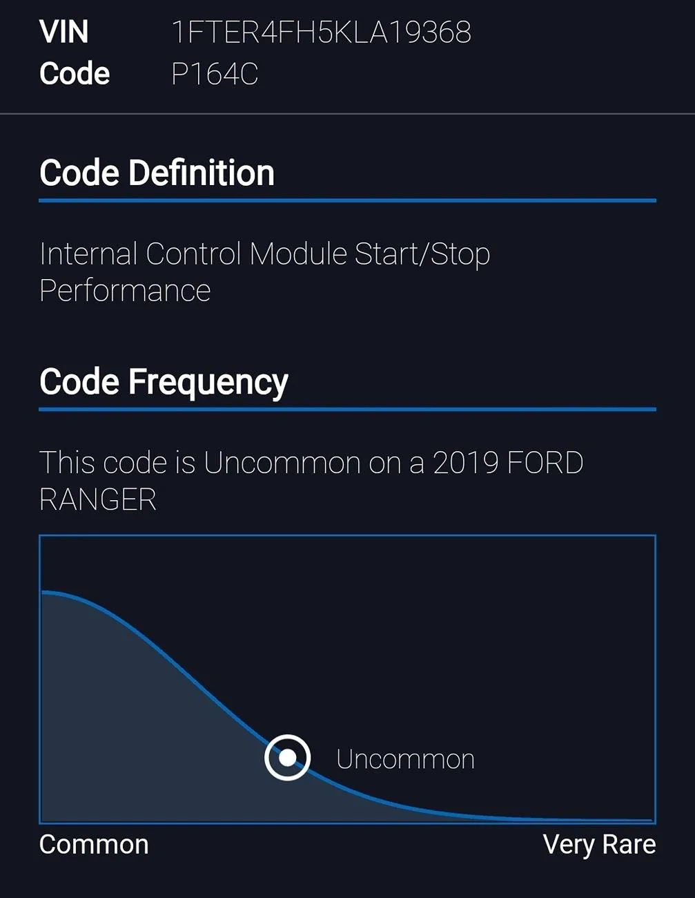

Scanned my truck and got this error code. Any thoughts?
I cleared the code but haven't gone on a drive yet.
That is a generic code, however I believe others have had that code pop up, and it is related to aftermarket air induction, I would dive it after clearing it and see what it does.
But you may want to check all the intake tubing connections and air filter. I can't remember exactly but I think someone with that code found a hose clamp not secured. (Unsure if this is the exact code)
But if it comes back, it may be worth it just to check your connections.
Basically, the manuals are vague for this code, but I believe the PCM triggered the code as the rough engine start as a (engine stall)
P164C - Internal Control Module Start-Stop Performance
Description:​
This DTC sets when an error occurs in the PCM.​
Possible Causes:​
  • Module programming error
  • Aftermarket performance products

Thanks. Yea this is my second Ranger I bought used, and from everything I see it all looks stock. 30k miles. When I took it to Ford to replace the battery they said they had no way to tell me if it's tuned....
I'll try driving home after work and see if I get any more issues.
