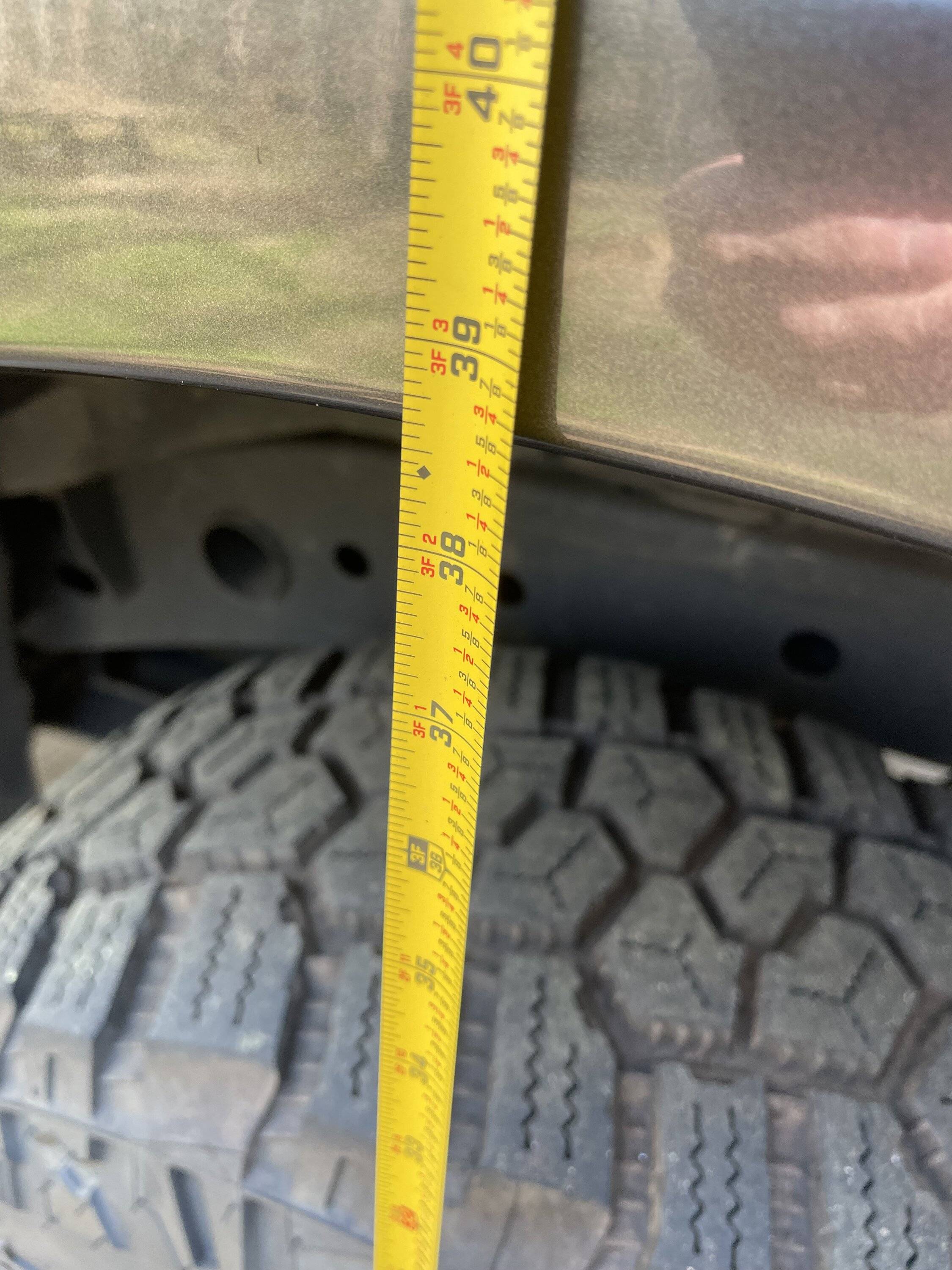

Bringing this post back from the dead. I did this swap last night and it increased the ride height so it is 39.5 inches from ground to wheel well. It’s riding about 3 inches higher than the front now. I torqued everything to spec so I am assuming a few miles will get it back down?
80
6,955
42,465
Living The Dream
That's 3/4 inch higher than mine.
Maybe it will come down when they settle in.
Mine have been installed for a few thousand miles now so I'll go out and measure them today.
Edit: This is today. They have settled a little bit but only around 1/8th of an inch. And this is with a full tank of gas so some of thesettling could be from that.
Are you measuring the driver or passenger side?
Even though the shim is only on the driver side, the passenger side sits slightly higher, around 3/8 of an inch with a full tank of gas.
That’s about what my stock tremor was at height wise.
SDXLT
Josh
Dec 30, 2022
325
615
San Diego
2021 XLT FX4
I dropped the kids off at school and remeasured and they have already settled almost 1/4”. I may throw some boxes of tile I have in the back and hit the $hitty roads and see if that helps. I have Eibach’s to put in the front to level it but was surprised how low the front is sitting now.
