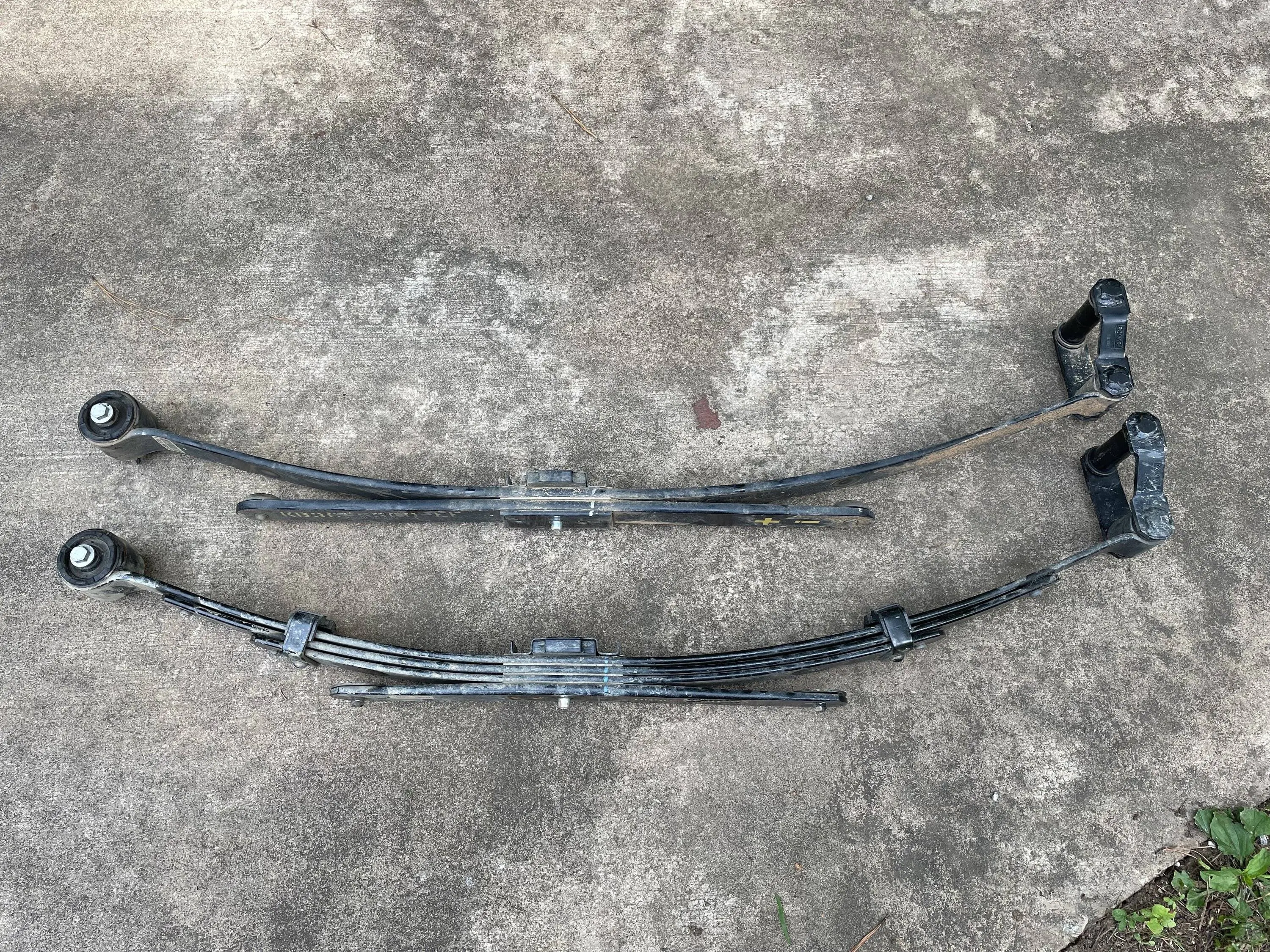

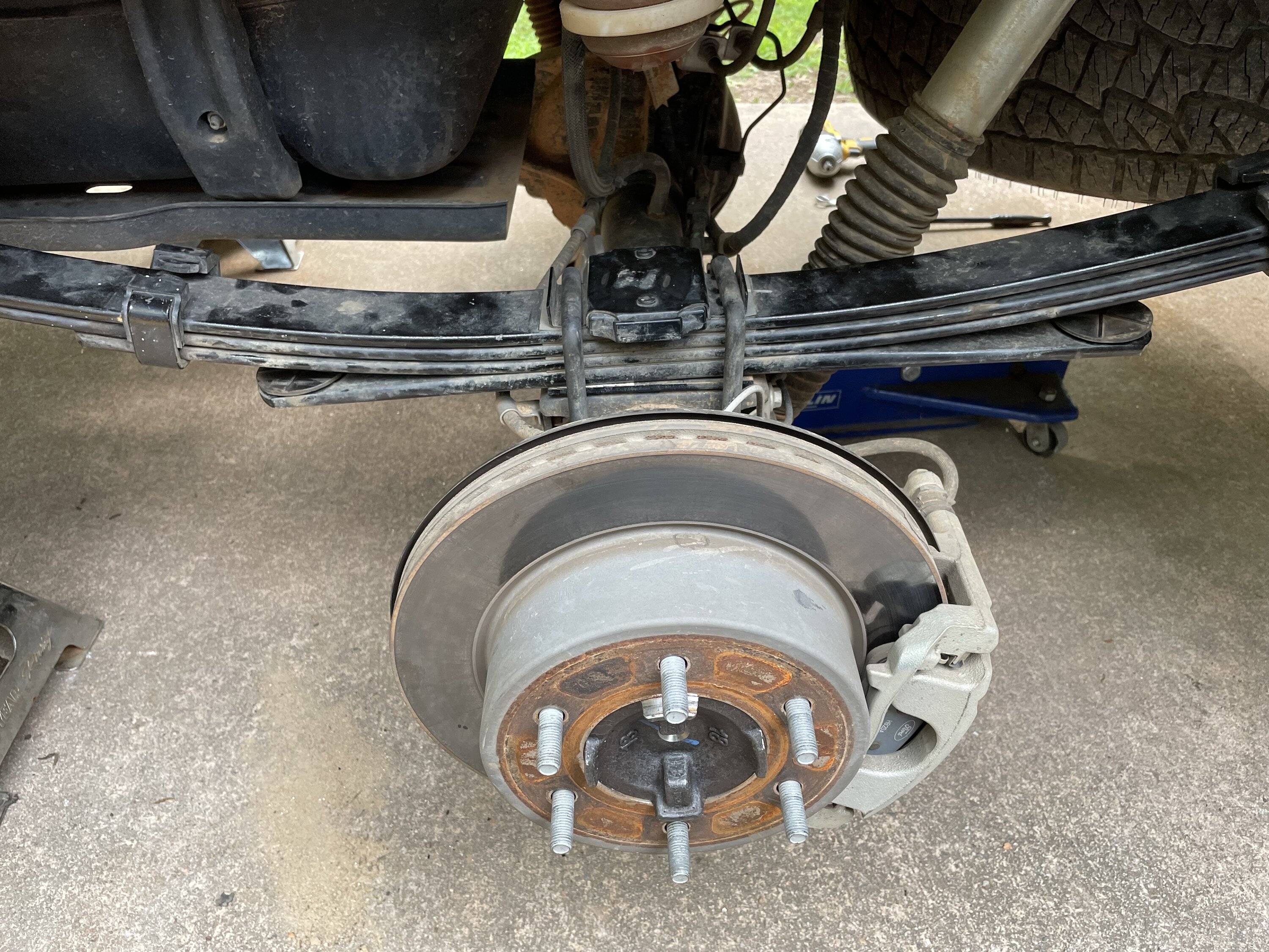

So I swapped out my standard leafs today for a set of Tremor leafs.
You'll need 18 and 21mm sockets and a torque wrench. You may also need a 21mm box end wrench for the front mounting bolt.
Use your head and use jackstands of course
A few notes:
Driver side leaf has a shim. Passenger side does not.
The Tremor leaf pack is heavier and taller. Remember that when you go to install it as even though you may have had enough clearance to remove the factory leaf, the Tremor leaf will need more room.

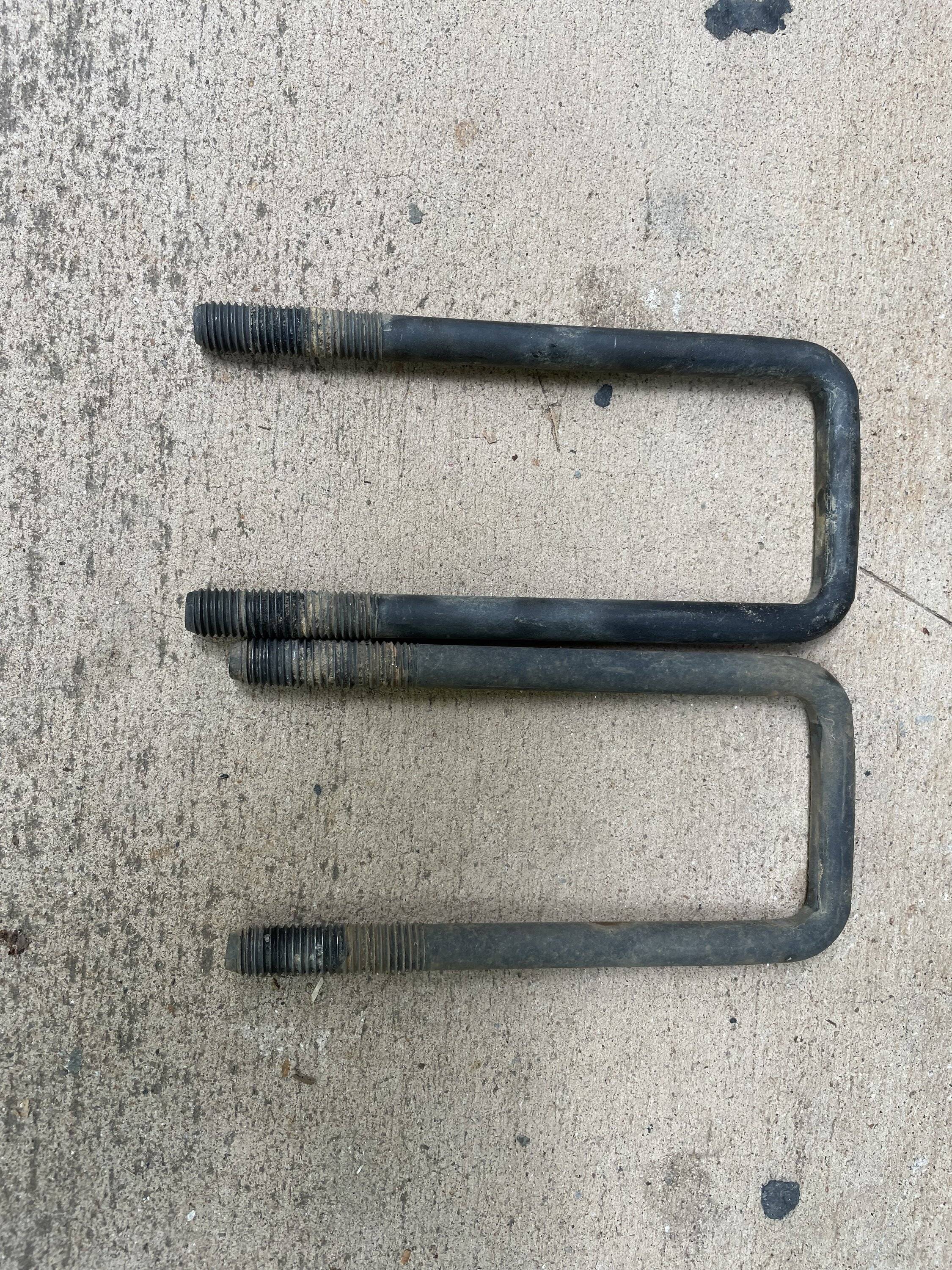

The Tremor U bolts are longer and the shackles have a different part number than the FX4 shackles so I used the Tremor units.
Tremor U-bolts vs FX4

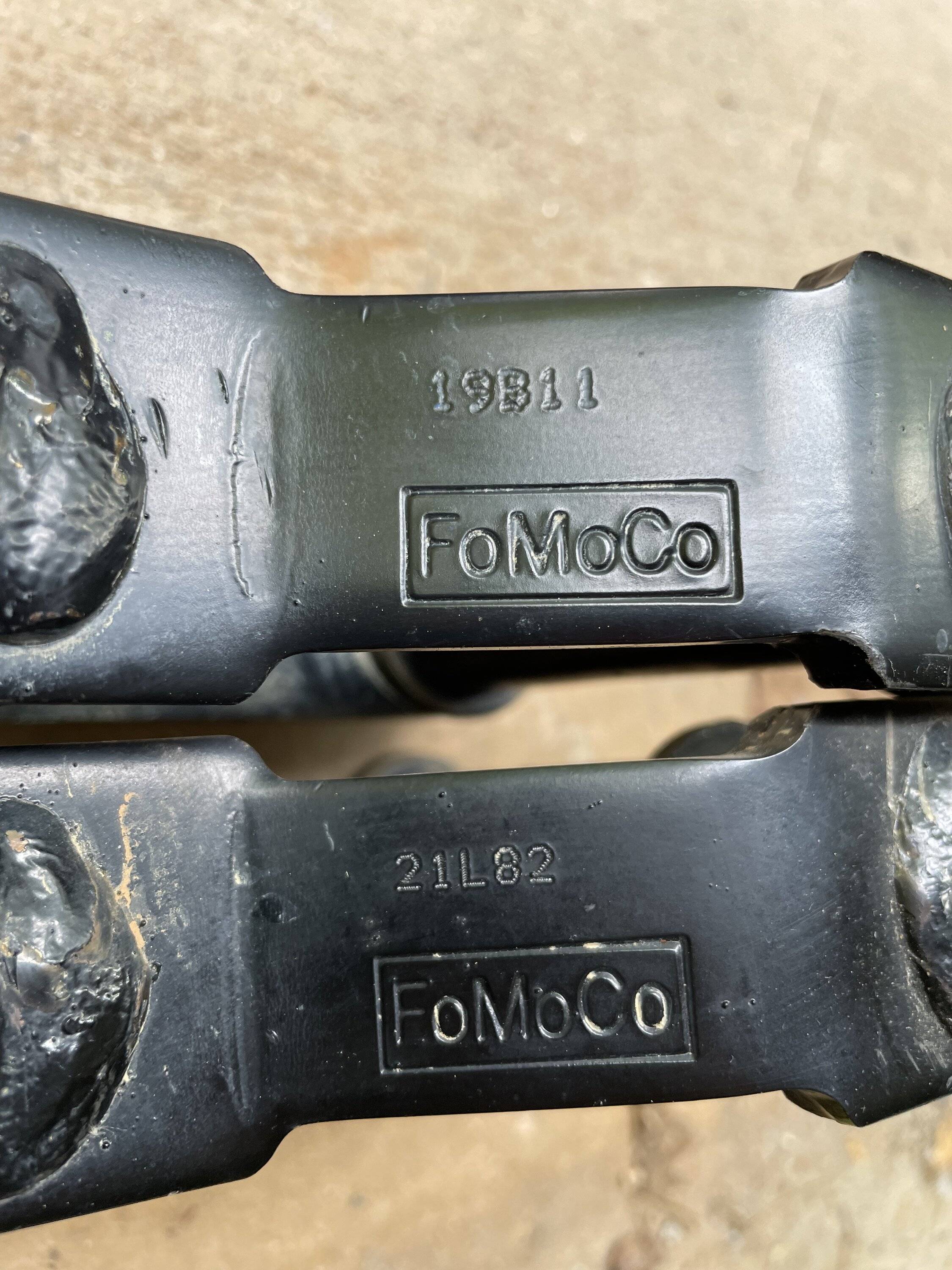

Tremor shackles vs FX4. Tremors on top (19B11)

It didn't raise the rear at all. It measured the same before and after.
However, when you're working with the leafs you can feel that the multileaf pack is more compliant. You're able to bend it more to line things up than the monoleaf could be bent.
Kind of surprised me because before install I sat them both on the concrete and pushed down on the leaf packs and they felt very similar.
It wasn't until I was lining up the rear shackels that I notice how much more compliant they were.

I know it hard to tell but are the Tremor shackles longer than the FX4 ones? Looks a little like it in the picture. Did you measure them?
I did not measure them but I will tomorrow.

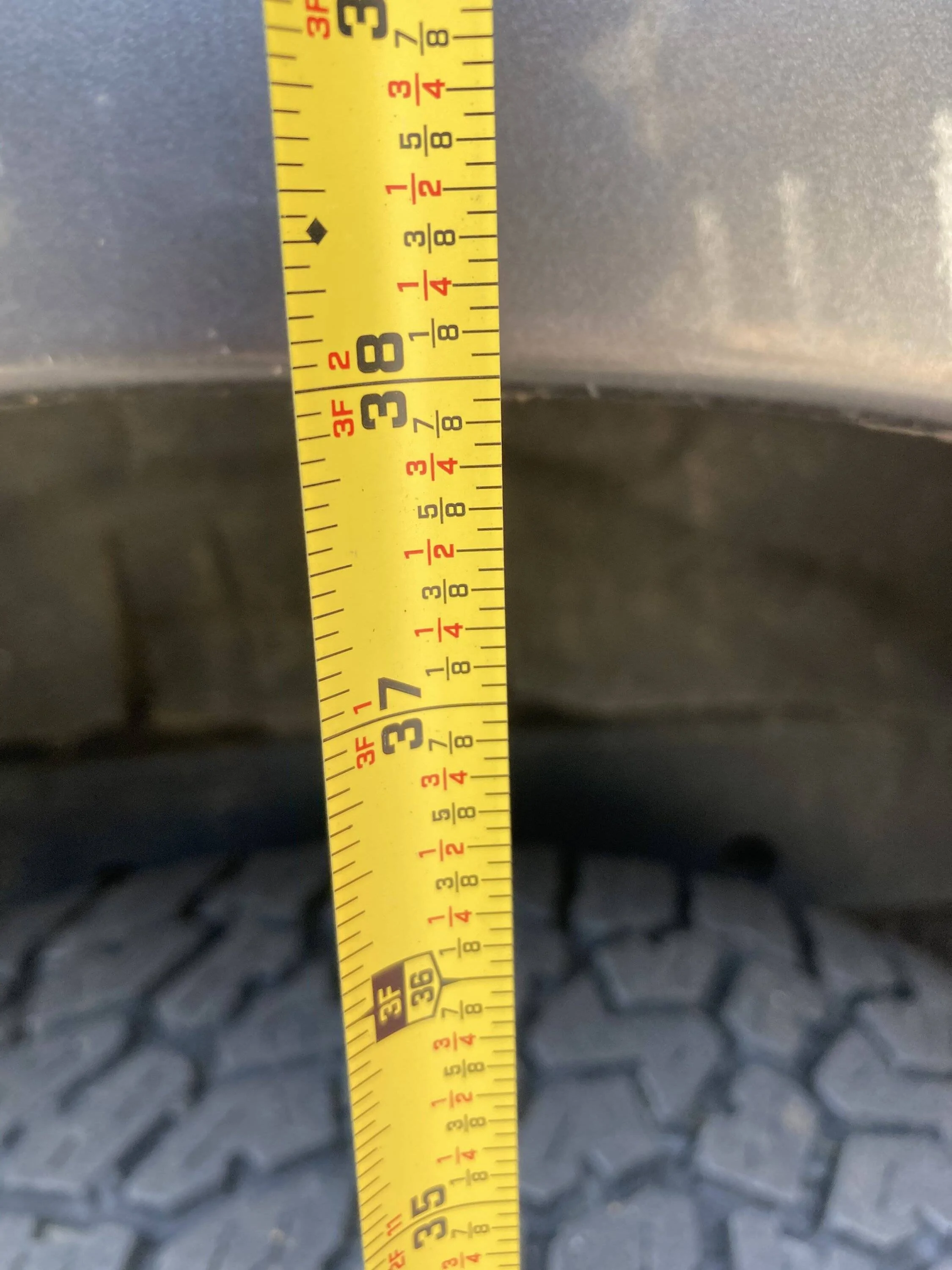

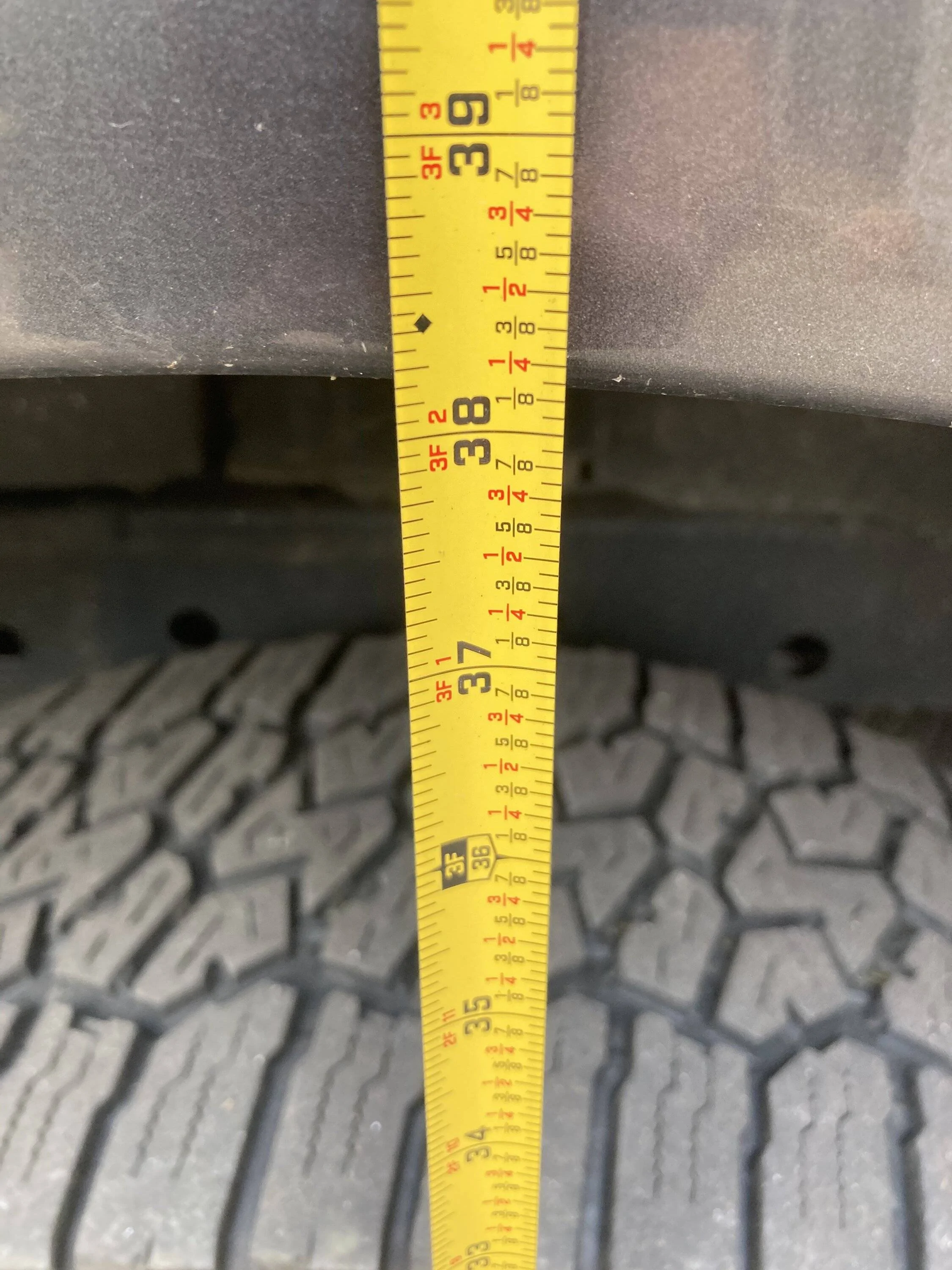

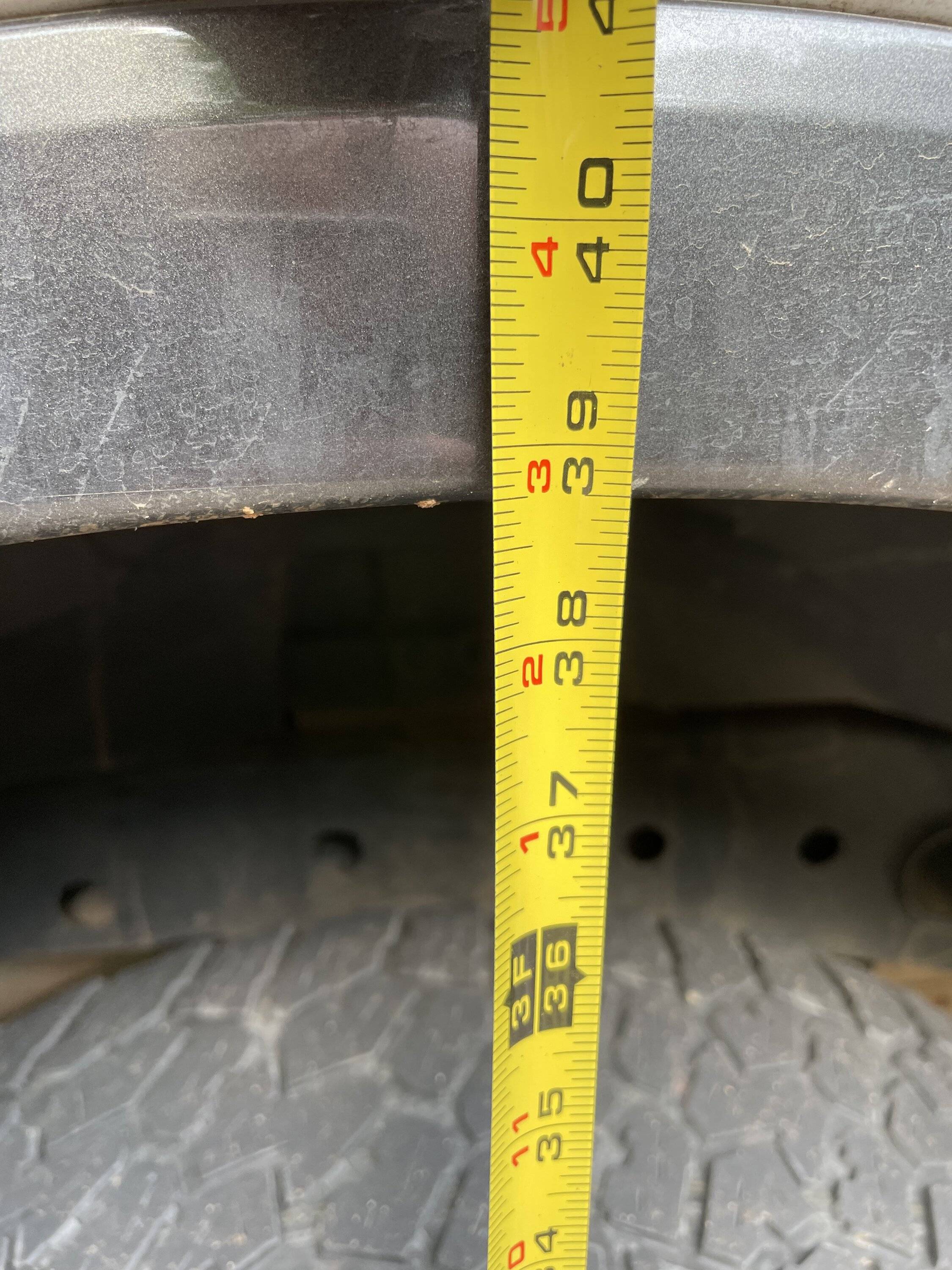

Interesting I've always heard that the Tremor leafs provide half an inch of height.
EDIT: OP confirmed he gained half an inch of height in the rear with the Tremor leafs.
62
4,798
28,197
GA
After putting some miles on them, it looks like I did gain about 1/2 inch in lift.
I also measured the shackles and they are identical in length to the FX4 shackles.
