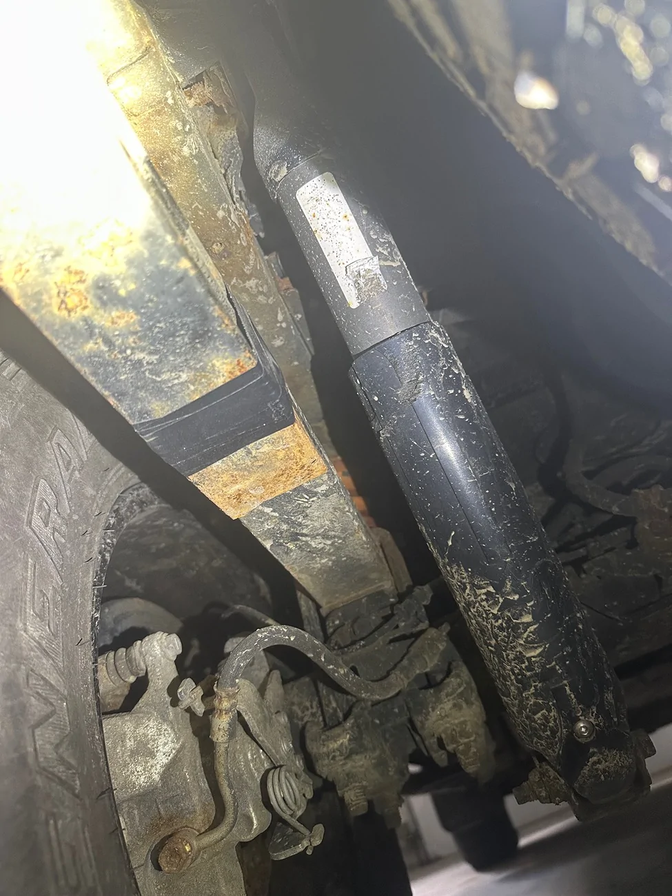

I have a broken leaf spring on the driver's side of my 2021 Tremor with 69k miles. Seems it would be best to replace both sides and possibly look at aftermarket options. Looking for some advice here.
My truck has an ARE CX Revo fiberglass cap with Prinsu rack and White Knuckle rock sliders. Not sure what the combined weight of those items comes to, maybe around 300lbs according to Google
OME (Old Man EMU/ARB)- Seems a lot of people here are running this kit. Can I use these with the Fox shocks that came on with my Tremor package? Any concerns with the ride height considering the +300lb weight?
OEM - Should I just replace with the stock (Tremor) springs or would it behoove me not to upgrade at this opportunity?

This is the first I've seen on here of the Tremor spring breaking.
There have been several reports of the monoleaf breaking.
That said, you can likely get a pair of aftermarket springs for not much more than a single spring from Ford.

Do you have photo's were it broke?

69k hard miles. No extreme off road or trails but a lot of class VI roads and winter miles. Road salt has taken its toll, even though it’s been undercoated.
Tha sucks. Regardless of life, still seems too “young” to me for a broken leaf spring.
