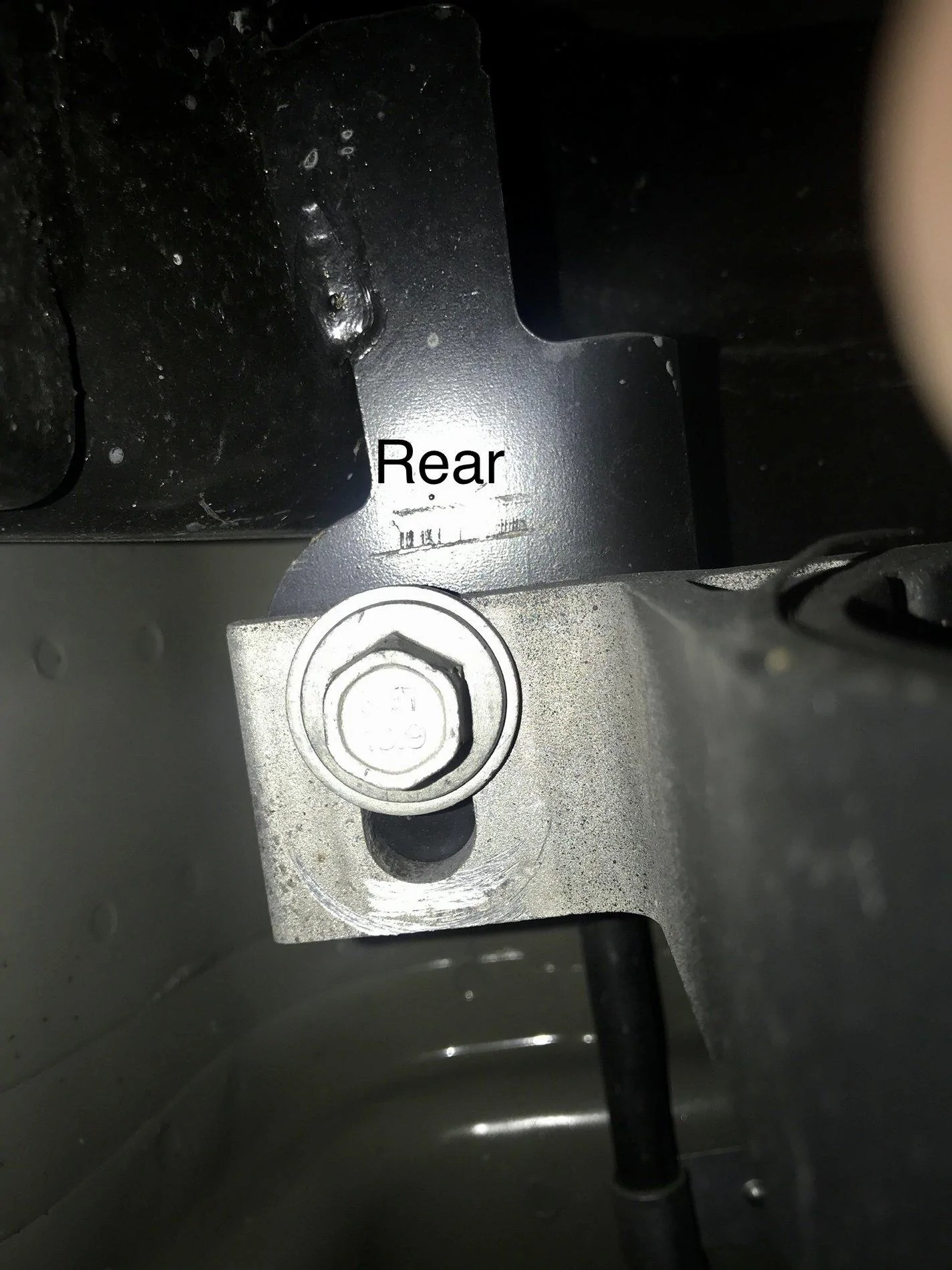

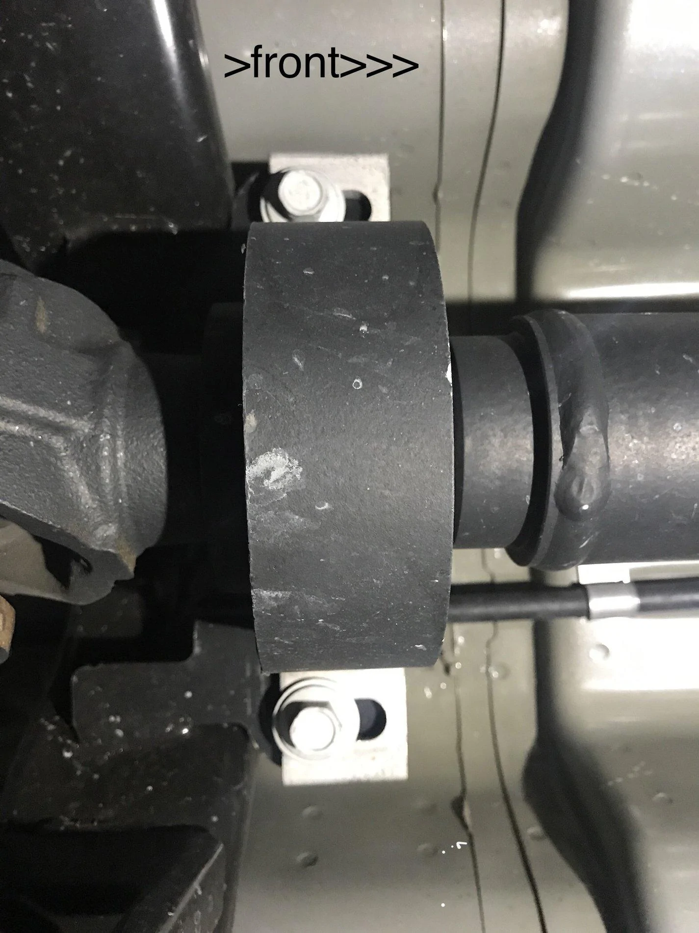

I loosened my bearing yoke (15mm bolt) which was not very tight and nothing appeared to be in a bind. There was no slack fwd or aft. I then jumped up and down on the tailgate with engine off and in neutral. With the engine on, sitting still i shifted into all gears. Wasn’t sure about driving or rolling while it was loose.
Retighten yoke.
The jury is still out if this made any difference. It did feel better in my short test drive but every time I make a change it feels better but then shows up again.
What was strange was markings on the yoke. It looks like the bolts were tightened in another position at one time, perhaps during partial assembly going down the line, don’t know but I could not move it back into the more rearward position
