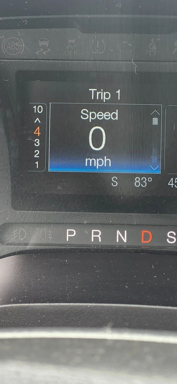

This is my wifes 2021 xlt 2.3 She drives like grandma well she is one
I drive here truck and it is shifting bad . It has a big pause between shifts or even skips a gear

Skipping gears is normal in drive mode. It is programmed to do that. In sport mode, it doesn't skip gears.

that truck does not have a sport mode . Just tow haul It shifts the same in tow also

You might have that option with the Lariat This is a XLT

If you have manual shifting with the buttons. That is sport mode. And it should not skip gears in tow mode.

Shouldn't matter. Have you looked at the shifter to see?
Okay just went out and looked It does have a S I never looked.
I took it for a drive in S something is not right I takes off in 1st then goes in neutral won't shift for a long time Then shifts I come to a stop and it starts out in 3rd ? Even if I push the - button to 1st it is still in 3rd ?
