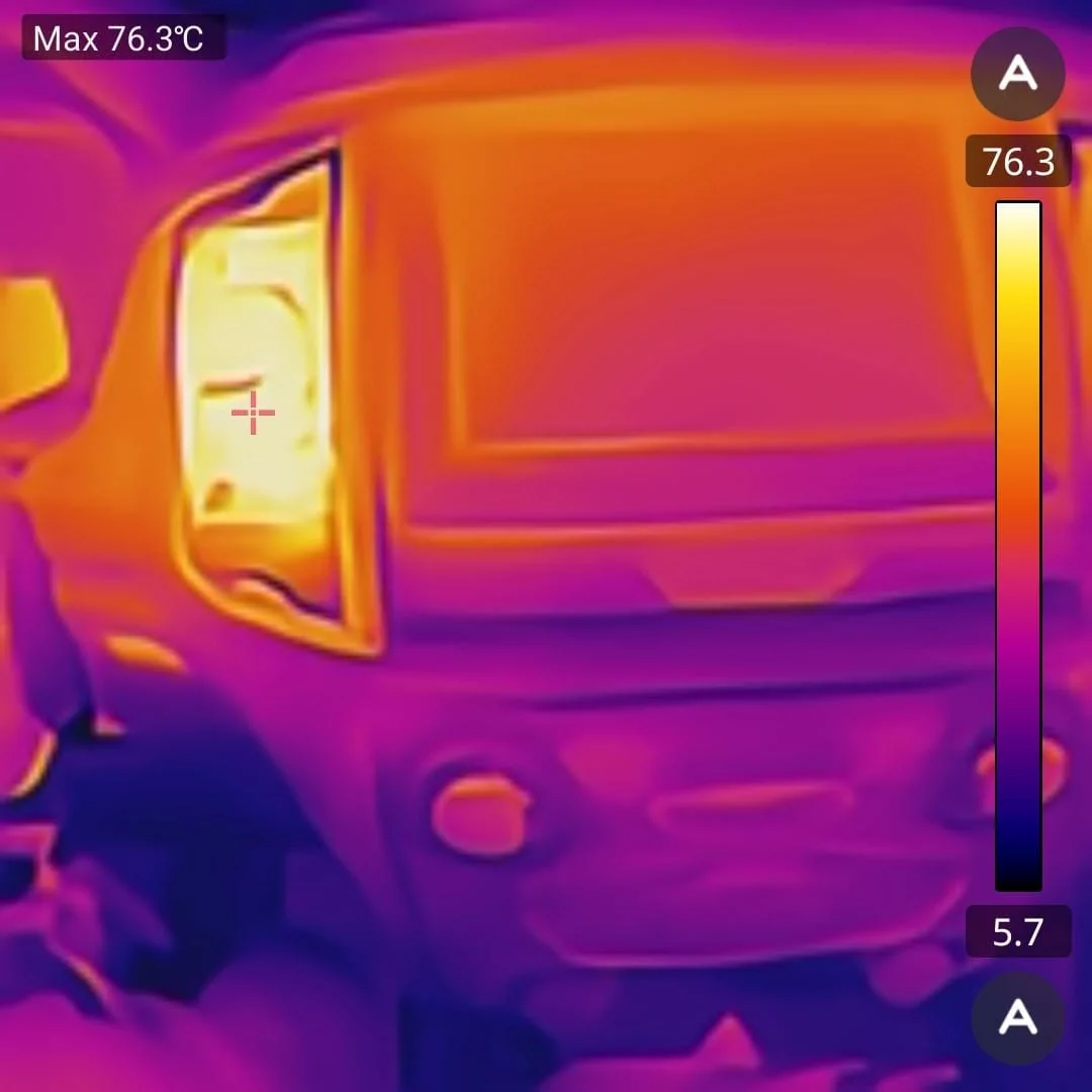

Thermal camera of Dash, its hot before I hit the end of the driveway, even if I only idle it a Min.
after these pictures I figured out in the settings how to change it to F LOL
Its the goyojo its not as clear as I want

I’m not gonna lie, when I first saw the image I thought for sure you were gonna say you didn’t drive away until you saw what you liked on the thermal cam. As in, every start up every time.
I would’ve been both horrified and impressed at the same time.
I havent even used it yet to look at the engine or under it
Im still sitting in the driveway waiting for it to warm up hahahaha
