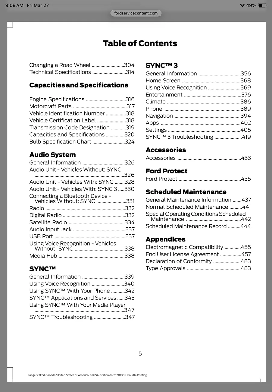

The answer actually brings conflicting data:
Owner's Manual = 23.67 fl oz's
Service Manual = 1.20 qts or 1.13 lit - and yet another states 1.20 lit
So bottom line = Fill to Spill and have about 1.5 qts (ready)

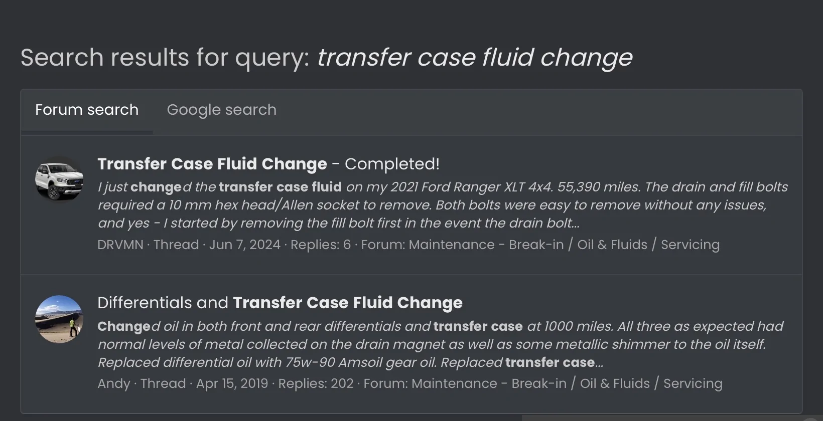

Thank you thats what i was looking for but could not find it in search
