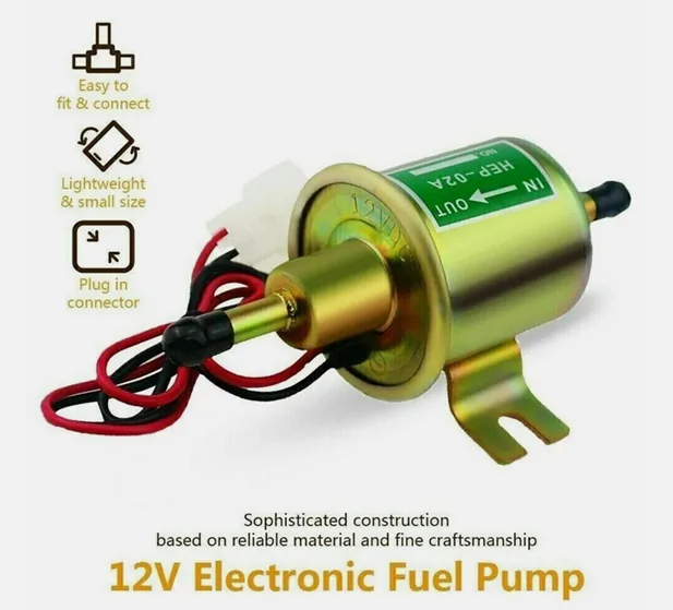

Here is what I did on my tranny fluid change at ~36000 mi.:
1. Got everything up to operating temperature.
2. Obtained a little fuel pump, a "brrrrrp" type" shown here below.
+ 1/4" i.d. PVC tubing was used. ~72 "+/- long and ran one end into the trans.
+ The pump had enough "guts" for suction lift - about 3ft. and discharged into milk jugs.
3. All most all of the tranny fluid was pumped out and into 2 clean, dry milk jugs.
4. After the pan was pulled, the little bit of remaining tranny fluid was added to one of the jugs and then the levels were marked.
5. The pan and the magnet were cleaned, filter was not changed, but inspected. All was good there.
+ Fluid was fairly clean. No metal particles or debris visible on filter paper.
6. Pan was reinstalled with the original gasket. (When the truck hits 60K miles then I'll change the
filter.)
7. New tranny fluid was poured into the now empty, marked milk jugs to the same level. It was
pumped back into the trans. Fluid hit the right level after it was all warmed up.
8. Fluid level was checked after 1/2 hr run time. All was OK.
9. At 40 K Miles, all is OK
Semper Fi,
B
