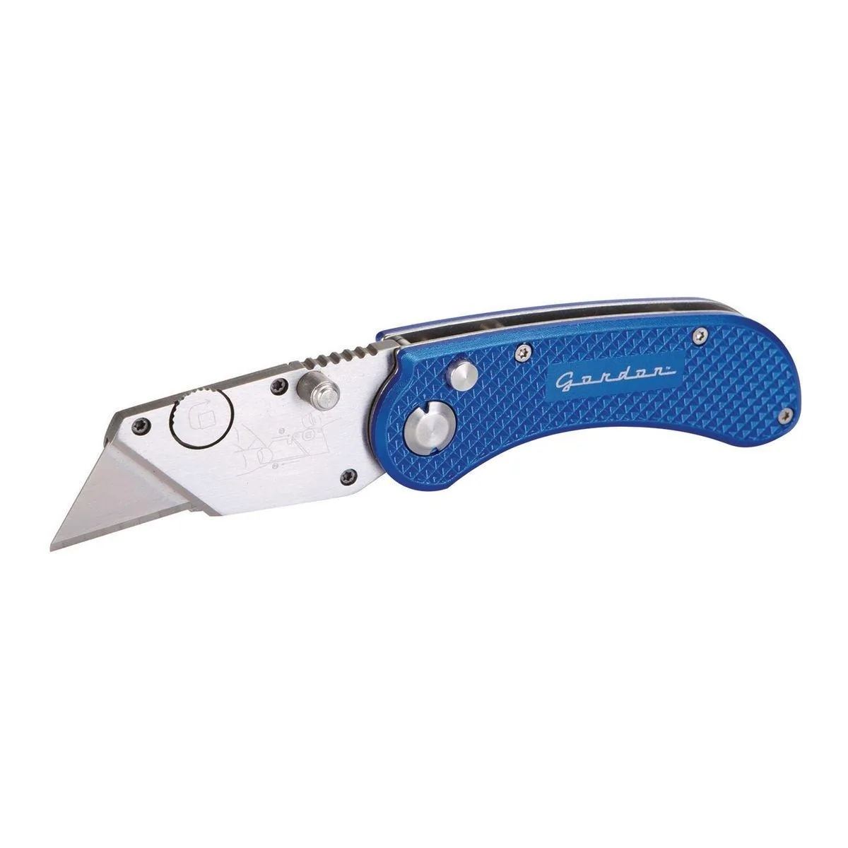

I heated up a utility knife with a propane torch and cut along the outline, and then finished it up with a file..What did you guys use to cut out the plastic blank in the bumper where the plug housing is installed??

About 8 posts up, someone recommends a hot utility knife (heated by propane torch).Best way to cut out the knockout in rear bumper plastic for the ford 4/7 pin connector??? See everyone adding the hitch, wiring pigtail, and connector but no suggestions on cutting out the plastic from the bumper.
I see. What has everyone else used? Is a knife the best option?A
