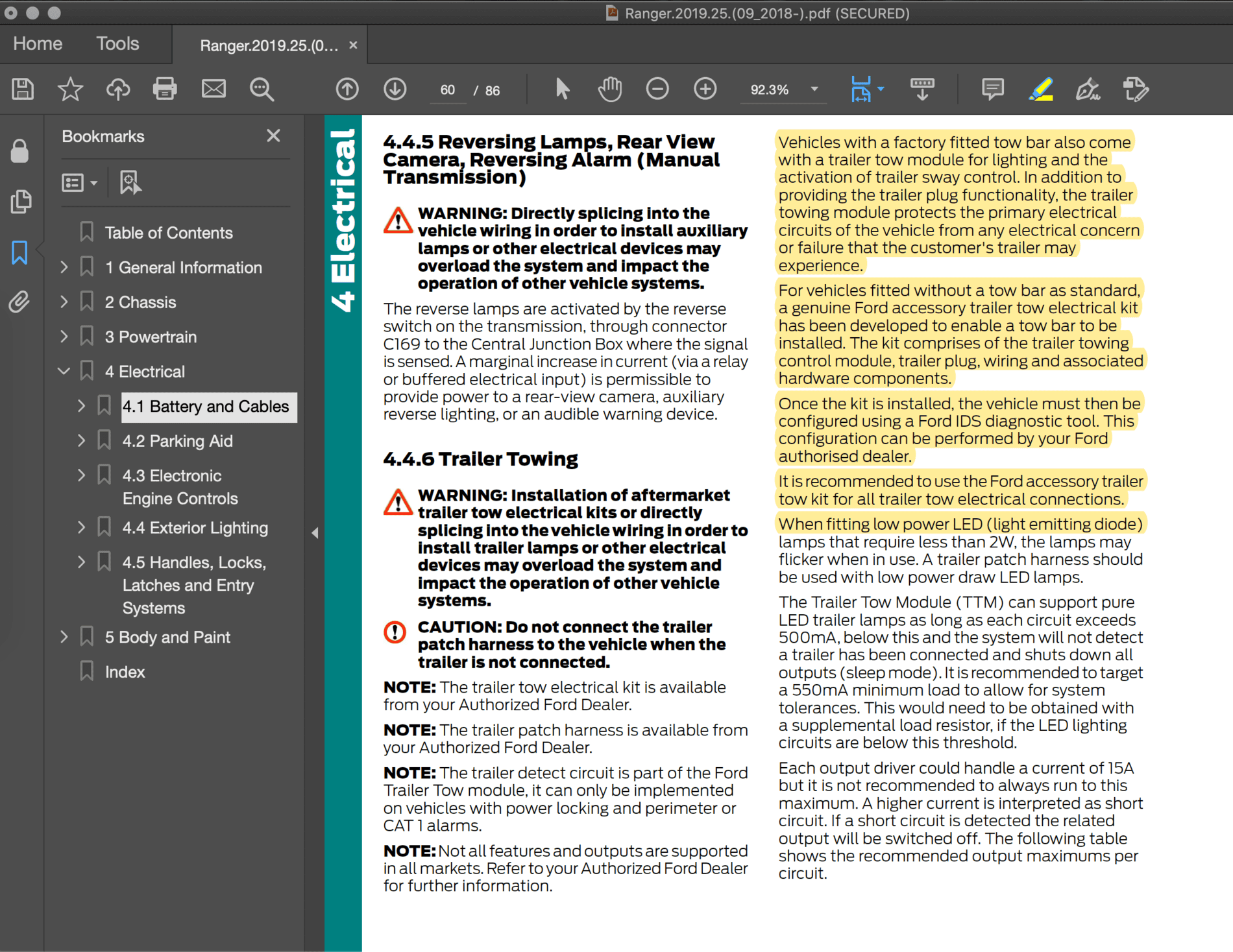

After literally hours of scouring fords website and literature downloaded based on my vin I believe my work here is complete. IF and I say IF this wiring kit should make any non 53R ranger able to talk to a TBC without doing a hackjob on a new truck. Ordered the redarc and the 30 amp kit now that I am satisfied the lack of pigtails is a non issue. Ford just wanted to sell XL owners a .17 cent connector and .50 cents of wire for 32$ lesson learned for next truck.
So all in all it would've just been easier to order a 53R equipped truck or at least an XLT.

What is that pdf document?
I can email it to you when I get home to my laptop tomorrow. Email me at my username @ gmail.com

I ran all external wires on mine as a quick fix. Worked excellent from Georgia to Washington state. After I find a house ill rip these wires out and have a dealer install those pig tails and control module in the truck. Gbritt89 I'm glad you posted that document and part number. As far as the trip goes, I towed a 22ft enclosed trailer with a 69 fairlane cobra, tools and luggage. I am estimating my load to weigh between 6700-7k lbs. I had zero issues the entire way here. Brakes worked soo damn good. Driving with the sway control on makes it feel like a planted truck at speed. I felt like it was cheating. Sway control mode is awesome, only issue i had with it was holding on to 3rd gear too long when merging onto highways. I also ran into 6% grades through 4 or 5 states and the engine braking takes probably half the braking load. I put this truck through a 3k mile torture test and it held up so well.
