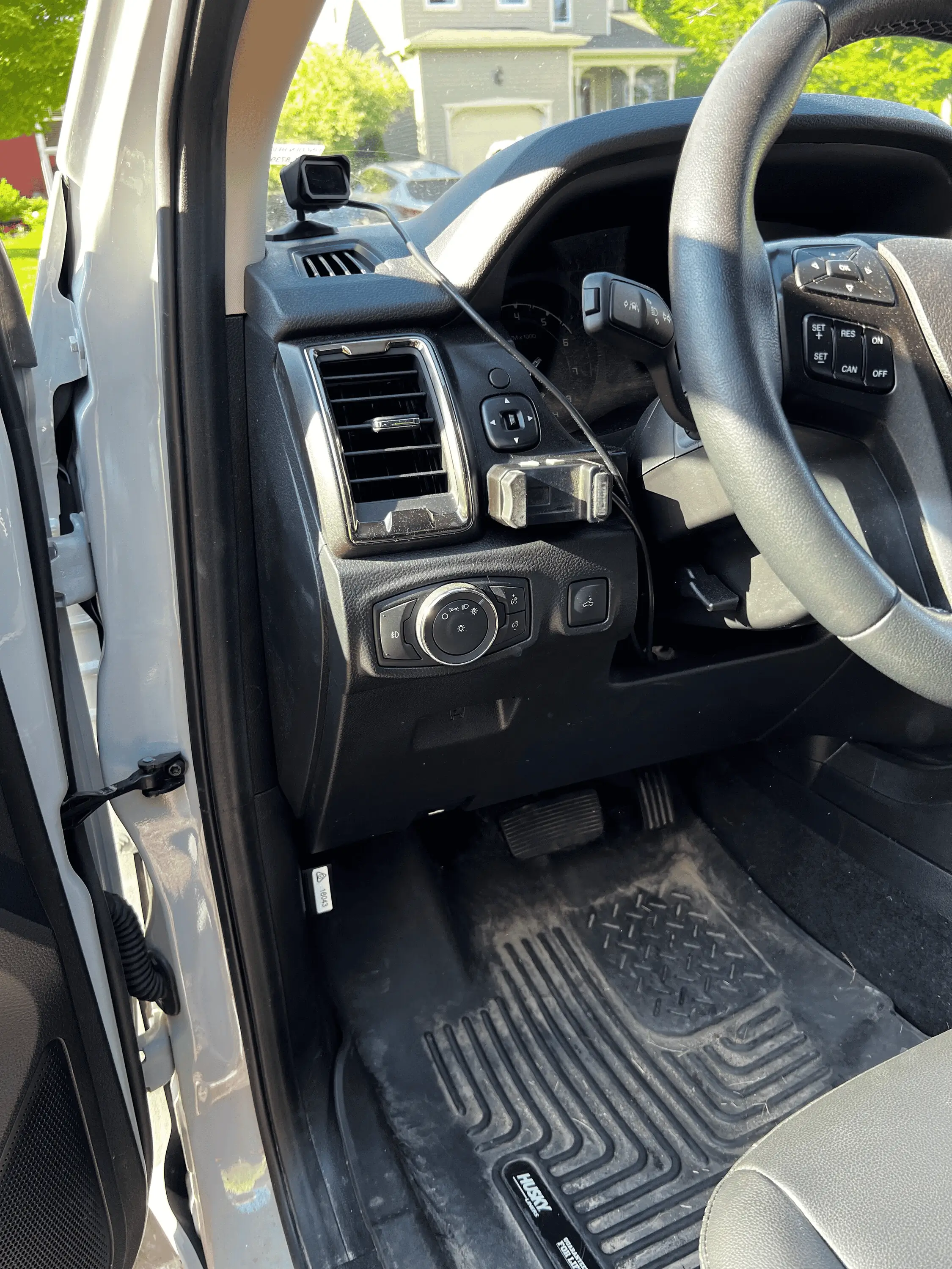

The blue plug he's unplugged in the picture is kind of up behind the headlight switch. If you pull down the dash panel and look straight up, you'll see it. it does look like it has plenty of wire to pull it down once unplugged.

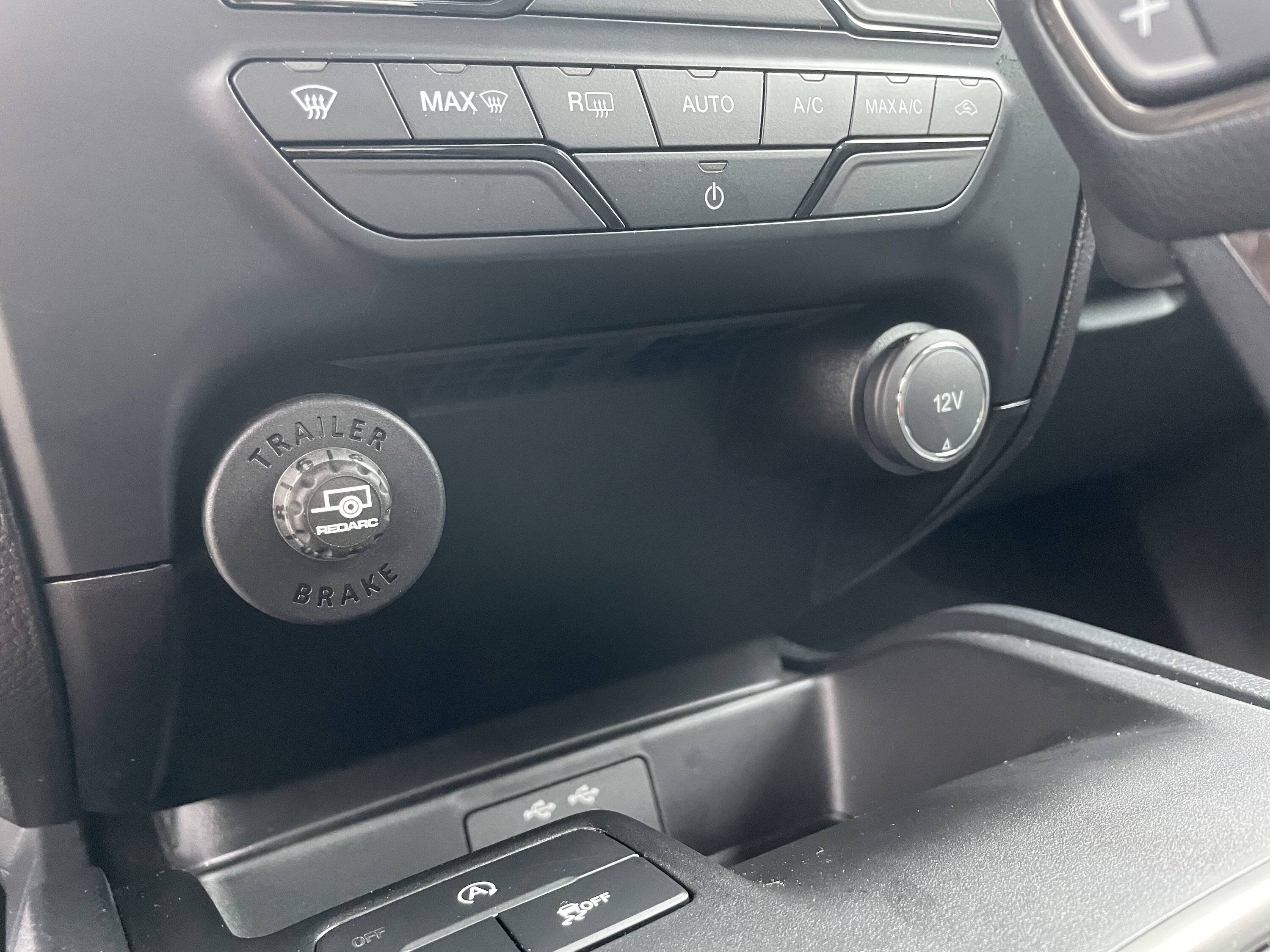

I have This controller and This mount for the switch. The liberty doesn't have all the modes of the Redarc Tow Pro elite (which is what the ford kit uses) but has proportional braking and a manual override, which is all I wanted and is $60 cheaper.
I had and still have a Tekonsha P3 which I had used on my previous car. It works great, but I couldn't figure out where I'd put it in the Ranger. I liked the Redarc install enough to just buy a new controller.
