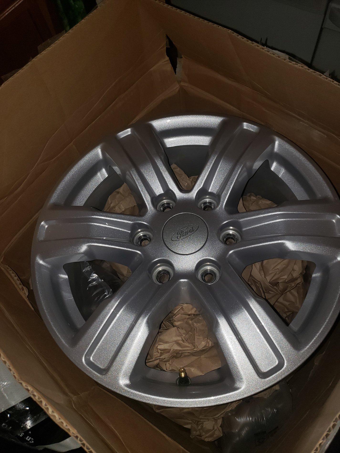

jerrywin
jerrywin
Jerry
Dec 28, 2019
146
288
Colorado Springs
2019 Ford Ranger XLT FX4 Sport supercrew
Let us know how these work out as a combination. And could you get the measurements of the valve stem hole and countersink on your wheel and the size of the valve stem portion that goes into the wheel ? :thumbsup: I'd like to get solid valve stems to go with my new wheels when I get them and it's waaay cheaper to buy your own sensors and real valve stems. DT and Fleet Farm want $45 per sensor :shock:
Thanks !!!!!!!
I'll certainly let you know if/how they work.
I got the wheels (see pic).
