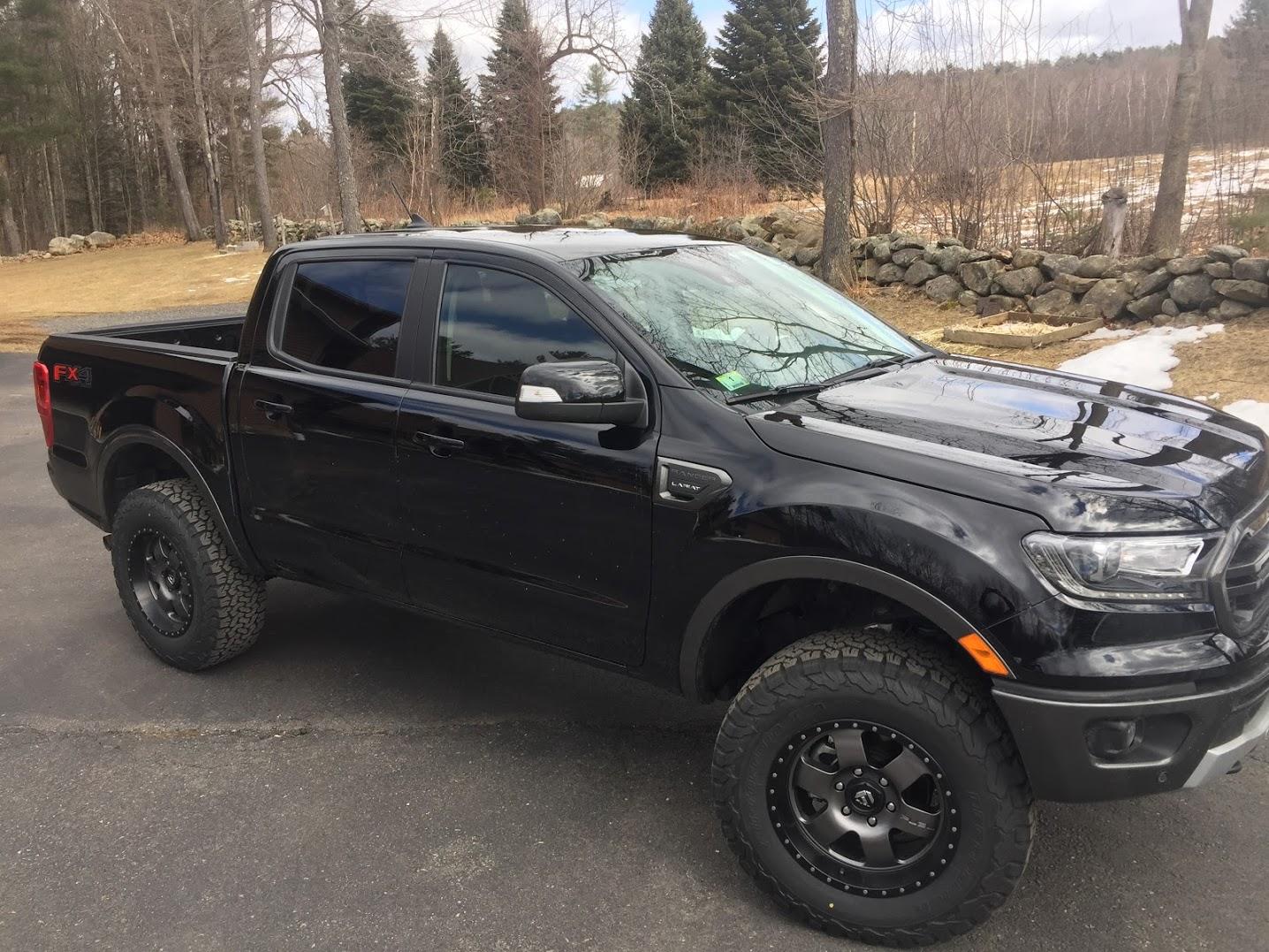

I ordered an aftermarket wheel & tire package online. Vendor said they didn't know what sensor went in the new Ranger, so I just had them throw in standard valves. Plus, on a previous vehicle, two of my TPMS valves fractured (not at the same time) because aluminum + salty Massachusetts roads = corroded aluminum. Those repairs cost more than this module.

New wheels and tires, mounted & delivered. Having the sensors pulled out of the stockers would've cost money I don't wanna spend.
WxTrfHeJXpBRc1rbPuIJyPKN4NETaheLP1jOcdopVs0qfyGBIM1ECTrzWP3zGinyeKx9jYTW8psOtd0DJ=w1436-h1077-no.jpg
