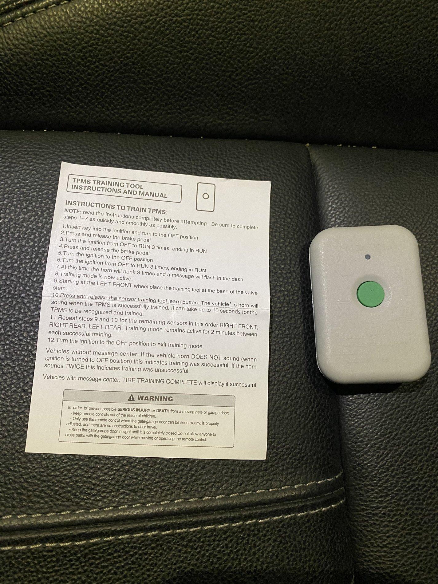

Well, I went and purchased this little gem from Amazon, got it next day from Amazon prime for $15:
https://www.amazon.com/Programming-...ds=ford+tpms+reset+tool&qid=1584123130&sr=8-3
I figured it probably wouldn't work, but I'll be damned, took me only a couple minutes and all 4 sensors responded and are working correctly.:LOL: So much for the fancy hand held computer thingy the tire place had?

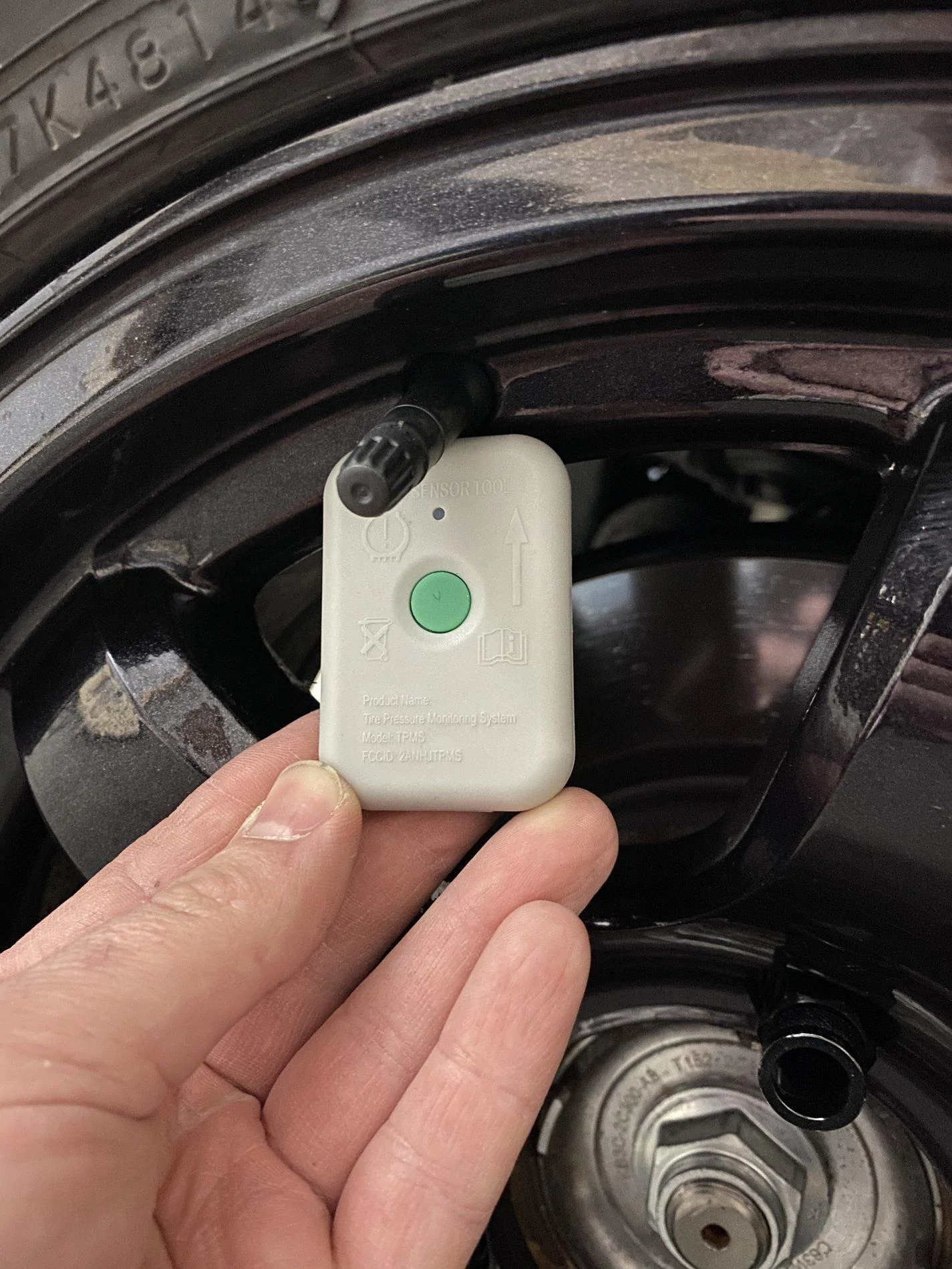

I can confirm that these TPMS42 "FoMoGo" sensors from eBay work properly. I swapped them out this weekend, then used a cheap TPMS programming tool to program them today. So far all are working properly. I had to follow the instructions included with the TPMS programming tool, and not the instructions in the owners manual, in order to get the truck into programming mode for new sensors. Links and pics here:
https://www.ebay.com/itm/283738112480

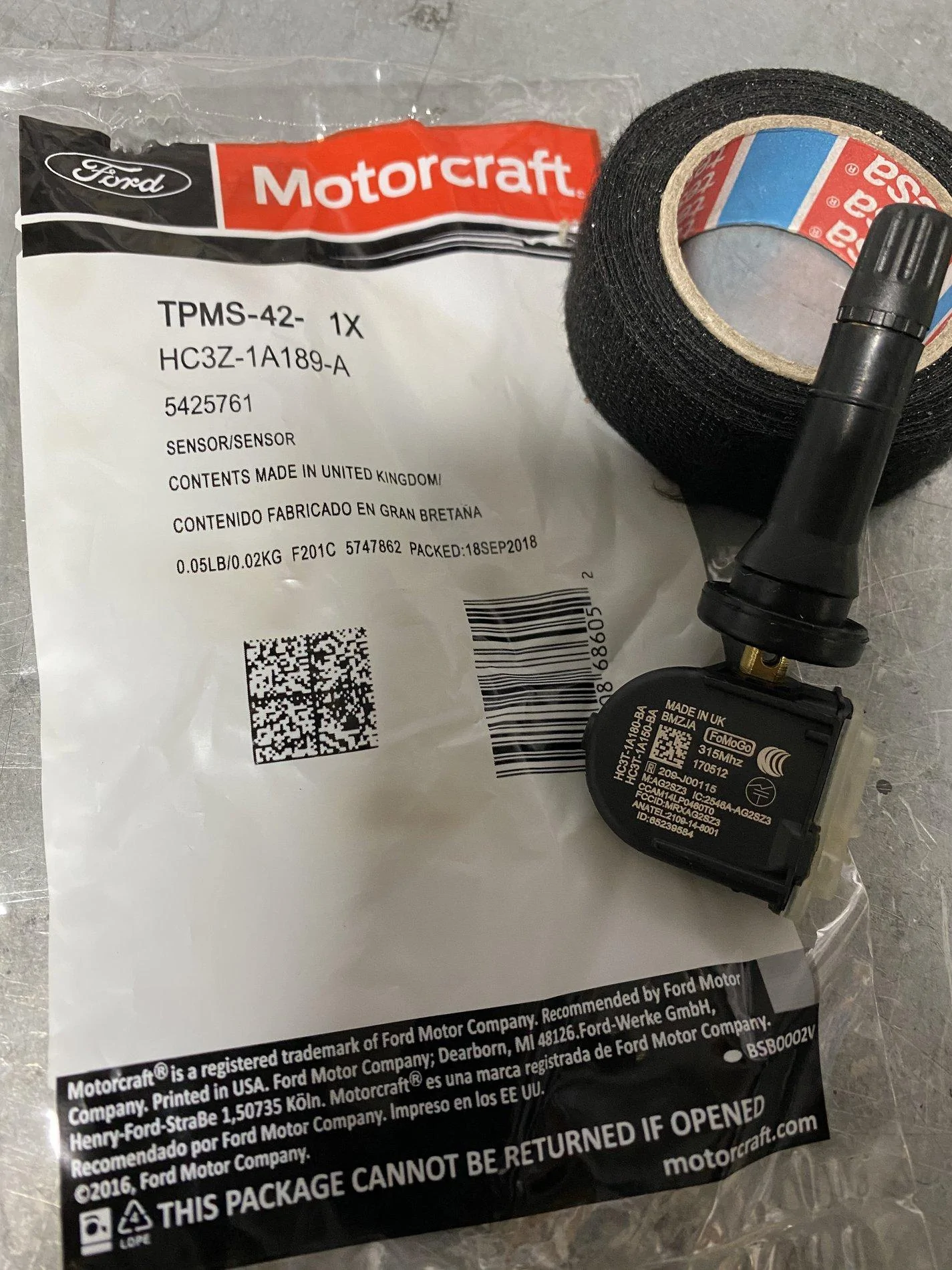

AAAAAAAAAND they died. 3 of the 4 "FoMoGo" TPMS sensors I installed have died in 2 years. I was thinking maybe it was due to our insanely cold winter, but it seems as though others have also had bad luck with this junk. When I pull them out to install actual OEM Ford sensors I'm going to see if there's a way to replace the batteries in them just for the hell of it. So annoying.
Yup, junk, 2 of 4 for me, have died after about 2 years also.
