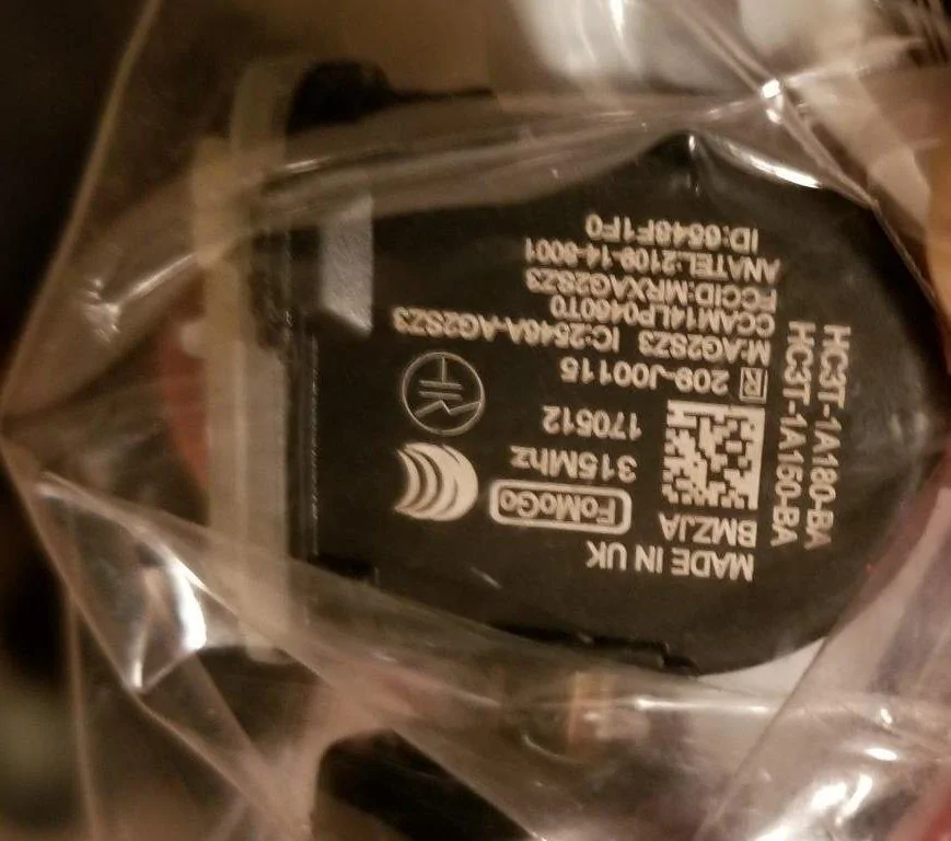

I just received these senors TPMS42 from the seller you posted. I ordered them this past weekend. They are all in sealed Motorcraft bags, but I am thinking they are Knockoffs as they have a FoMoGo mark on them and I believe it should be FoMoCo?
that would 'splain the price ... if they work though, i'm ok with that. mine won't arrive till midweek; I'll compare notes.

Got mine today. Looks like it's consistent with what you found: FOMOGO on mine as well. Looks like they are made in the UK, if you can believe the packaging - they spell it tyre. There is supposed to be some kind of date markings too, i think, but I'm not sure where to find that or how to read it if in fact I did find it.

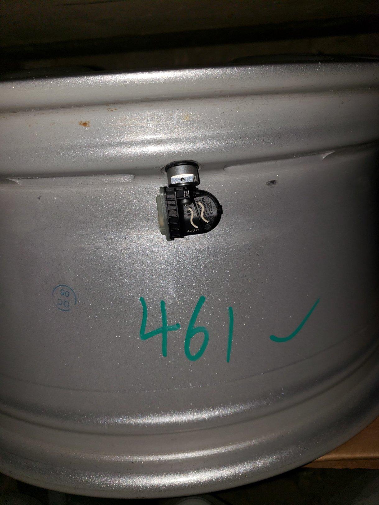

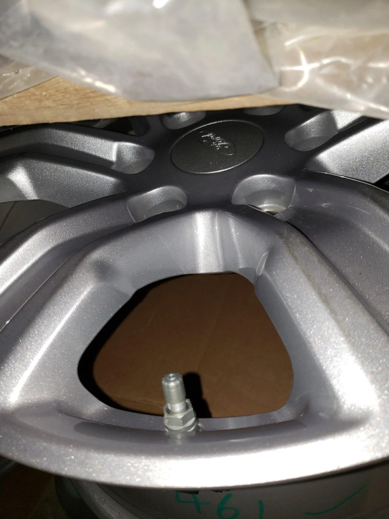

Let us know how these work out as a combination. And could you get the measurements of the valve stem hole and countersink on your wheel and the size of the valve stem portion that goes into the wheel ? :thumbsup: I'd like to get solid valve stems to go with my new wheels when I get them and it's waaay cheaper to buy your own sensors and real valve stems. DT and Fleet Farm want $45 per sensor :shock:
Thanks !!!!!!!
Don't know the countersink, and didn't think to measure valve stem. Did remember to measure hole size ... but there I did not have calipers to measure with. So, best I could figure with a tape measure was about 7/8" on the hole diameter.
The Schrader 34000 aluminum stems did work with the TPMS42.
