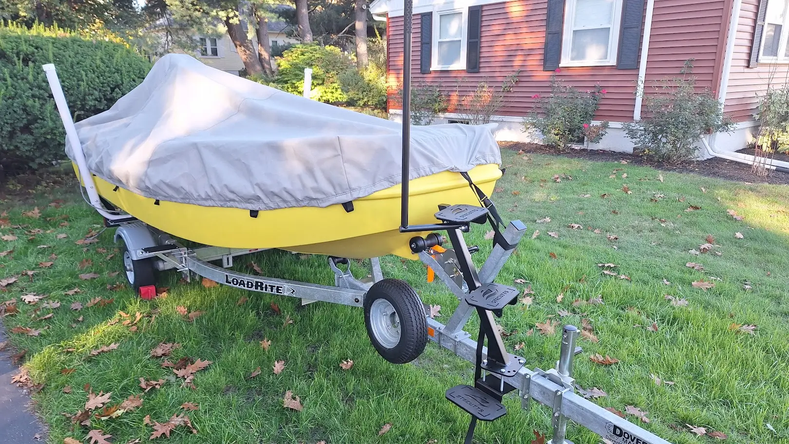

I did add the Redarc Liberty and what a pain to do the wires. They are very short, and I am very short and old, contorting to make the connections was unpleasant. I wish I had gone this route.
Grumpaw even told me, at the time, to go with his setup.
Now he tows, he really and truly tows! He knows towing!
And now, the main thing I tow almost weekly is a tiny boat trailer that weighs around 900 pounds and doesn't have any brakes. So my contorting was for nothing. I mean, if I ever tow something with brakes, I'll be set, but the same would be true with a Tekonsha.
Safety wise, if it has brakes, even surge brakes, they're good at most any weight for poor conditions.
I'm not worried about my tiny setup but having brakes would stop any trailer sway, if caught immediately.
