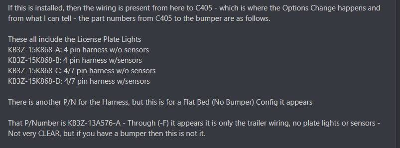

This will most likely be the same as the 5G, the Rear Bumper Harness can be swapped out that will have the 4/7 Way Connector on it.
So, this will give you the same harness as the Lariat Trim and Tow Package and give you the Connector (back-side) but you will need to also purchase the (Plug-In) side of it.
Example: Only
This for the 5G, the 6G will be similar and a different part number
