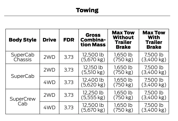

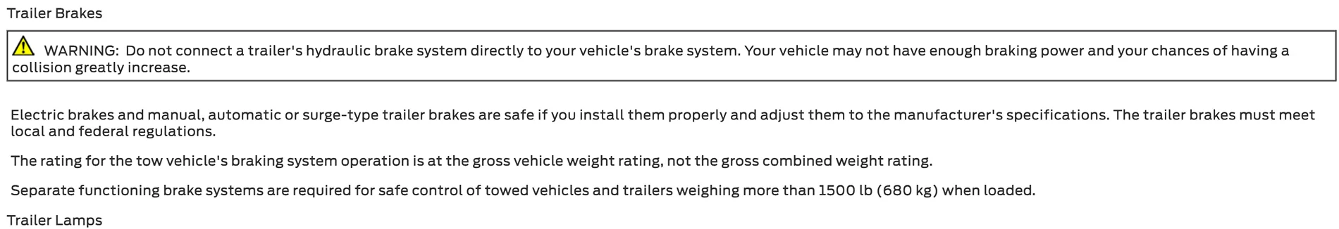

I curious where you see up to 3500 without. The number I saw said up to 1650 lbs without.
Well, that was in my paper manual, looks like Ford reduced it to only 1500 lbs on the current HTML manual release.
The update also reads that if you have the truck loaded to 5500 pounds and you have a trailer over 550 pounds that you'll need trailer brakes as they now clearly state that the trucks brakes are only rated to the GVWR, not GCWR, so trailer with enough weight to put the GCW over GVWR will require its own brakes.
The PDF version that matches my paper manual:
Thanks for the info.
