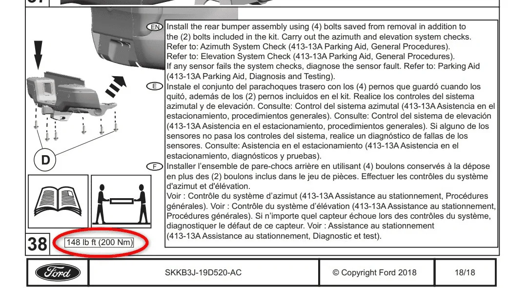

Ford manual says 148 ft lbs:

Hmmm. Never got notified of posts on this thread... I guess I was not completely clear - that was the installation manual for the hitch, not the owners manual. You never get any torque info from owner's manuals these days...
