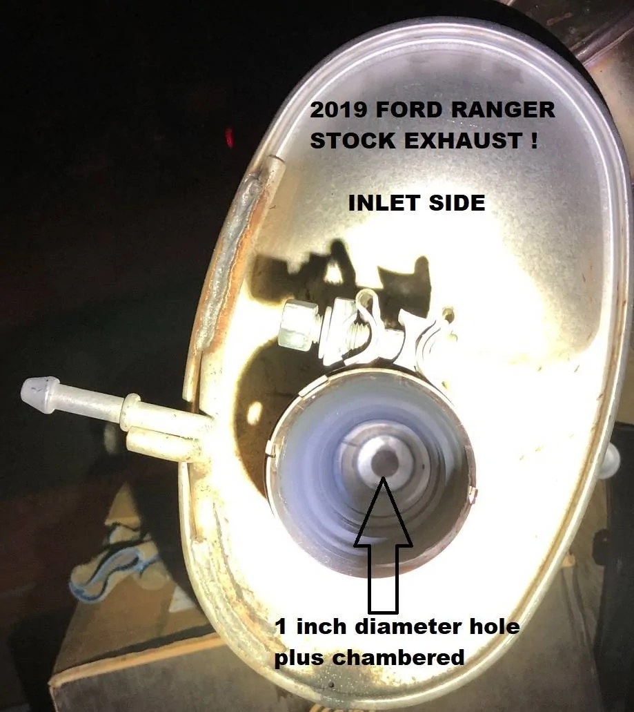

the factory muffler on our trucks is a real restriction there is other threads where some has pulled off the factory and punched out the back side of the muffler to ease that restriction. as for the down pipe, really have not hears about major gains not like we got from doing the down pipes on the SHO cars,
found the post on the restriction
https://www.ranger5g.com/forum/threads/5-stars-ranger-update.5818/
picture from 5 star
Misleading. That small hole is not the only exhaust path.
