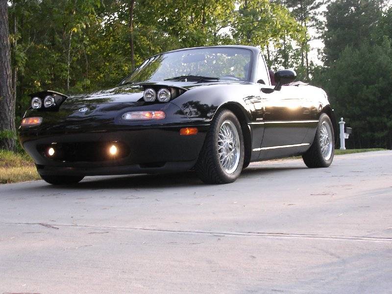

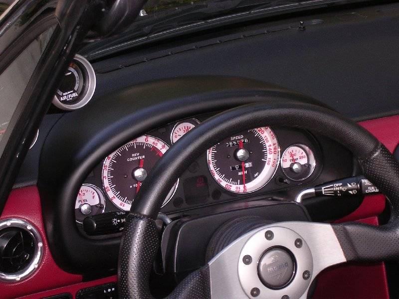

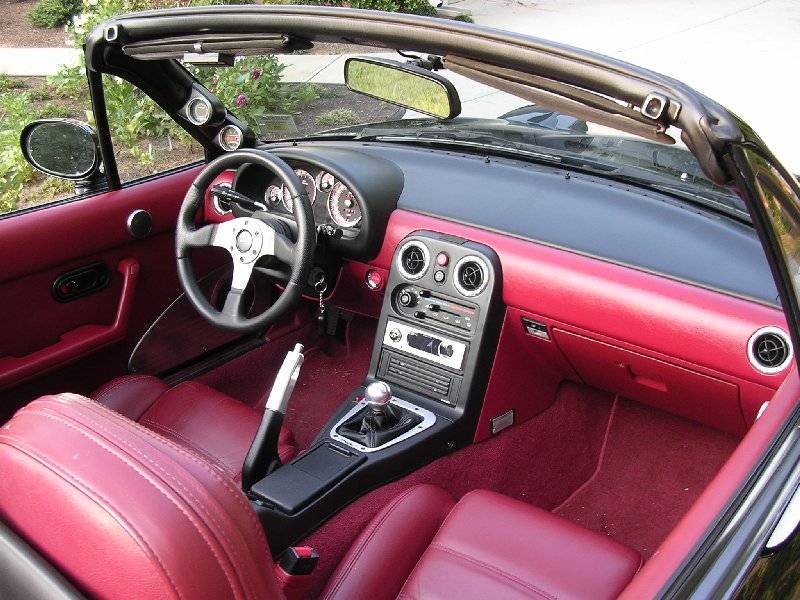

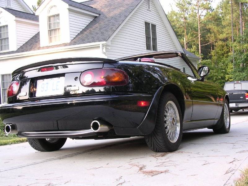

The last time I tiik it to be inspected I was having fun and was pulled by the police. IBefore he spoke a word, I handed him my drivers license and told him I hadn't had the car out in a few months and was bringing it in the get inspected (true) and that I was horsing around having fun... and that I waS guilty as hell. And that if he let me off I would go home and park it for the next 6 months! He smiled at me and instructed to head home. I did exactly as I promised, Still sitting in the garage. Here are a few pics. It is a 1993 Limited Edition Number 1310 of 1500. A great fun weekend car with less than 70,000 miles on it.
