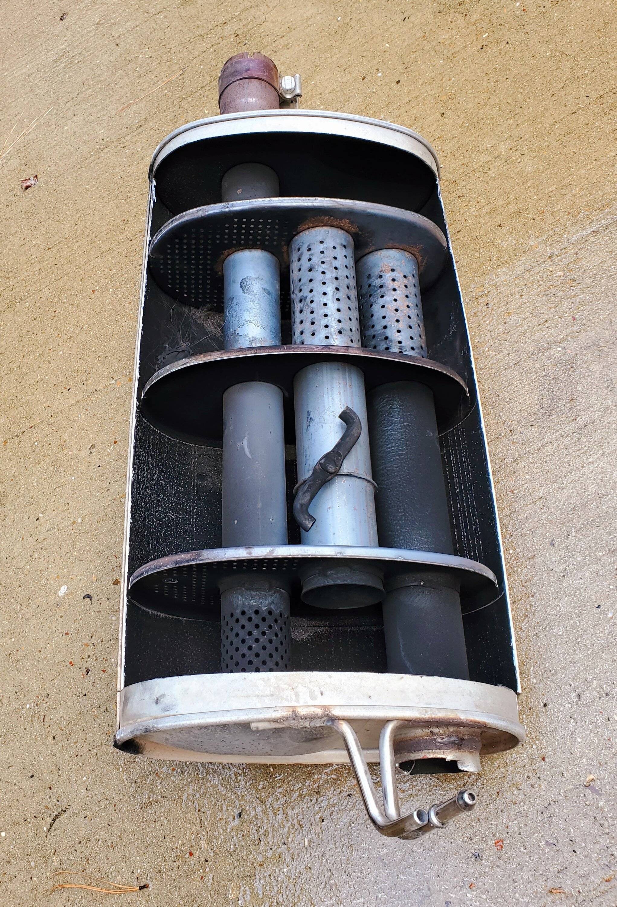

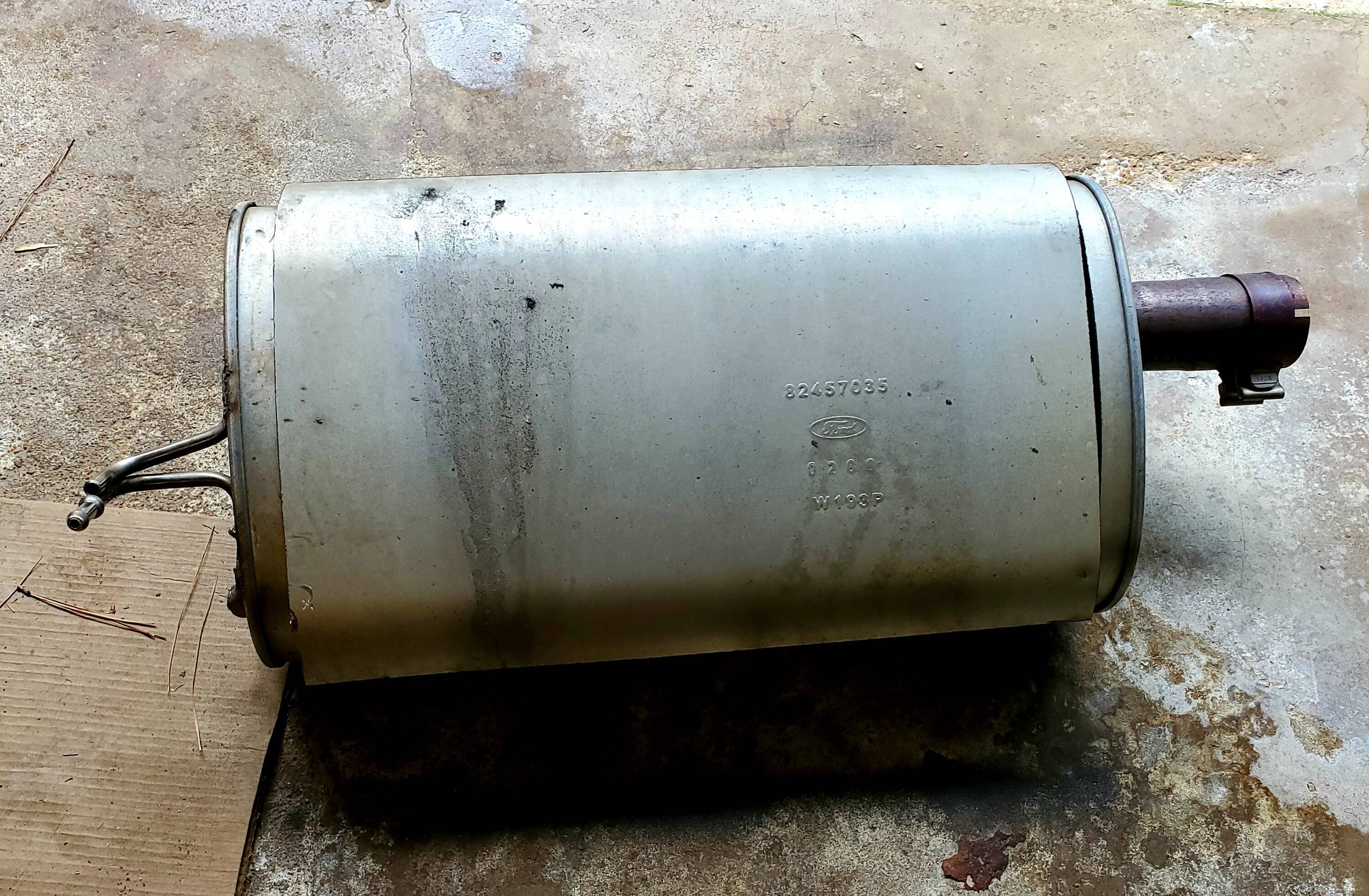

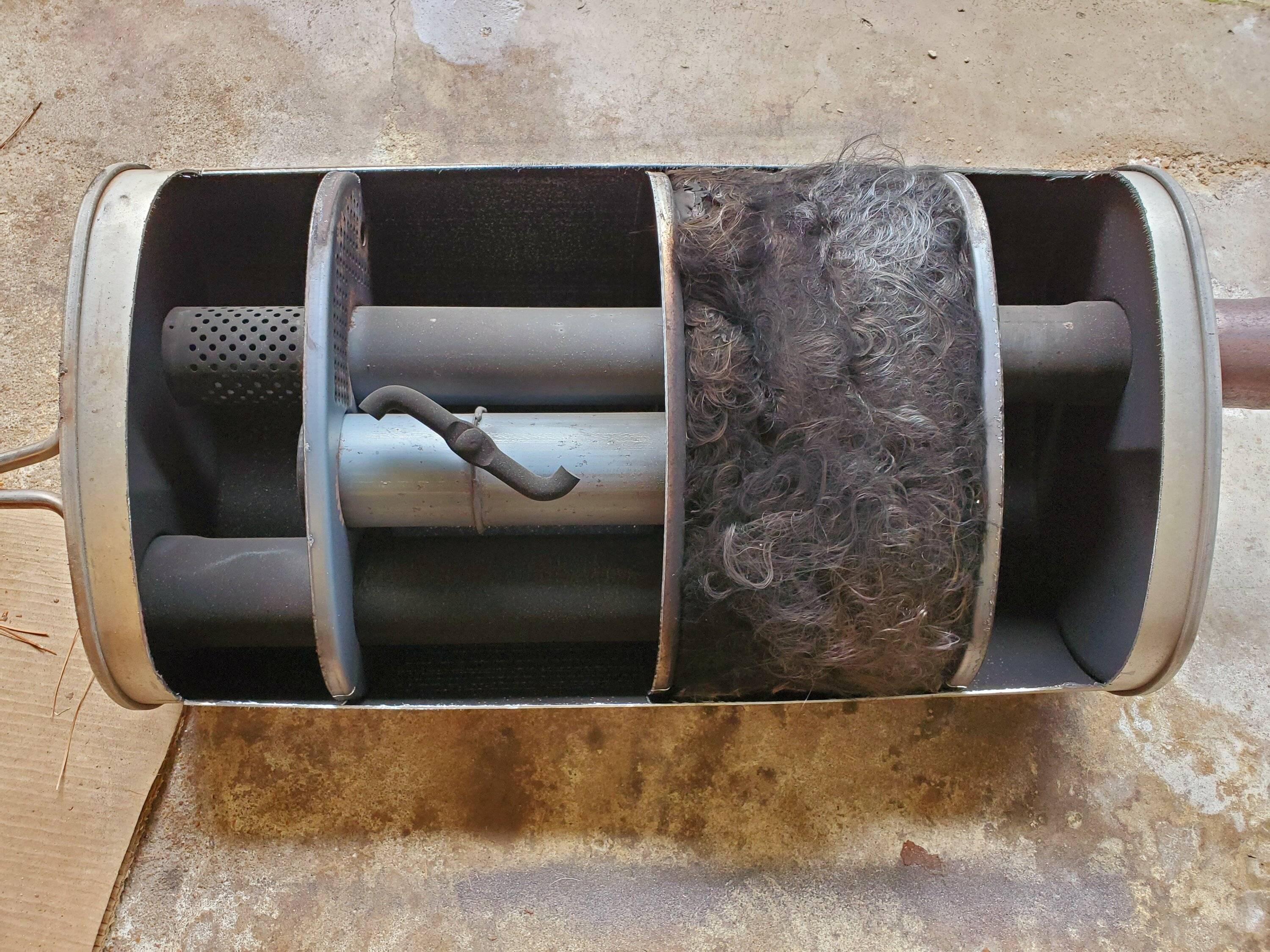

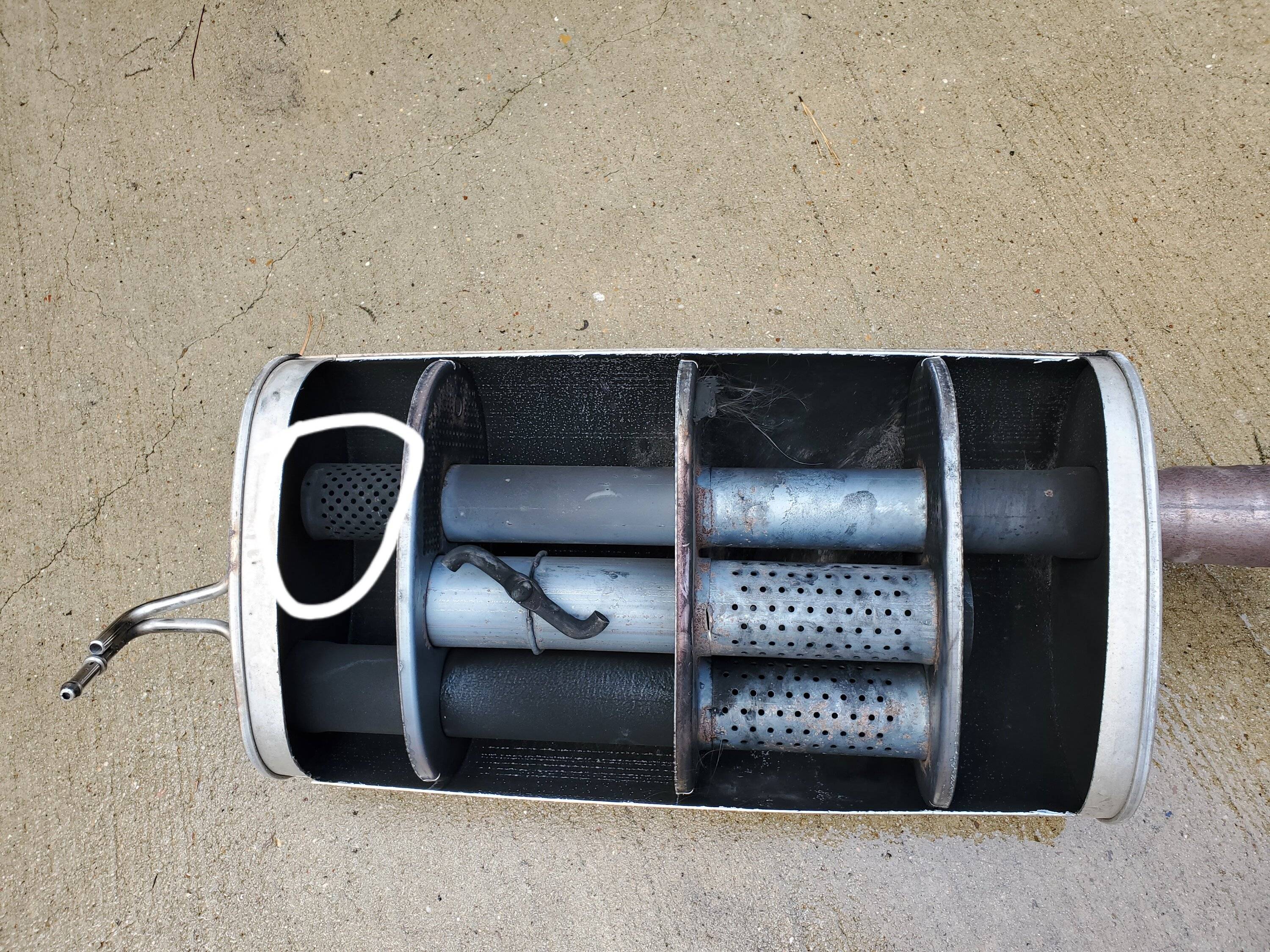

I'm happy I went with a very mild exhaust. I found a good deal on the Gibson and was hesitant at first hoping for something louder. After several road trips I'm very happy I went this route. I noticed a good bump in power in the top-end, but have the OZ tune.
The stock muffler is a little over engineered. I cut it open to get a look. I actually knocked the restrictor out with a jack handle and it must have blew out of the muffler because I could find it in the case. I circled the location where the restrictor is located, I noticed a little bump when I knocked it out, but could have been placebo.

Which end is which?

Misleading. That small hole is not the only exhaust path.
????? not the only Path ????? please enlighten us more........ that is the only inlet side on the muffler....

ya once it goes into the muffler... that restriction thou seems to be right at the opening to go into the muffler... so unless you think the exhaust goes outside and around there is only one way in to the muffler.....
The restriction is not at the beginning. It’s at the other end. The perforations are before the restriction.
