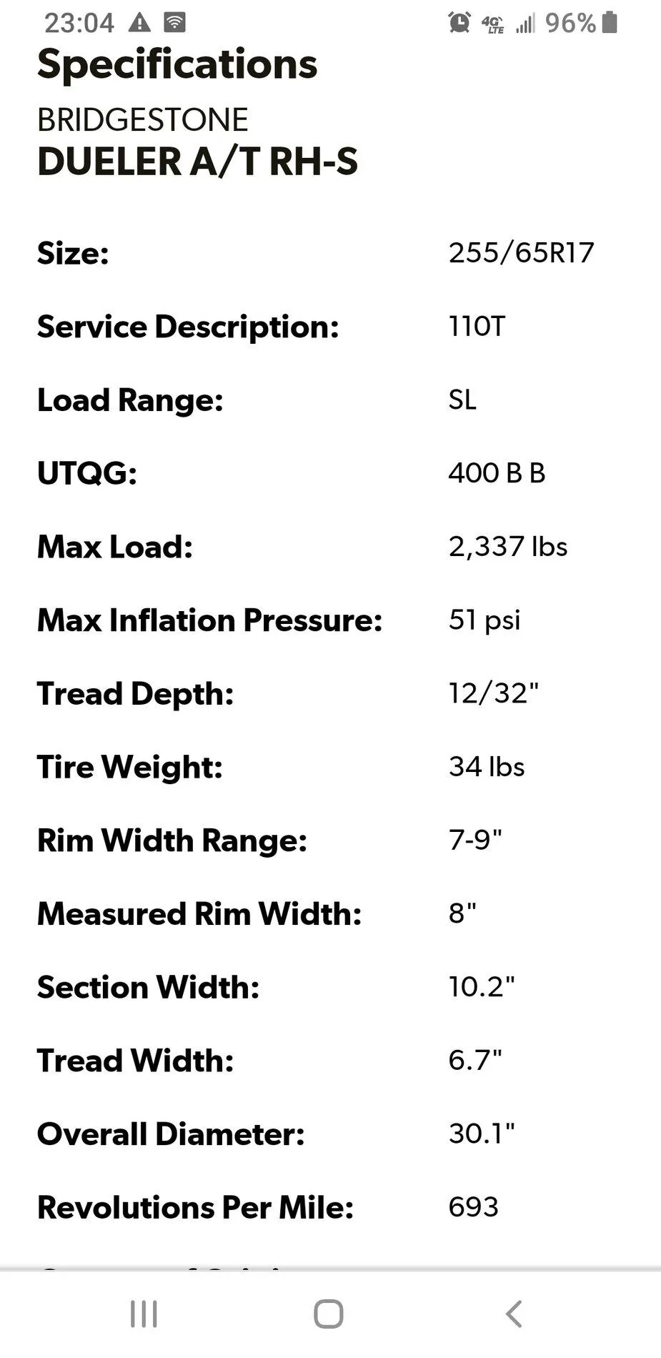

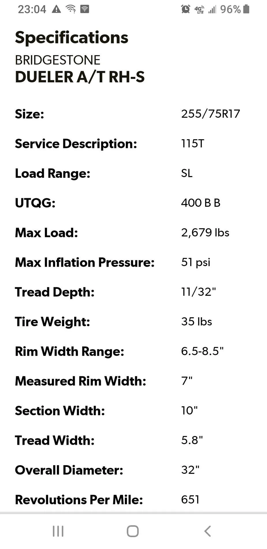

Just be advised, that whenever you increase the aspect ratio and keep the width the same, the tire's tread gets narrower.
So all things being equal, a 255/75R17 has a narrower tread than the OEM 255/65R17...

I said all things being equal- look up the specs on those two sizes in the same brand and model of tire...

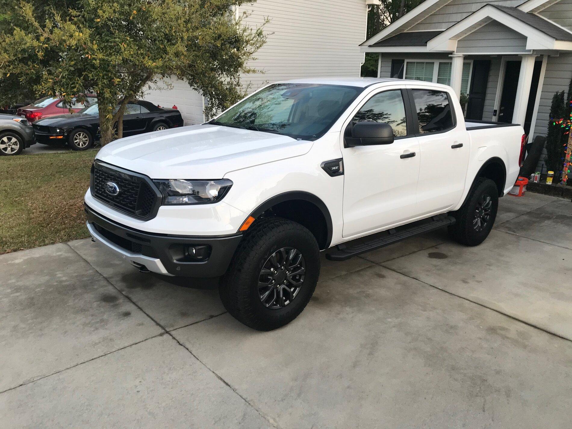

You got 285/70-17 on WITHOUT bar modification/removal?
Yes, my dealership had installed 285/70 and a 2.5" lift before I came along and purchased it. Here is the photo from March 2020 shortly after I brought it home and de-badged it.

I see...it's likely your offset were not messed with as you're on stock wheels...
Oh yea, any movement to negate offset would have put me into the bars. It was very very thin clearance with that Toyo selection. Some 285's won't work at all because no manufacturer has the same exact 285 spec.
When I installed 2" spacers the bars came out as that moved me to +5, then I got the RTR wheels which put me at 0+

Why would that be? Tire width should be exactly the same. Tires aren't shaped like inverted pyramids
Because tire sidewalls are not straight lines- they bulge, and the tire's size is based upon the widest part of that bulge, not the tread width. The taller the aspect ratio, the longer that inwards slope from the fattest part of the casing towards the tread, thus the narrower the tread, all things being equal.
