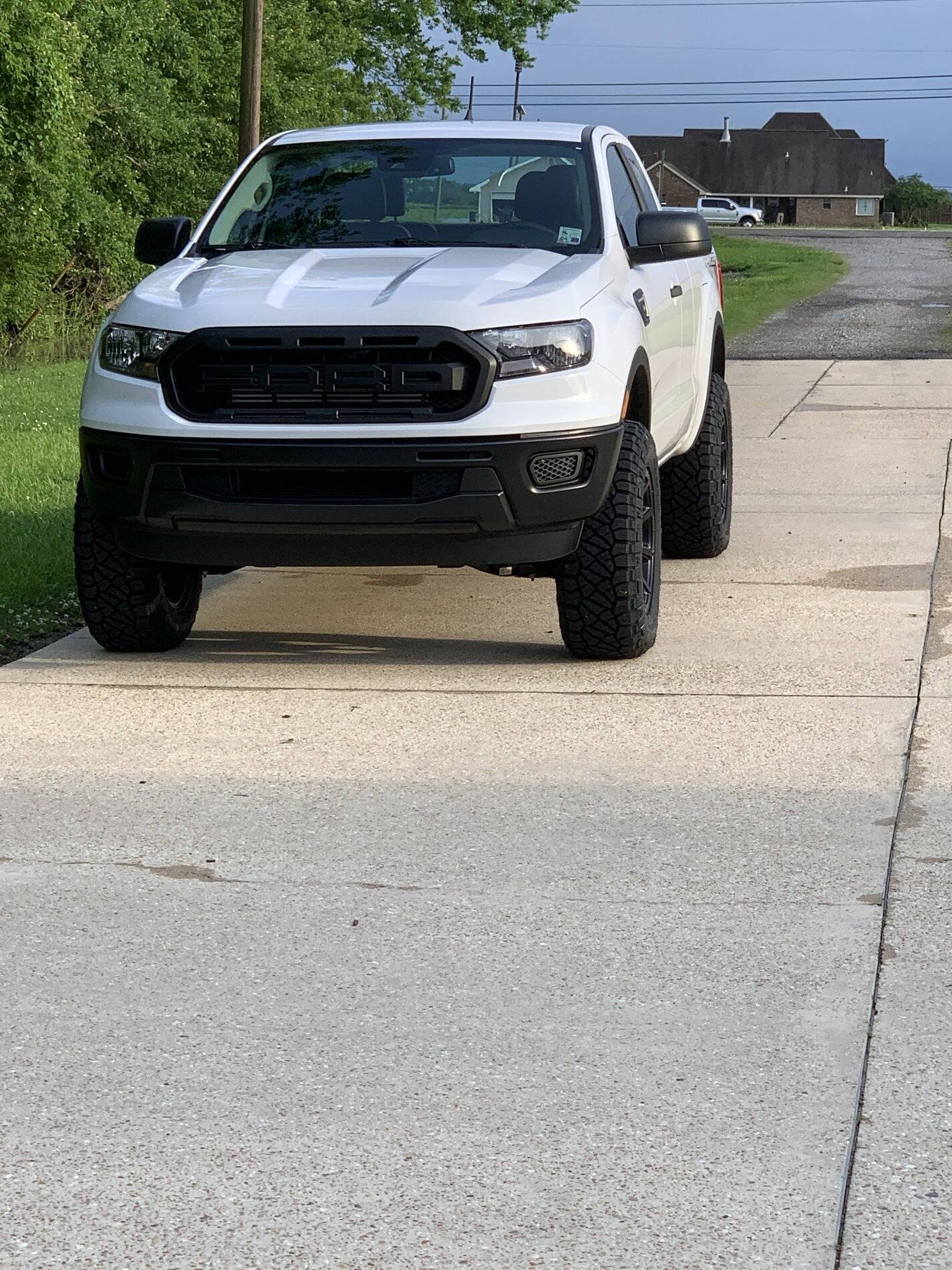

2” level with 275/65/R18 on mine. I’m not off-roading, therefore I didn’t cut or modify anything. If suspension articulation was a concern, I would encounter rubbing issues at full turn while in reverse. I have enough clearance right now for everyday driving and towing, with the 18X9 +18mm offset aftermarket wheels and nitto ridge grapplers. I installed the upper strut spacers in less than an hour, then brought the truck to a tire shoo for alignment. Hope this helps.

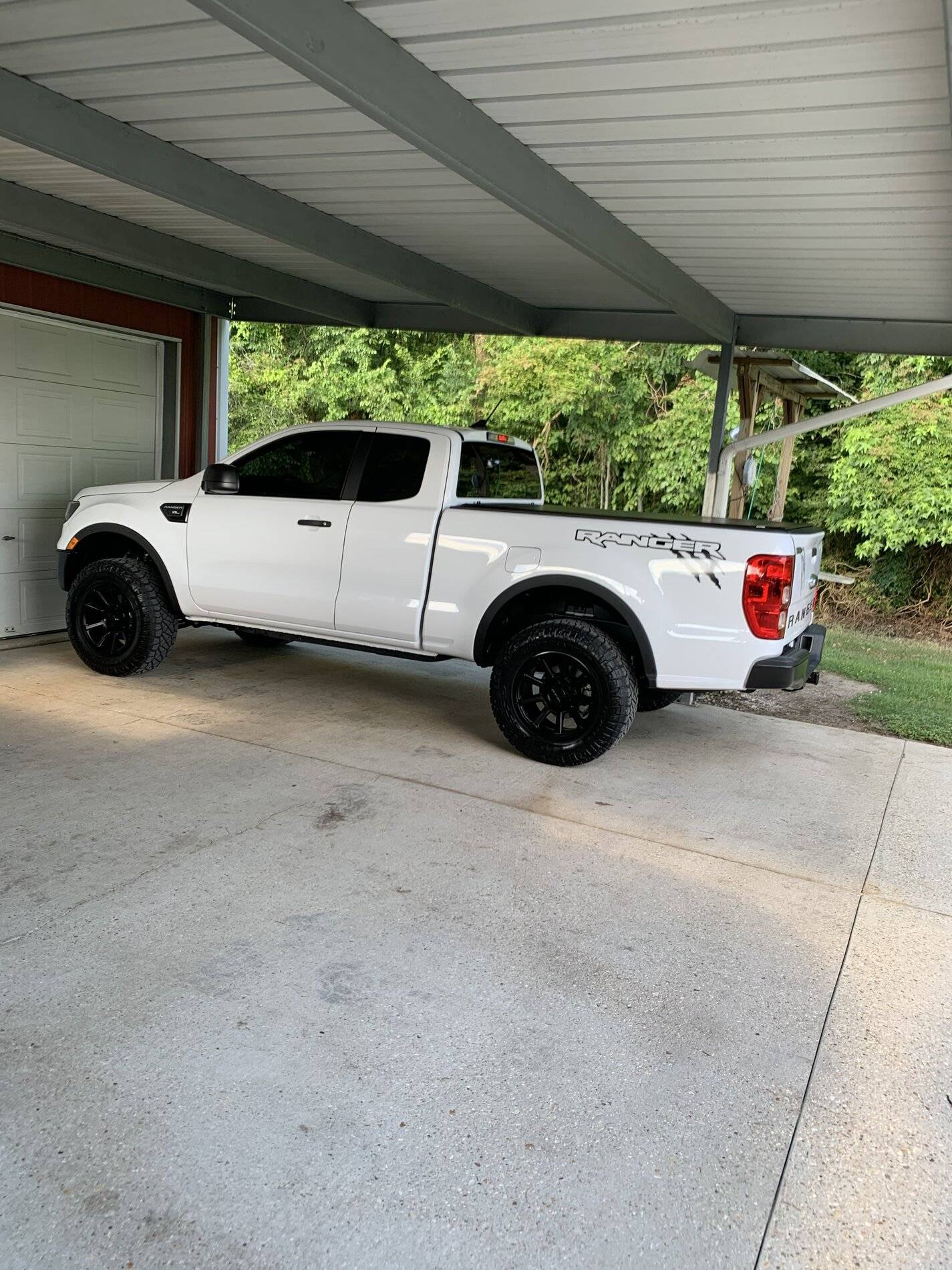

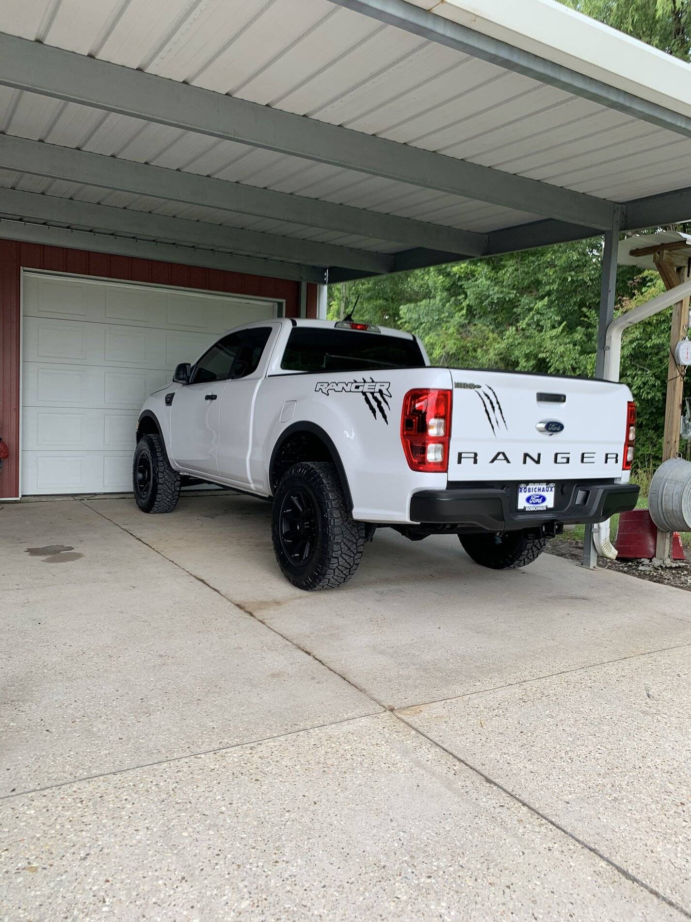

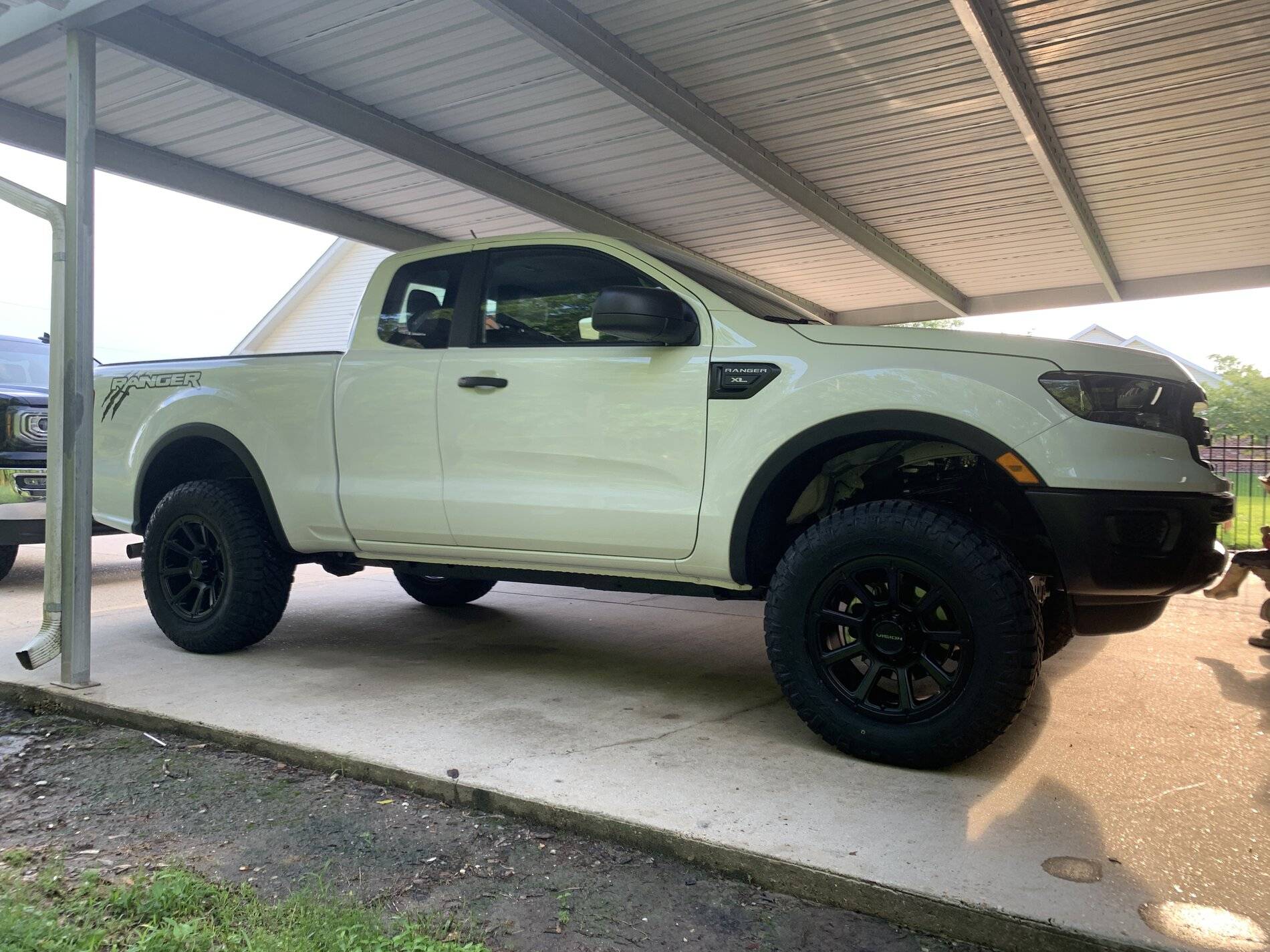

I went with 295/70 18 had to remove crash bars, but that was not an issue for me. really made a huge difference in the look.
