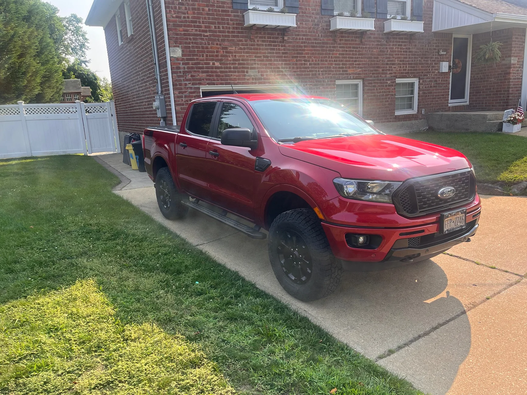

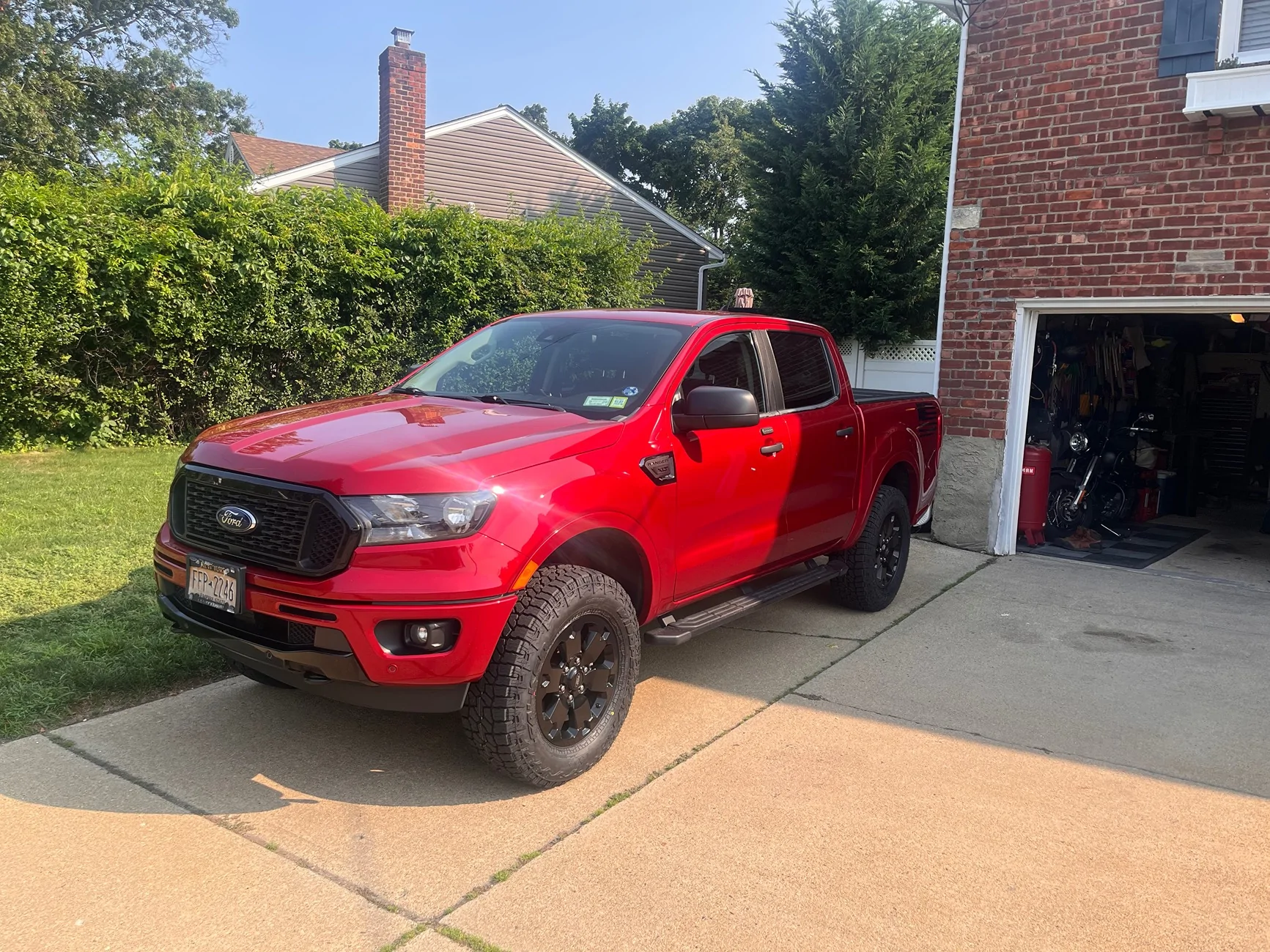

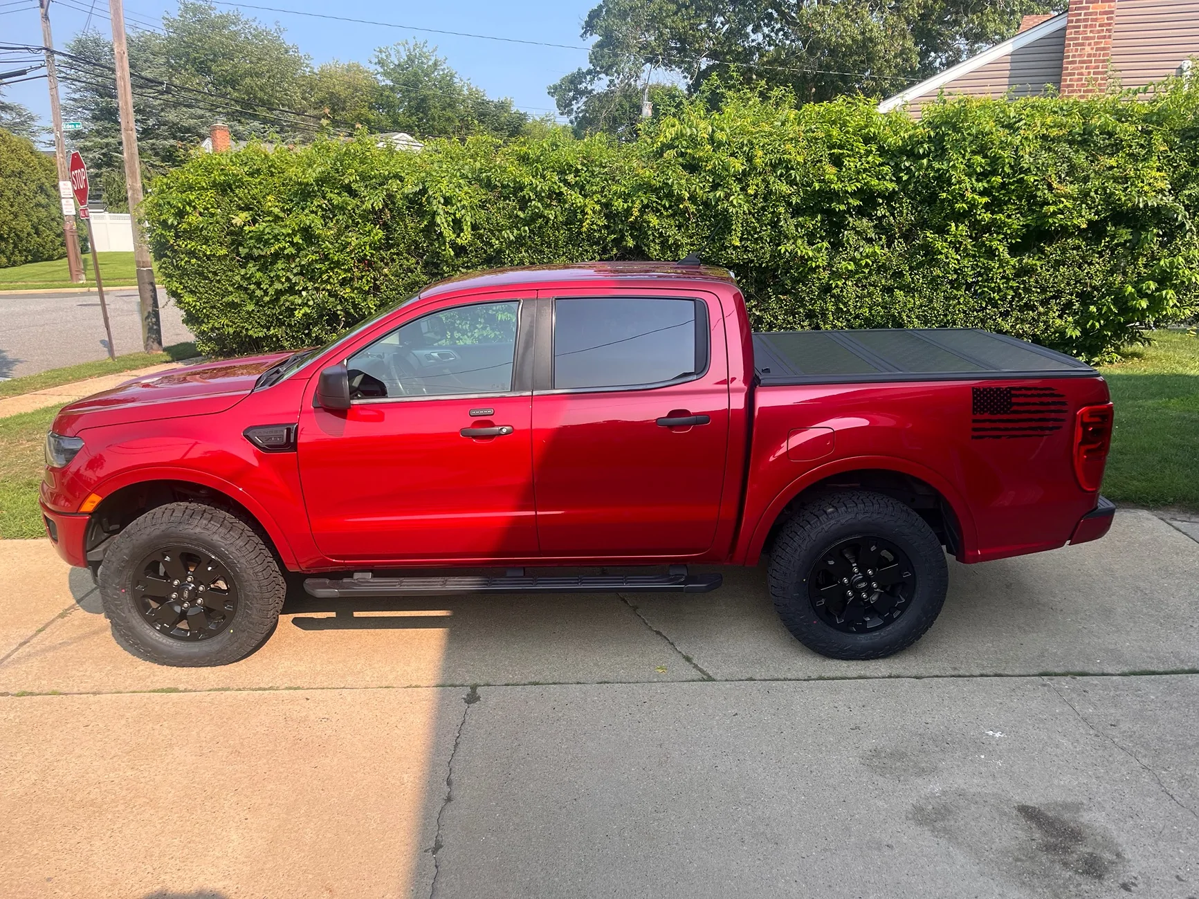

Installed new tires and leveling kit
-2 1/2” rough country level
-Falken wild peak 265/70/R18 on stock rims
so far on drivers side full lock rubs on rear crash bar and passenger side on full lock rubs on front crash bar going to try and loosen the crash bars and push them out a little will update when I get a chance
