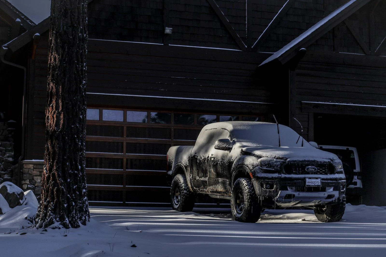

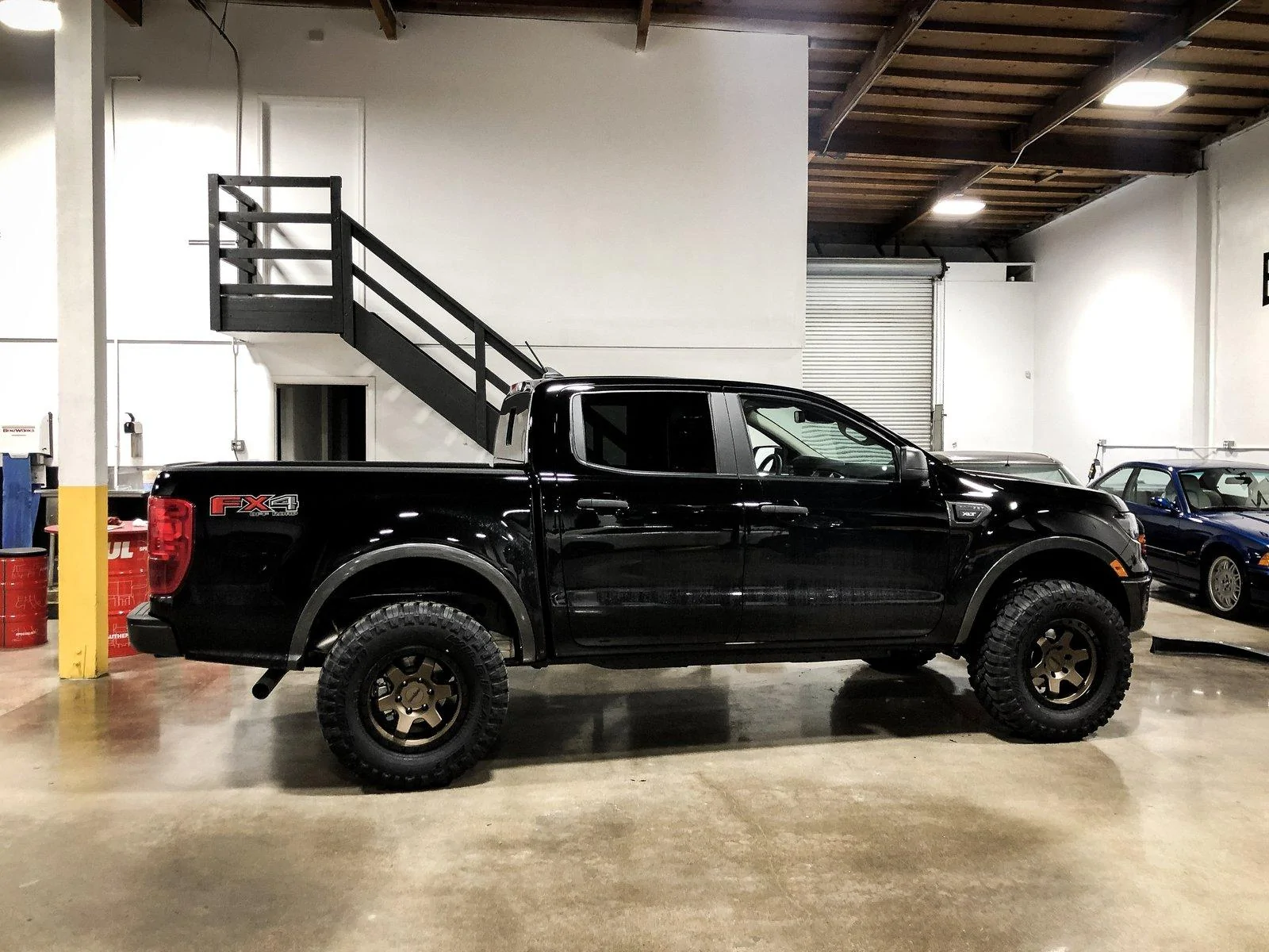

How's the clearance up front?
Rubbed on the small bumper inside the liner but I removed them as well as the ones on the cab side of the wheel arch, now it rubs on the wind deflector. Will remove those as well.
Overall it drives great and sits up just high enough.

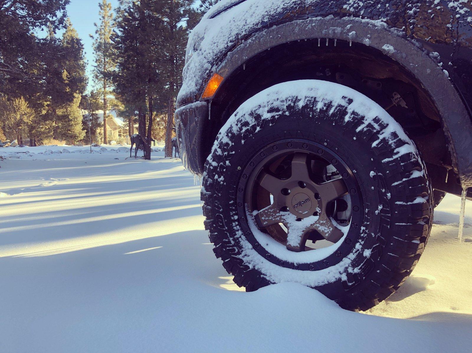

Hi there , I’m looking into the same rims. did you need wheel spacers to fit the 33s?
I did not need spacers, if I remember correctly they are 17”x9” with an ET 0mm
they do poke a bit but nothing unreasonable in my opinion.

Just ordered these exact wheels but with 265/70's instead. Did you have to remove the crash bars?
MrRisk
MrRisk
Nick
Feb 2, 2019
209
658
Ranger XLT
Mechanic
Yes I did.
