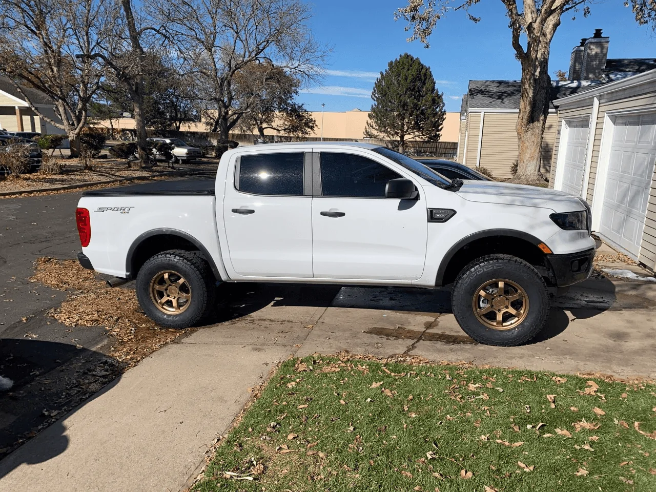

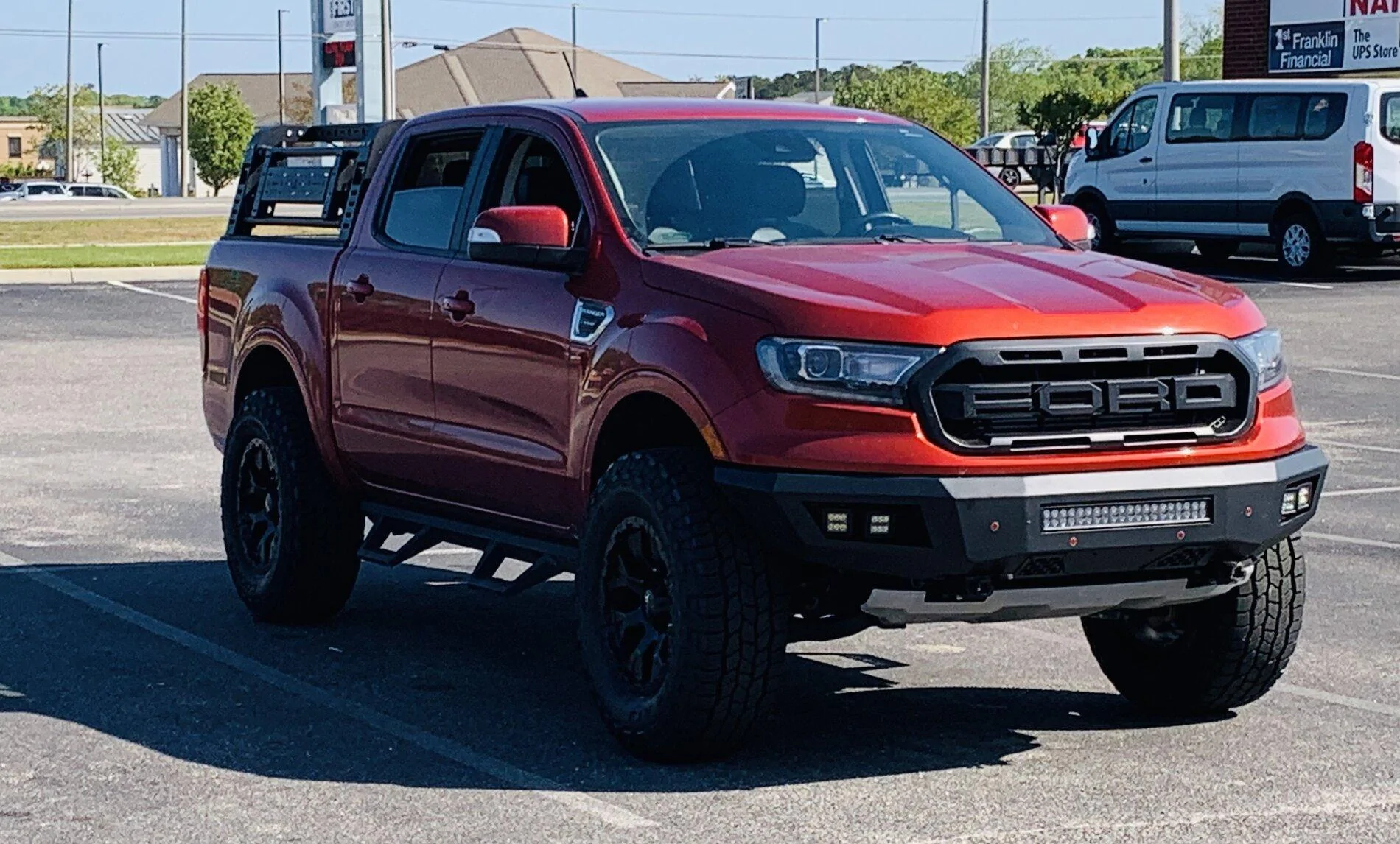

I did the 2.5" RC level kit with 265/70/17's and there's no rubbing and didn't have to. remove the crash bars. There's a lot of info here about different sizes and what fits and doesn't fit. You can also use this chart to compare different sizes to see how large 18" you can go compared to the 17's.
Buy using your tire size in the chart it looks like the 18's will be .7 taller and .4 wider. There's not a lot of room in there with my 17's but maybe someone with 18" can answer this better. I'm sure it's covered somewhere in the first link to the tire size thread.

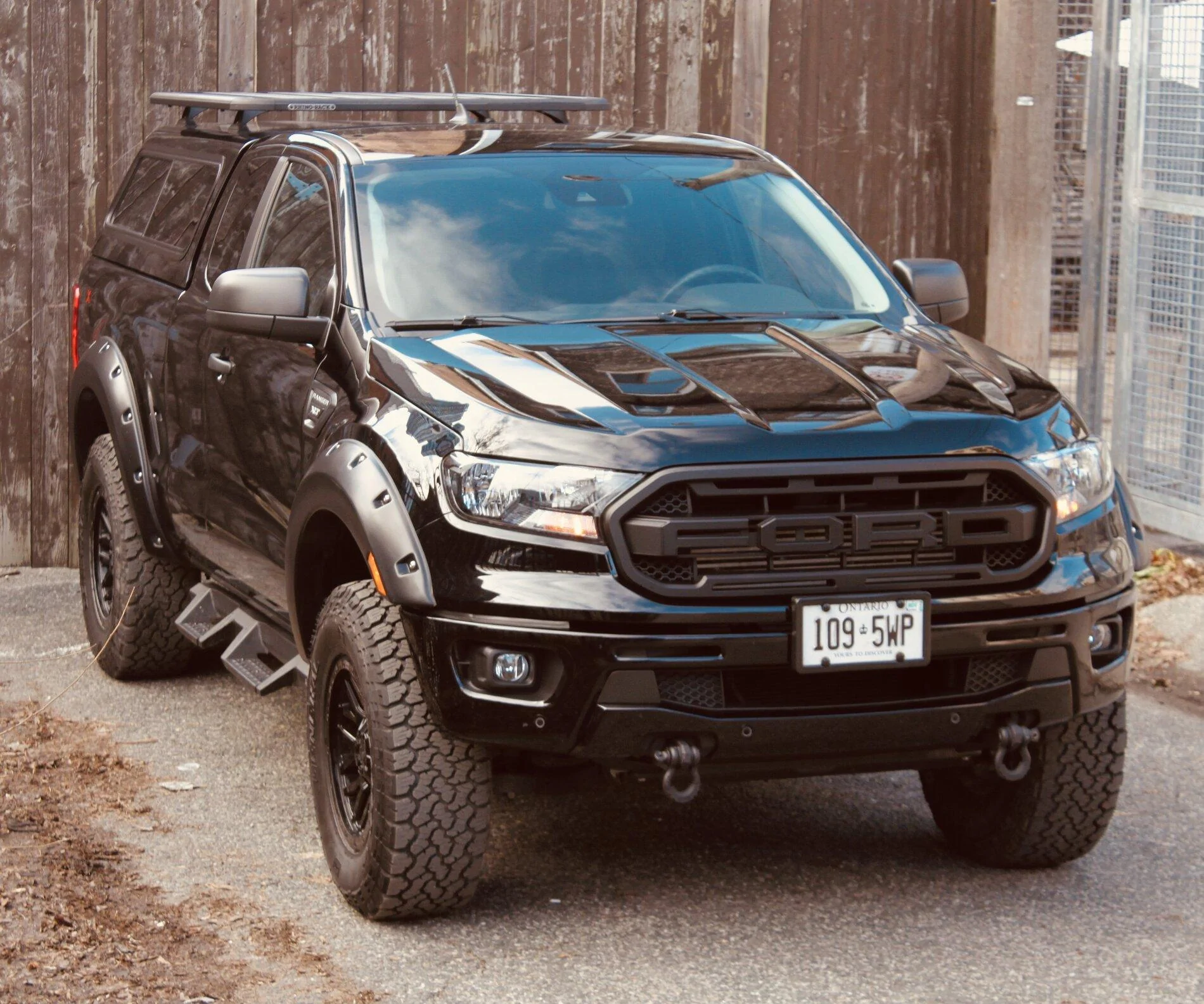

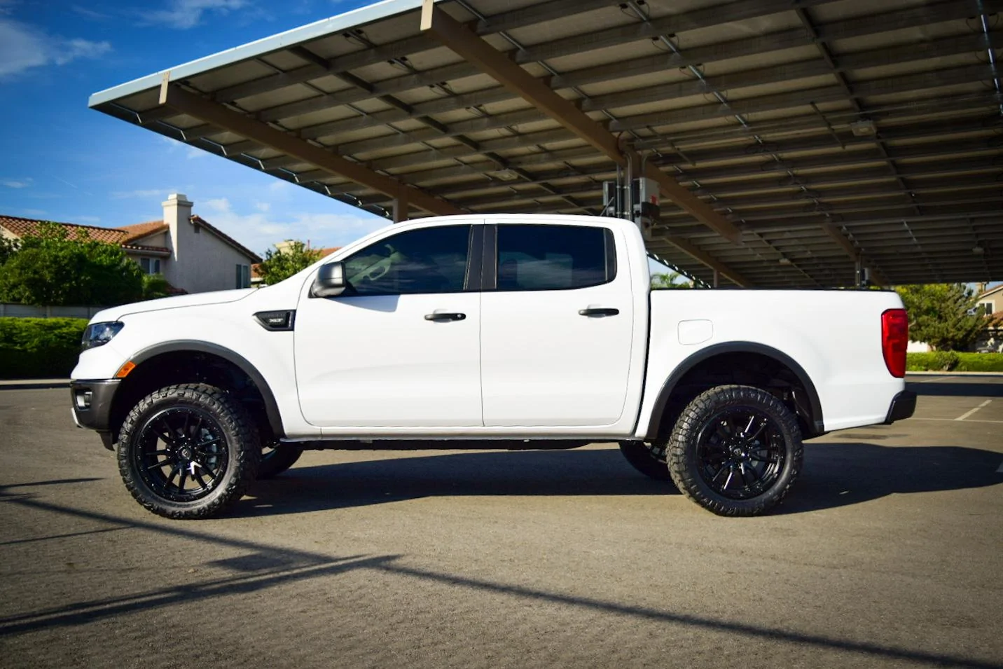

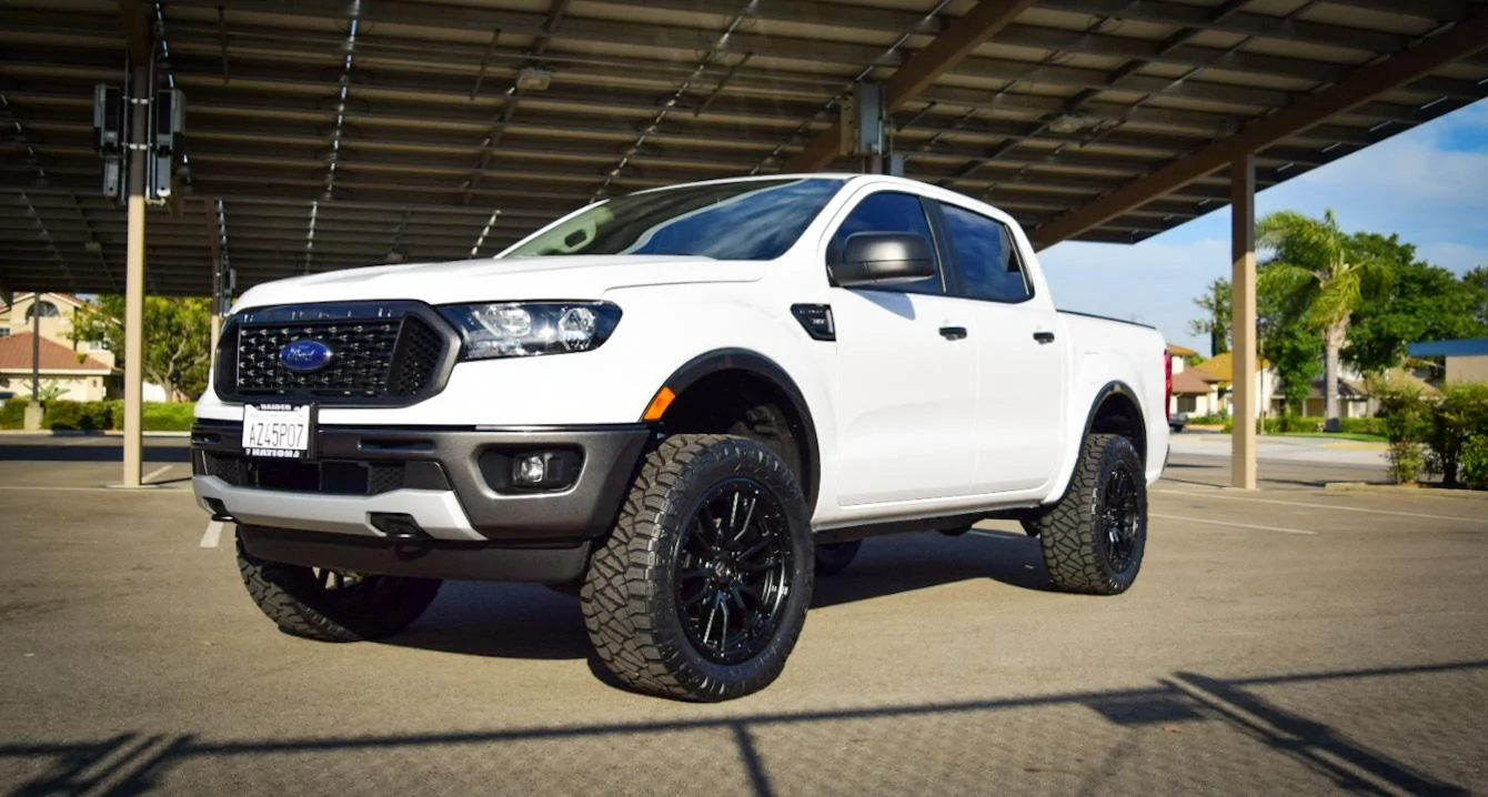

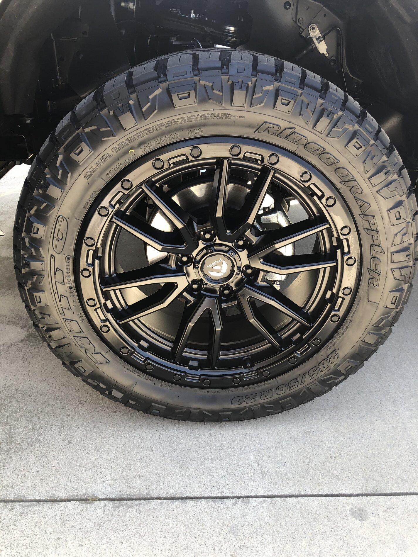

I did the 2.5 level and went with 20’s with nitto ridge grapplers. Rides perfect, no mods or cutting needed
It looks like you removed your crash bars - did you?

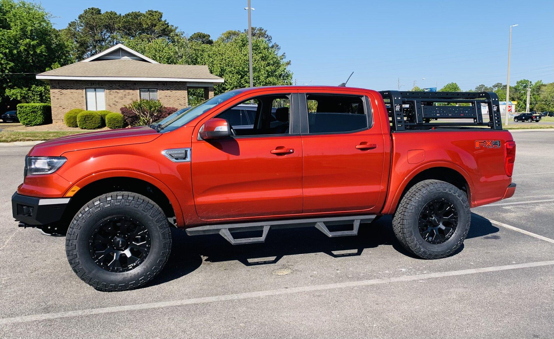

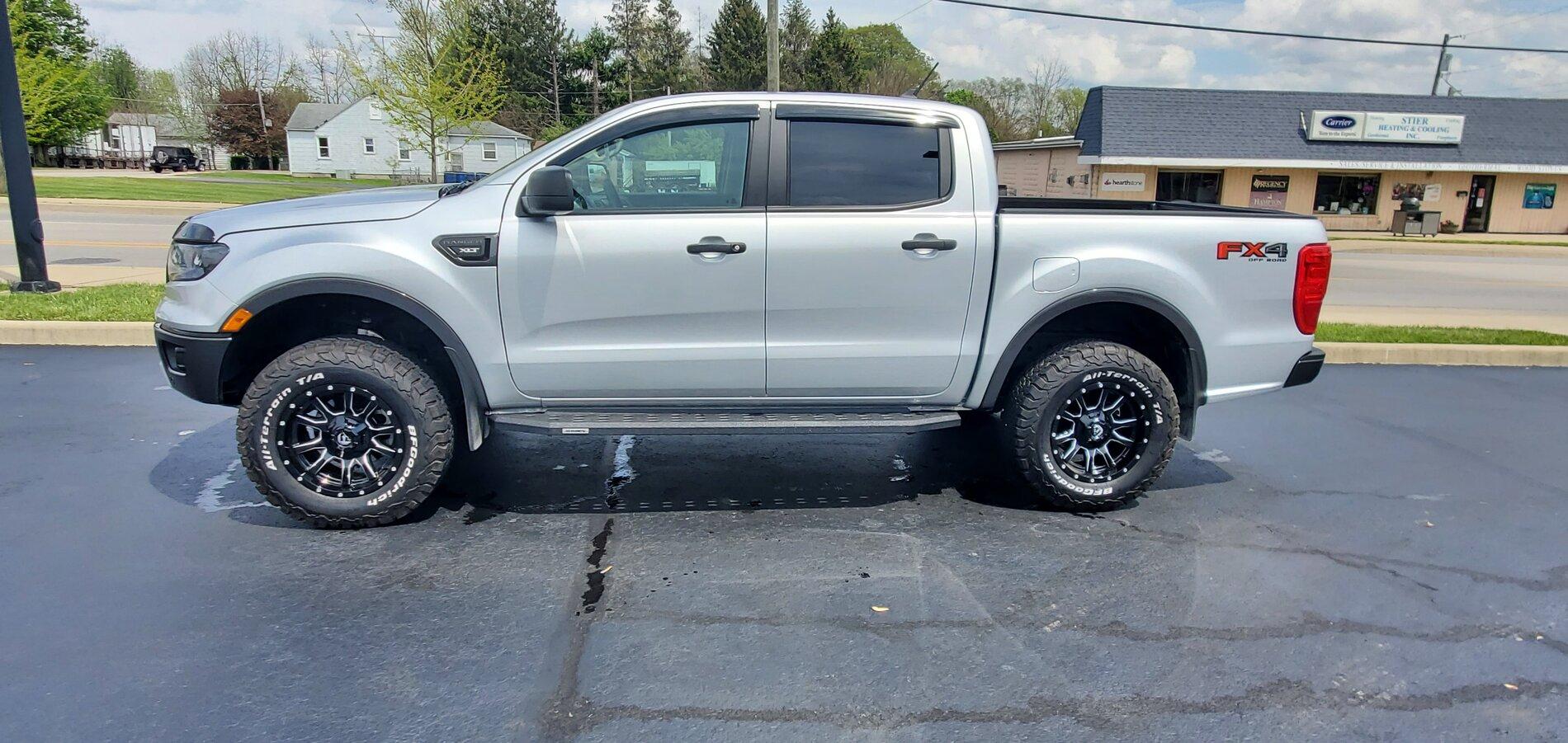

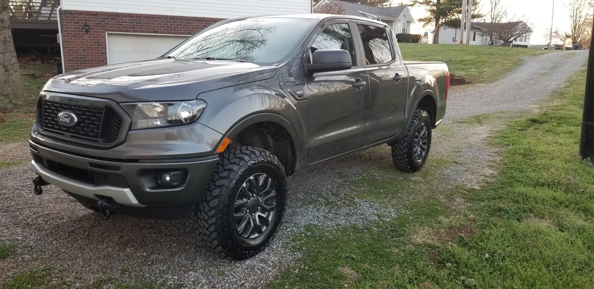

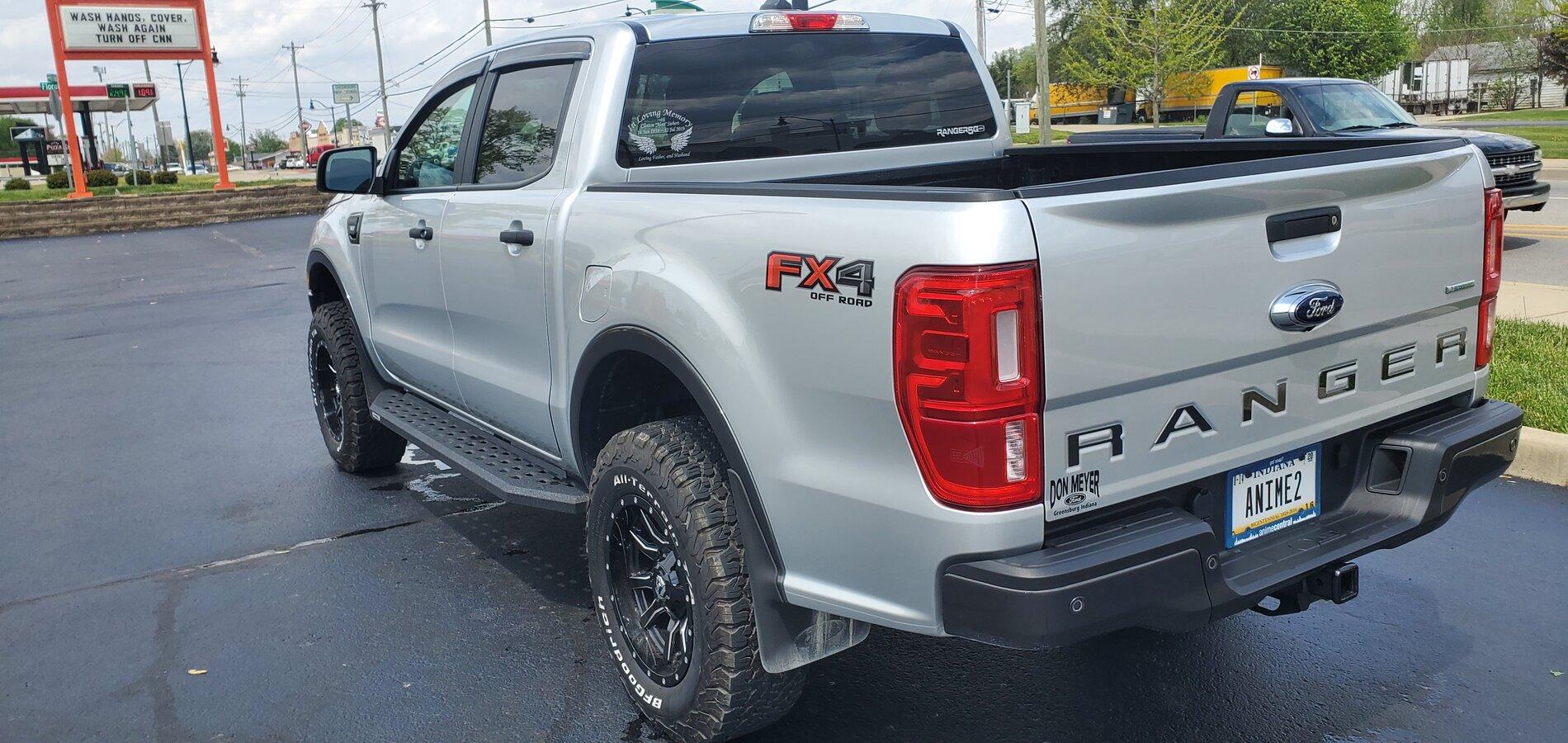

I went with the RC 2.5in leveling kit on 17x9 Fuel Vandals w/ +1 offset on 265/70/17 BFG Allterranins. Just a slight rub at full clock on the crash bars but doesn't bug me enough to cut them out.

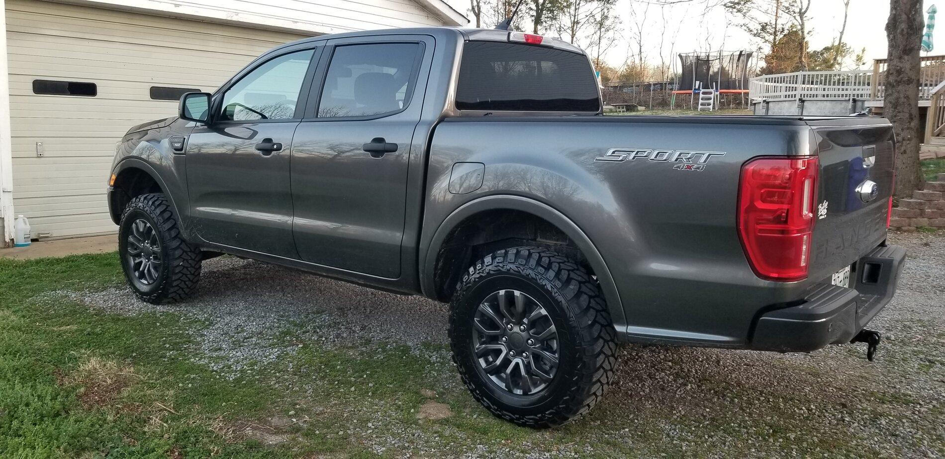

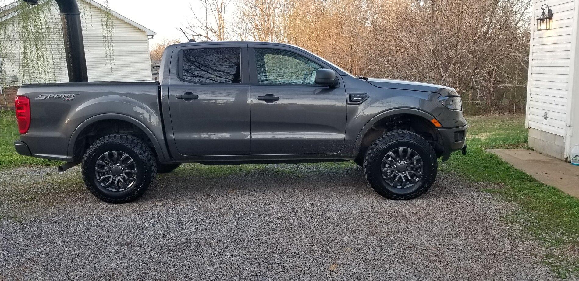

2.5 faction fab leveling kit , icon Vector 6 8.5 x 17 +25 offset Nitto terra grappler g2 265/70-17

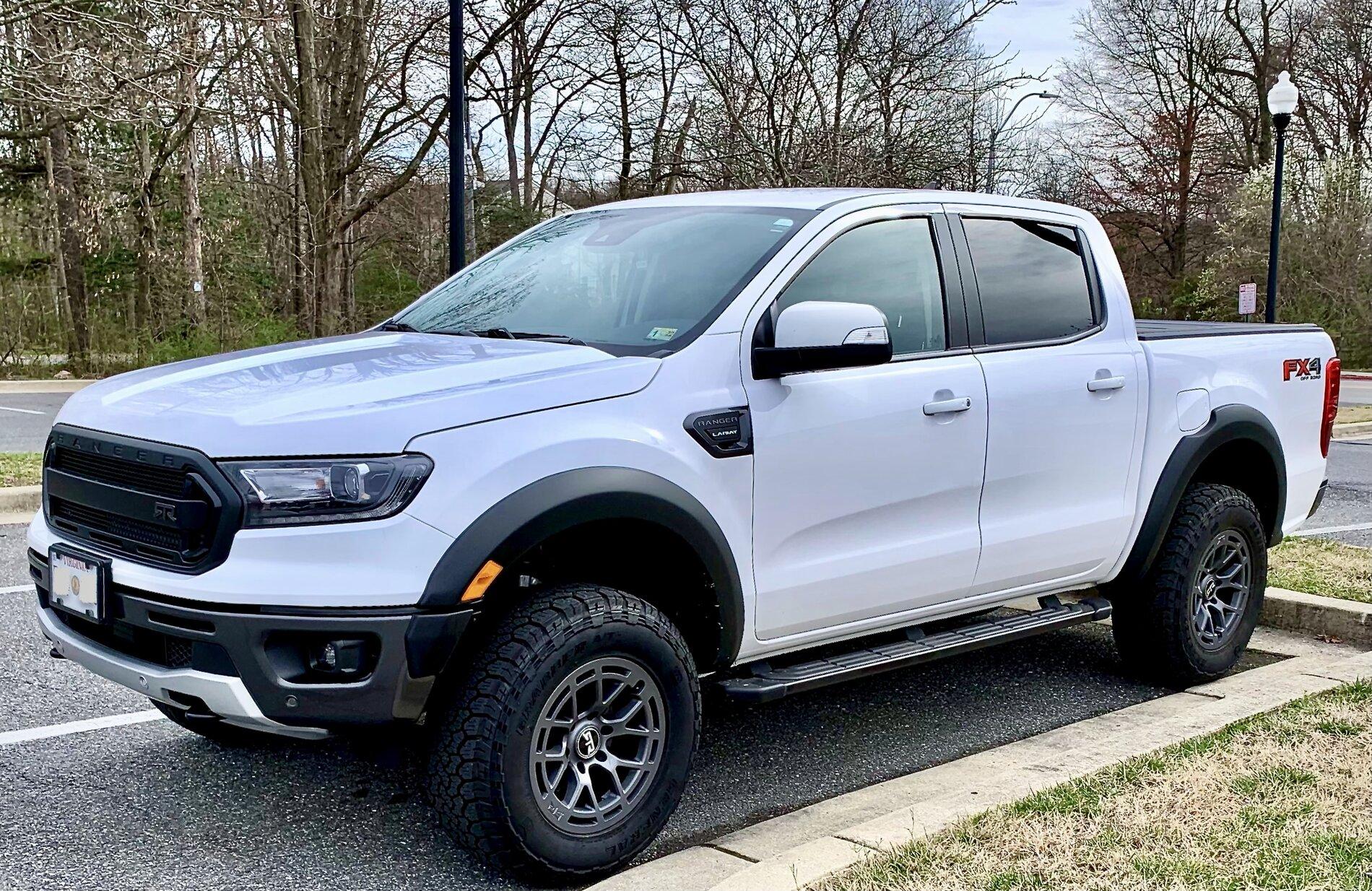

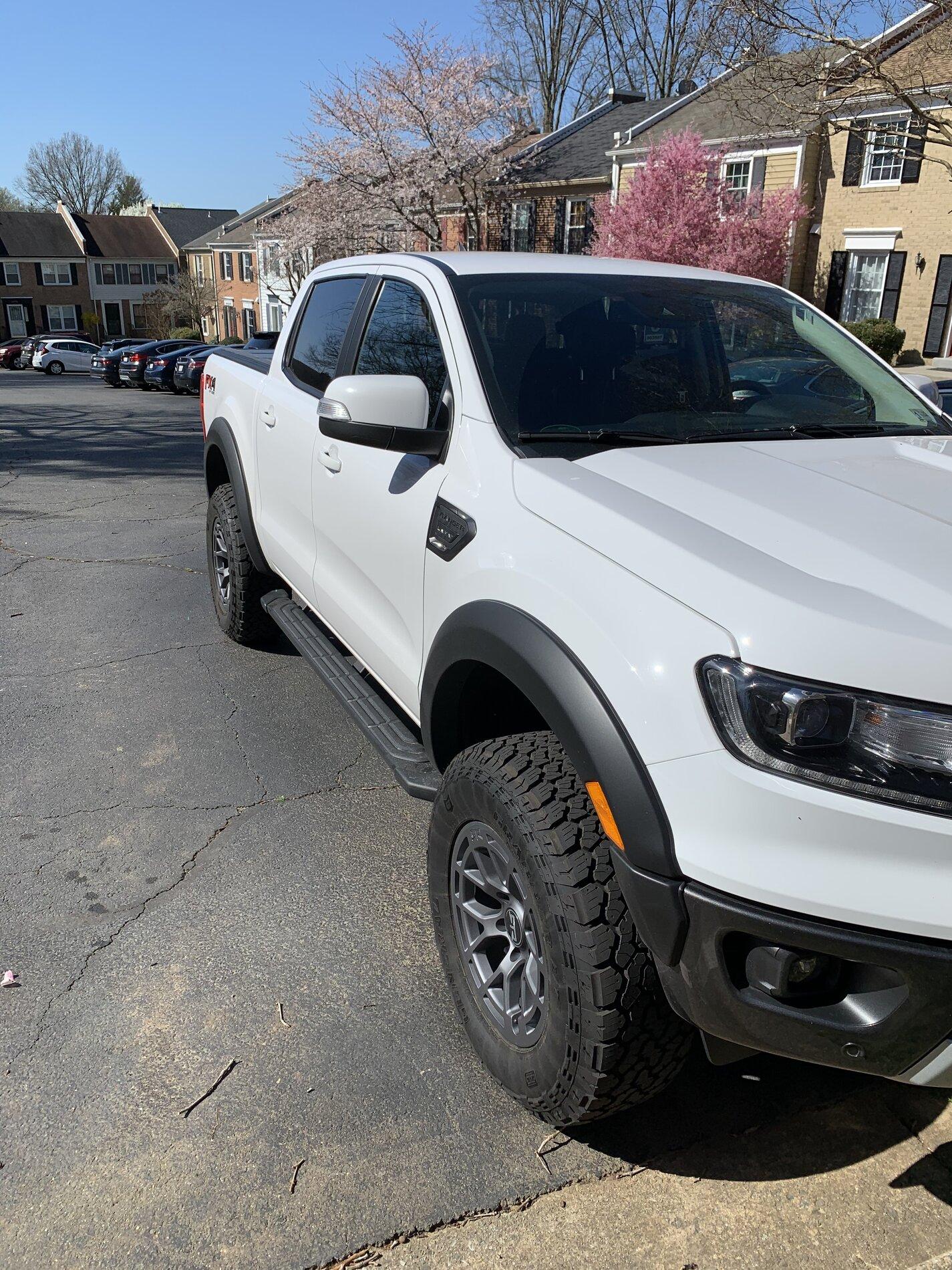

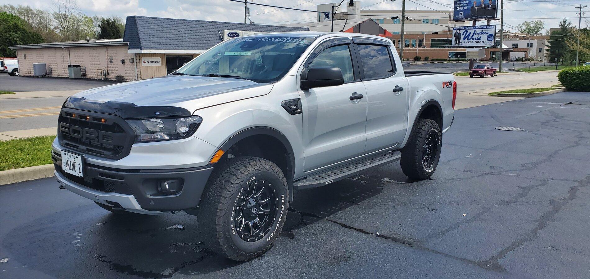

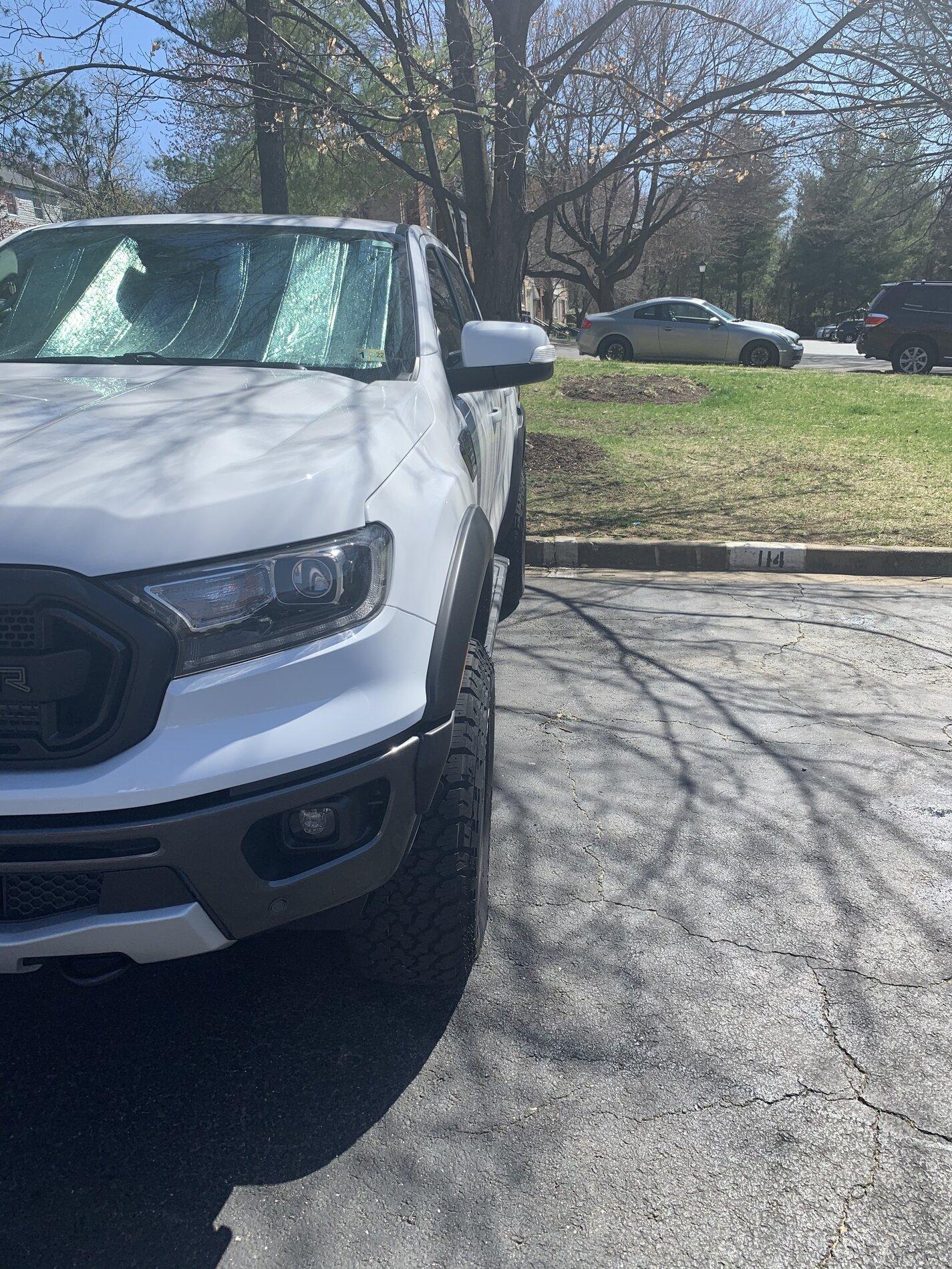

Ford Performance Fox 2.0 level kit with 265/70/R17 General GrabberATX no rubbing. Once I added the RTR rims in 0 offset and I did have slight rubbing, all I did was adjust the crash bars and I removed my air dam, no more rubbing. Drives great.

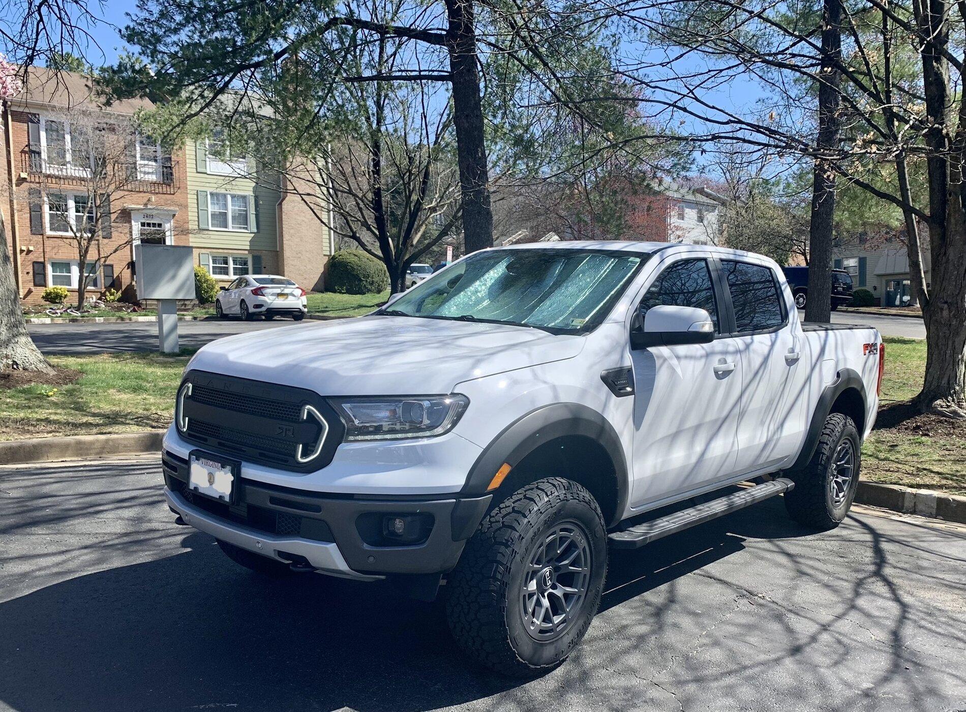

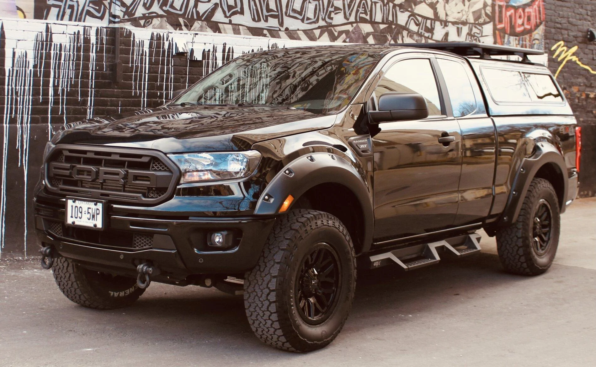

After my 2.5” RC level, I managed to squeeze in some 275/70/17 General Grabber ATXs on +15mm offset Menace wheels without rubbing.
Very close to crash bars, so swapping in some ReadyLIFTs just to make sure.
